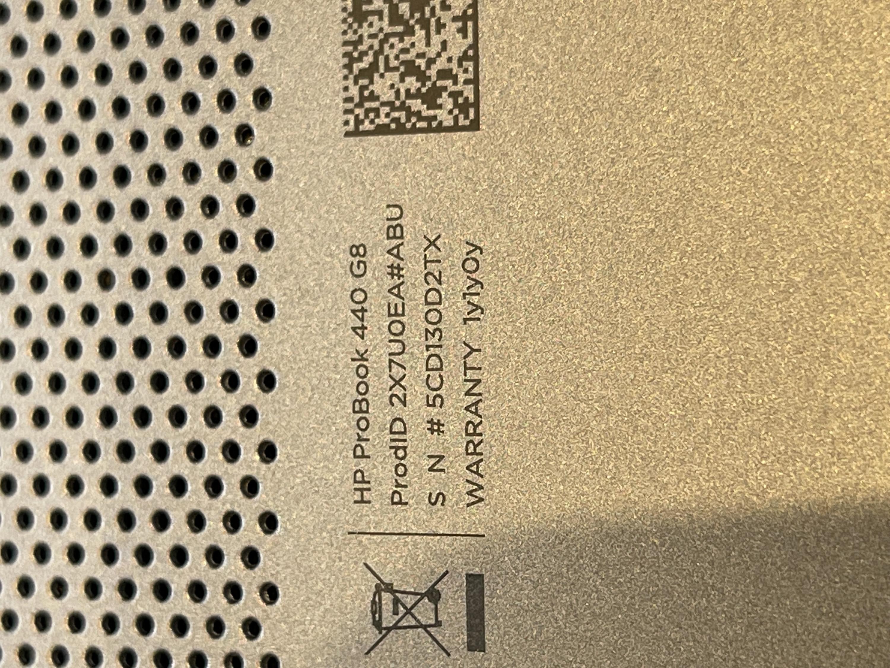

    Hi all , I have a prebook 400 g8 here with a supervisor password .
    Does anyone know how to get rid ? I can post dump if needed I haven't opened it up yet .
    Is this model a straight dump or require patches etc like the Lenovo ?
    Thx in advance

        Do you know what model the laptop is, is it a 448 G8 or a prebook 400 g8
        • ICBPass
          • Oct 2021
          • 4
          • United Kingdom
          Re: Probook 448 G8 SVP Password
          Its a 440 G8
