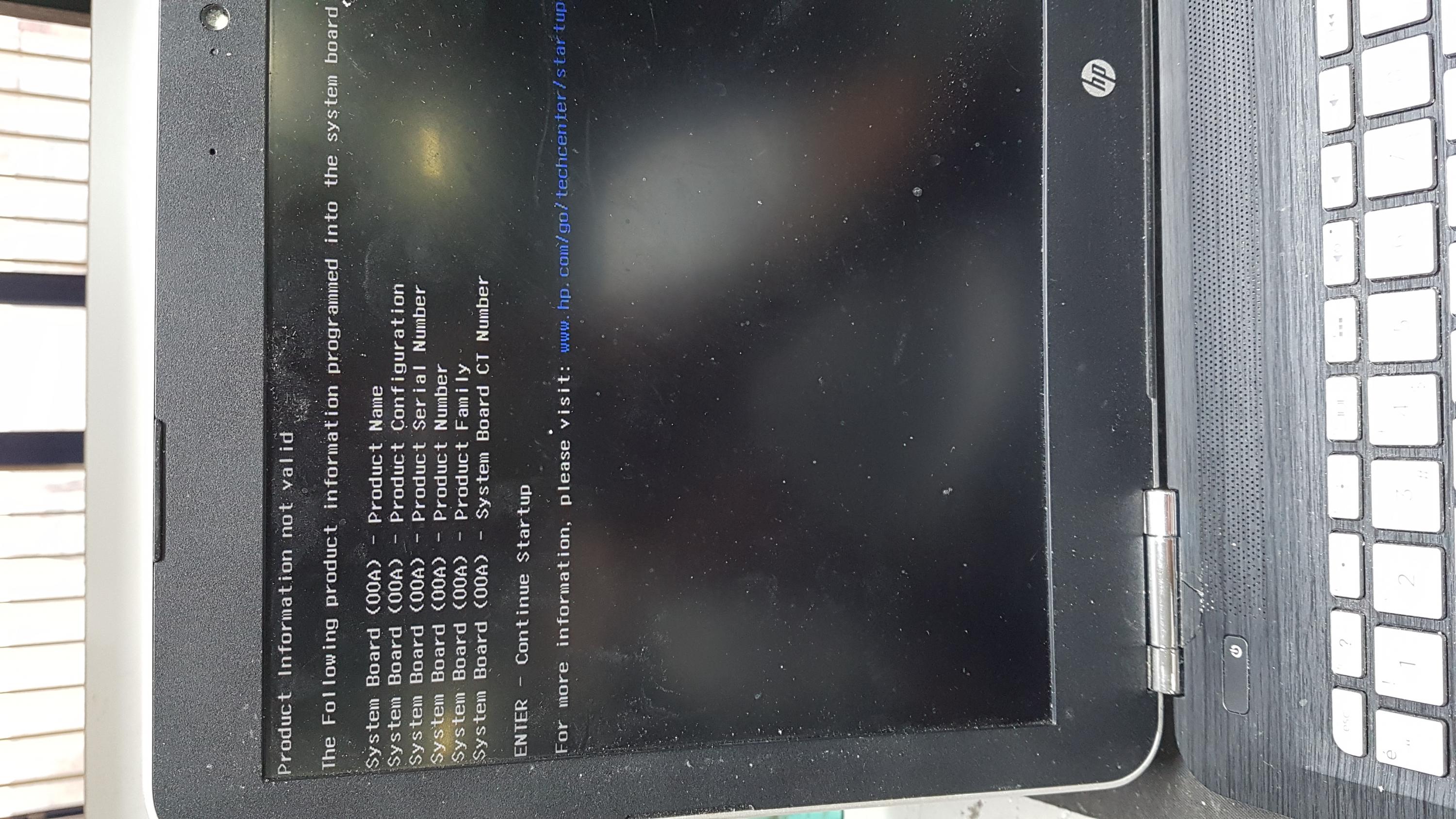

    Hi. my bios working but battary not charge
    BID0820D bios is writing and working or battary good charcing
    but error mesage or enter the continue...

      bios extracted from the HP site update, the laptop has three bios variants
      DMI 6AC000 - 6AE0FF
      KEYWIN 278000 - 27803F
      the DMI and KEYWIN (KEY WINDOWS) information from the original bios must be entered in the HP site extract, which is blank. Enter the original laptop bios in the HxD program, and the extract from the HP site corresponding to the bid. press the original bios.."edit" ... select block ... a window opens .. "start" 6AC000 ... 'end "6AE0FF ..and ok..click right on the region and" copy "... press bios extracted from site, and the same thing ... tick the same region and at the end "paste" .. the same procedure for KEYWIN success ..

        thank you sir. problem solved.
