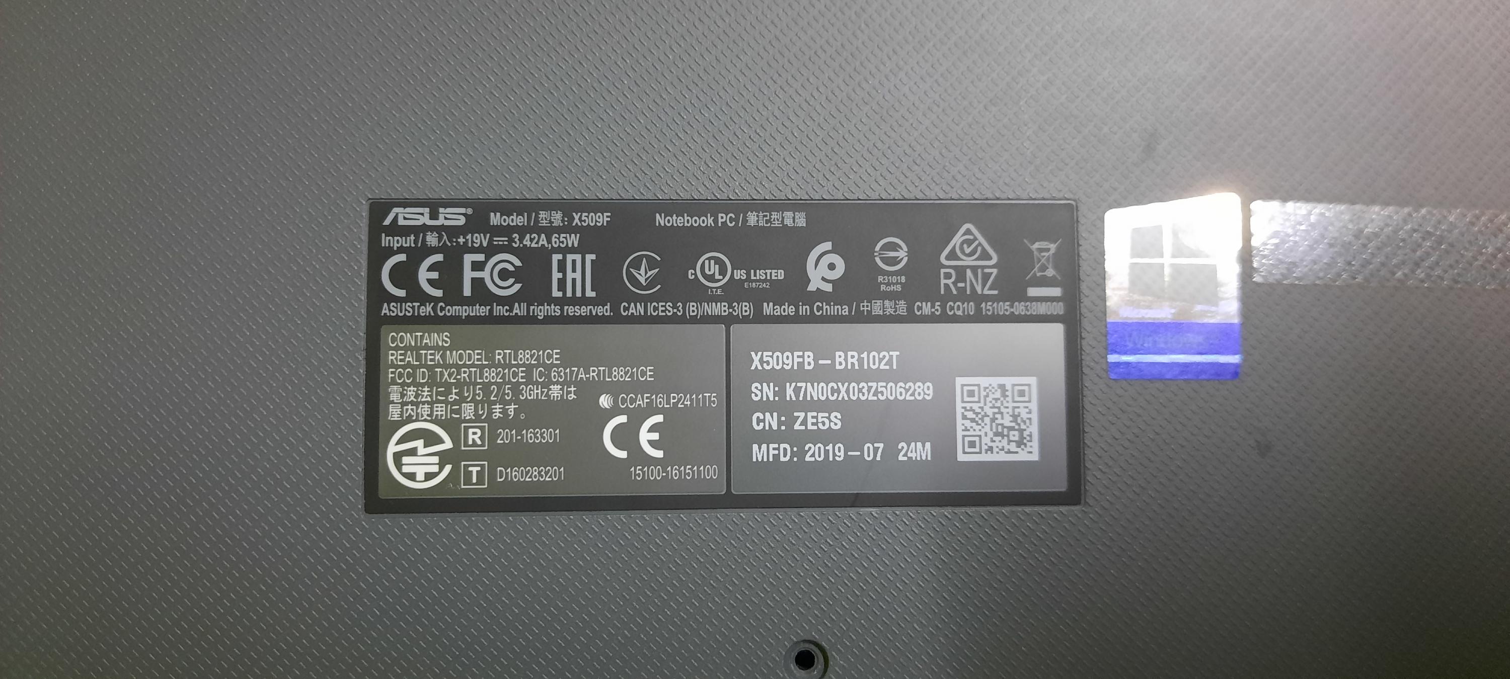

asus x509fb main:x409fb rev:2.0 bios request
  • umit
    • Dec 2015
    • 61
    • türkiye

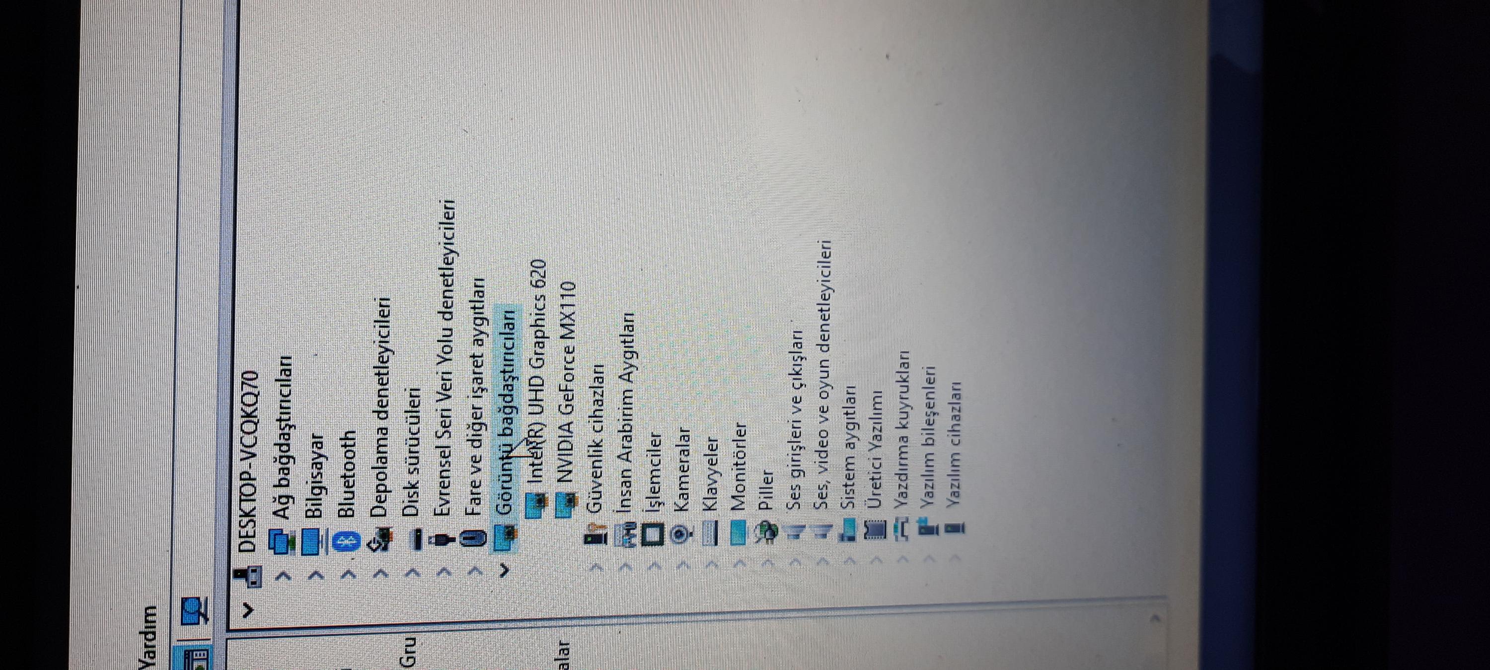

    asus x509fb main:x409fb rev:2.0 nvidia mx110 n16v-gmr1-s-a2 please help i need bios
    I tried many bios but it didn't recognize the video card
    need original bios please help

    Post your original bios backup,and a good readable picture of the motherboard sticker with the barcode or QR code on it.

        motherboard sticker ... "a good readable picture of the motherboard sticker with the barcode or QR code on it."

          Re: asus x509fb main:x409fb rev:2.0 bios request
          Okay

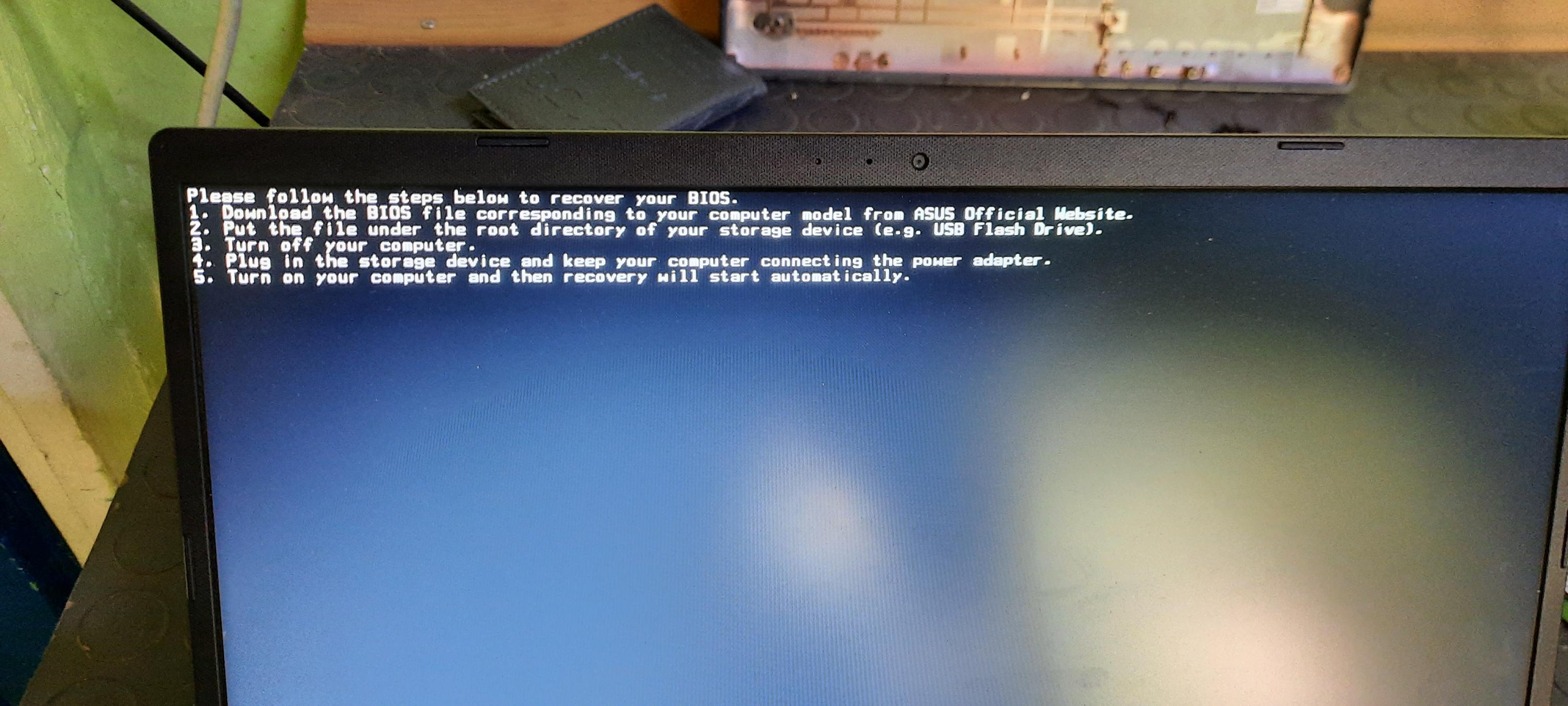

              try it .
                I did the instructions on the screen but it didn't work, what should I do?
                  I merged the x509fb update with your bios but forgot to clean the ME region.Try the new bios attached at post #7 .If it doesn`t work i`ll merge the x409fb update for you to try, its not clear which version the laptop came with as there`s no stickers on the board with the model number,only a silkscreen with x409fb.
                    I am waiting for the new bios you will add, thank you very much
                      Removed the bios at post #7 ,wrong one posted. Here`s the new one to try
                        Thank you very much, I am very grateful, thank you very much for your help

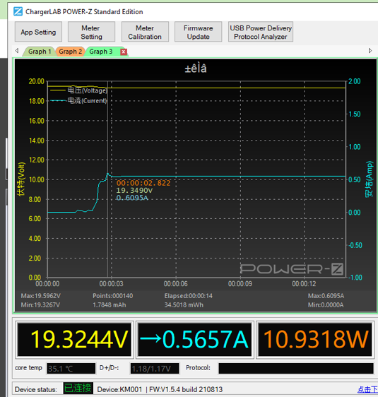

                            x409fb bios
                            turn on, consum 500ma no video, ram ok.

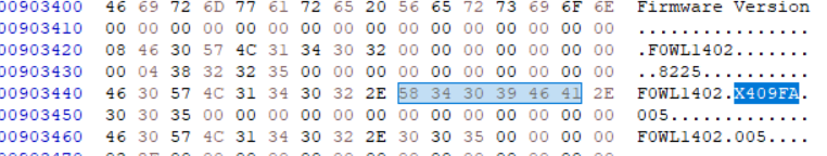

                                      or help me clean for this bios for
                                      ASUS X409FB REV:2.0
                                      thanks.....^_~
                                      Is this your original bios ? I see model X409FA not X409FB.
