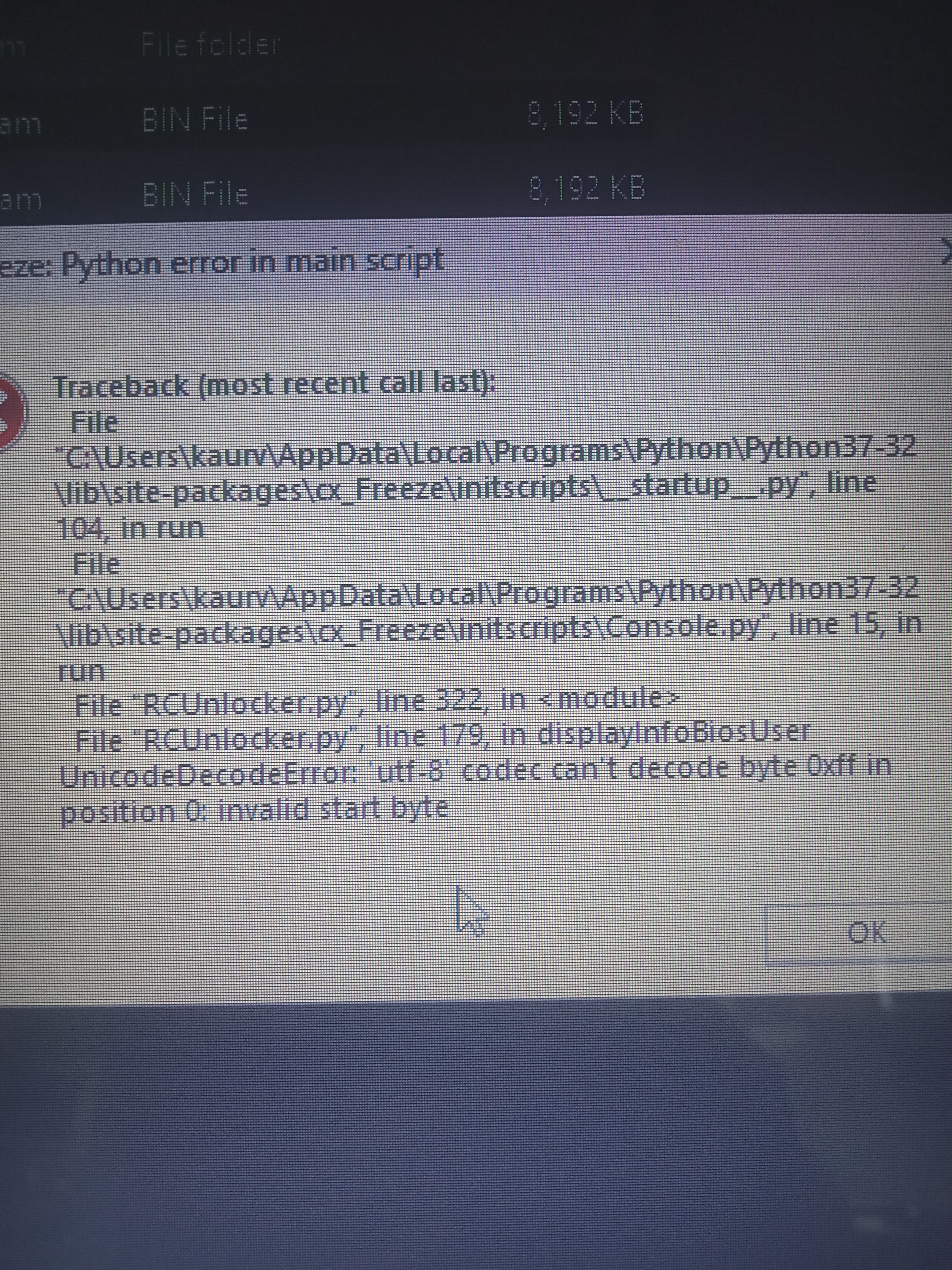

            I need help in using the Unlocker with HP 8560p (maybe a bit older) bios , it returned an error cx_Freeze:Python error in main script.. My OS is Windows 11 Home SL.. though it still produce an unlocked file..will it work ?
            • peste
              • Dec 2016
              • 12967
              • ROMANIA
              #1206
              try it like this..

                                      #1218
                                      hello everyone. I used the program but I couldn't do it. Can you help me remove my password?
                                      EliteBook 850 G2
                                      SN: 5CG6031CFQ
                                      PN: H9W21EA#ABD
                                      • peste
                                        • Dec 2016
                                        • 12967
                                        • ROMANIA
                                        #1219
                                        EliteBook 850 G2
                                        SN: 5CG6031CFQ
                                        PN: H9W21EA#ABD
                                        The bios posted is blank, it's normal that you couldn't do anything.
                                        The bios chip must be unsoldered from the board before writing or reading..
                                        do not use the clip, you may have errors..if you do not have anything to unsolder it with,
                                        solder wires between the programmer and the bios chip..
                                        here is a video for example..https://www.youtube.com/watch?v=DWWi...nnel=ThisIsHow
