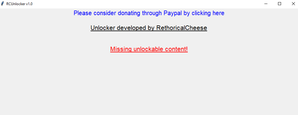

                      • acordeonphx
                        • Sep 2023
                        #1131
                        Hi, I am getting 'Missing Unlockable Content' when running RCUnlocker
                        HP ProBook x360 11 G5 EE
                        SN: TCDBGZWMA50OOI
                        MB ID: 6043B0273911 Rev: A01
                        Could not find support for w25q128jwpq in any programmer so used w25q128fw_1.8v.

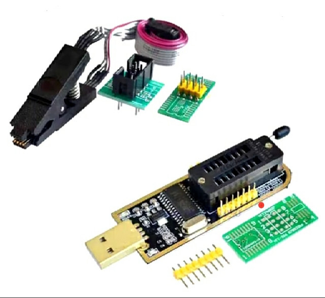

                              • Troystain
                                • Nov 2024
                                • 10
                                • Philippines
                                #1135
                                Originally posted by peste
                                you need an SPI programmer..here is a video as an example...https://www.youtube.com/watch?v=DWWigscuQDY
                                I just want to ask if is it fine to read/dump bios without removing the bios from the motherboard? Like resoldering pinouts using jumper(magnetic) wire to programmer.
                                I am planning to reset or remove the bios admin password of HP 640 G9. The bios chip of this laptop is flat unlike other units that has spider pins and this I my first time repairing hp elitebooks bios.
                                I hope someone provided me a clear answer, I also would like to know what programmer is compatible for hp elitebook 640 G9 to read&write?
                                • peste
                                  • Dec 2016
                                  • 12973
                                  • ROMANIA
                                  #1136
                                  the best thing is to remove the chip from the board, remove it with a blower, there are adapters for these chips, search in the software database and see which ones accept this chip..
                                  • Troystain
                                    • Nov 2024
                                    • 10
                                    • Philippines
                                    #1137
                                    These are the only thing I have look at the image.
                                    That's why I'd ask if jumpering the pinouts directly will be also work? I'm afraid to damage the BIOS chip if I overheated the chip with hotair workingstation/blower. We are far from suppliers and other technicians if I damage the chip I can't find a replacement.
