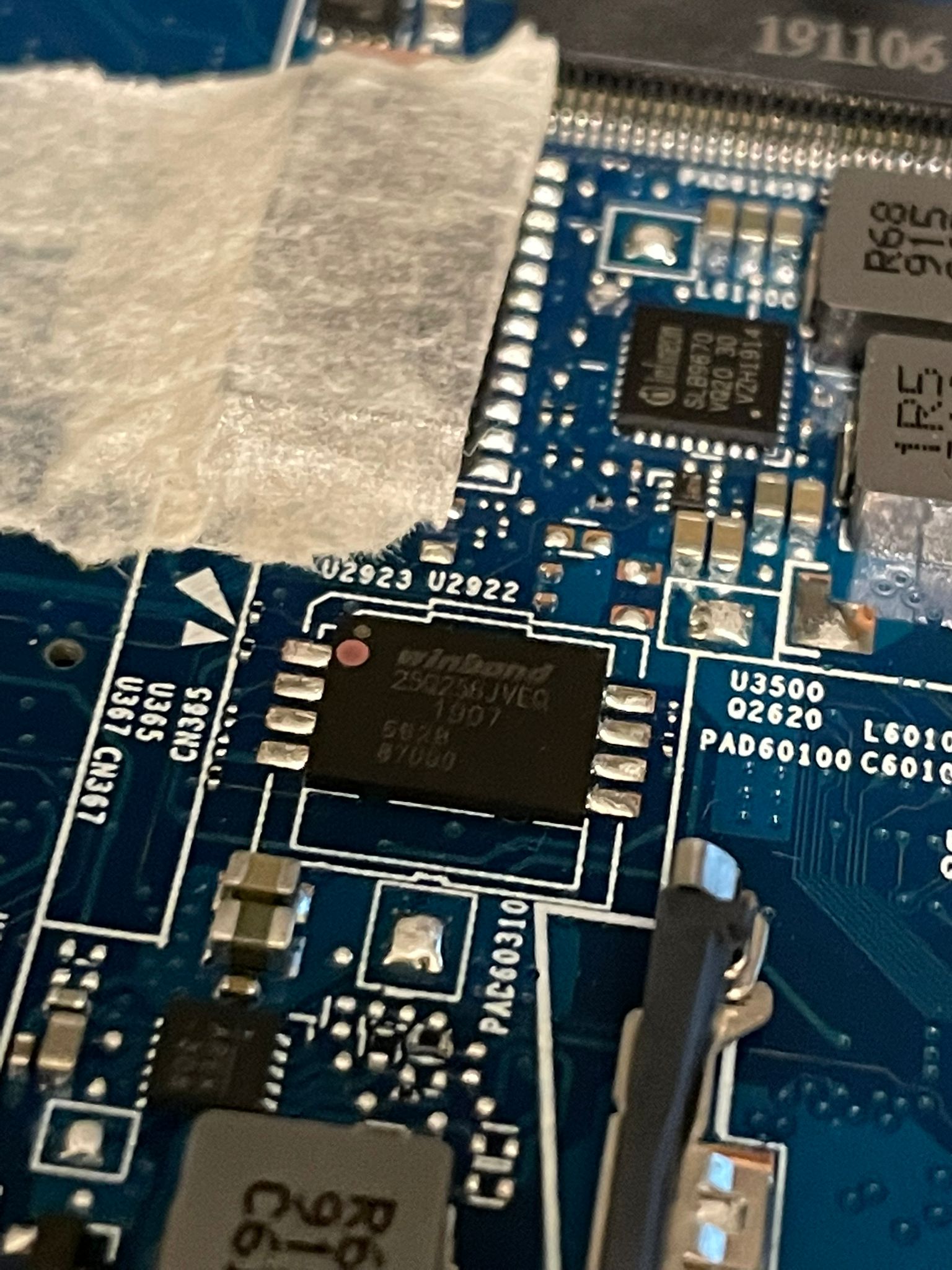

      I have Elitebook 850 G6 with 32 MB chip read , but the unlocker says Wrong Chip.
      Is it supposed the password to be stored here on this W25Q256JVEN or on another chip?
      Please can somebody help me ?

        Seems the readout was not done properly without desoldering the chip, anyway I would like to know how to proceed with 32MB when I desolder and read it ...

          #84
          Re: RCUnlocker
          So if it says wrong chip, try another chip. 16MB is the one you need.
          But it's always good to make backup of the 32MB chip just in case.

            #85
            Re: RCUnlocker
            I don't find any other relevant chip, maybe I am blind, or it is located on the other side of the board?
            I desoldered the chip now and the contents of the readout is exactly the same like attached

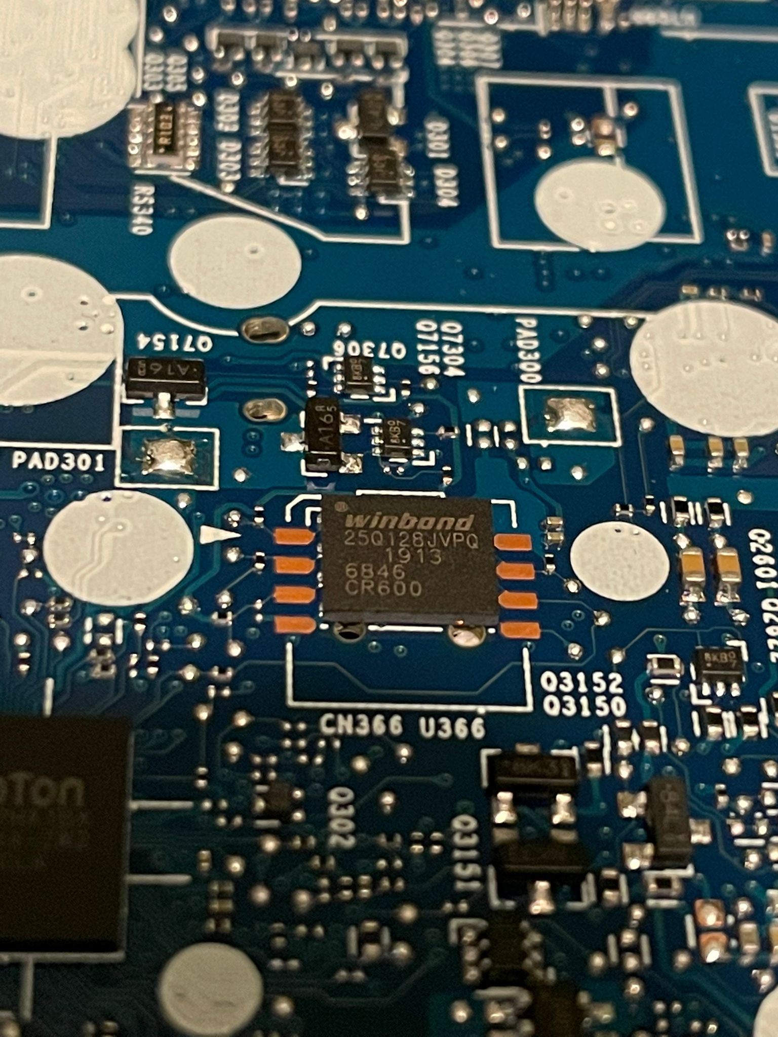

              #86
              Re: RCUnlocker
              This is the 16 MB chip winbond on the other side of the board
              Unlocked this one with your unlocker, but only the Fingerprint is gone, but still asks for administrator password?

                #87
                Re: RCUnlocker
                Your 32MB file seems broken to me. I am not sure why your password was not removed but maybe you are still having issues with your programmer.

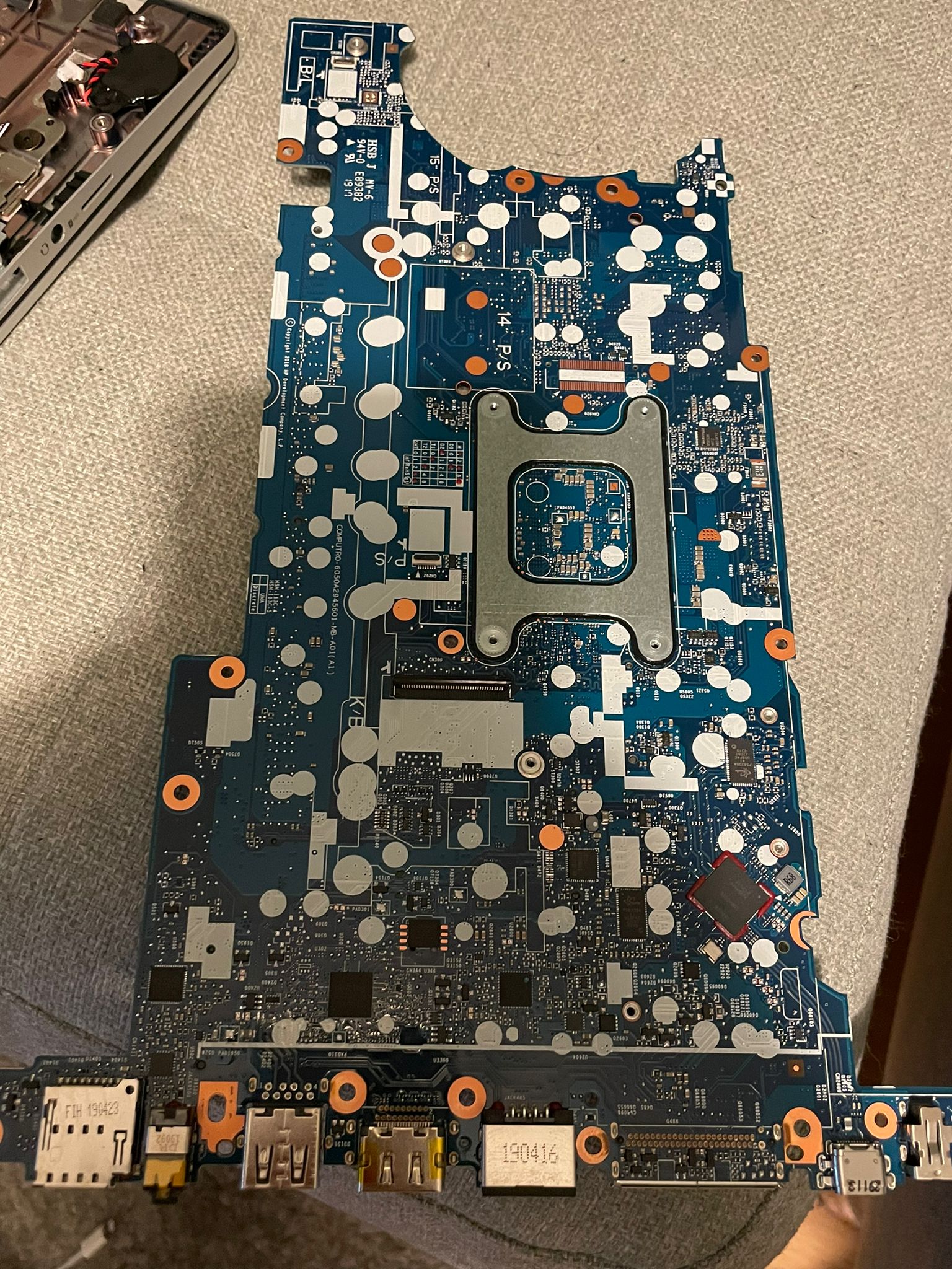

                                  Re: RCUnlocker
                                  Hello friends I would like to know how to dump the bios without desoldering winbond 25Q256jvEQ
                                  Sorry for my English I use Google translation
                                  HP EliteBook 840 G5 Notebook PC

                                    Re: RCUnlocker
                                    worked fine with hp 840 g6 . just drag the 16mb not the 32mb

                                        #99
                                        Re: RCUnlocker
                                        You need to dump 25Q128JVPQ chip only. Buy hot air station and WSON8 adapter to do the job as it should be done. Or use tiny wires and solder them to the eight square contact surfaces around the chip. Again use tiny wires, because otherwise you will tear down the contact surfaces off the motherboard pretty easily.
