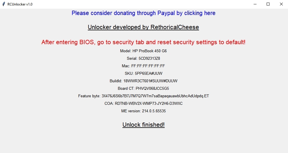

              #986
              hey
              been using the tool for some years, but on my new computer i only get pyhton script error, really no matter what i do ..
              attached the dump if someone could patch it for me? Probook 450 G6,
              regards
            • deeptenk
              • Sep 2023
              • 10
              • Belarus
              #987
              Originally posted by mumserik
              hey
              regards
              No problem
