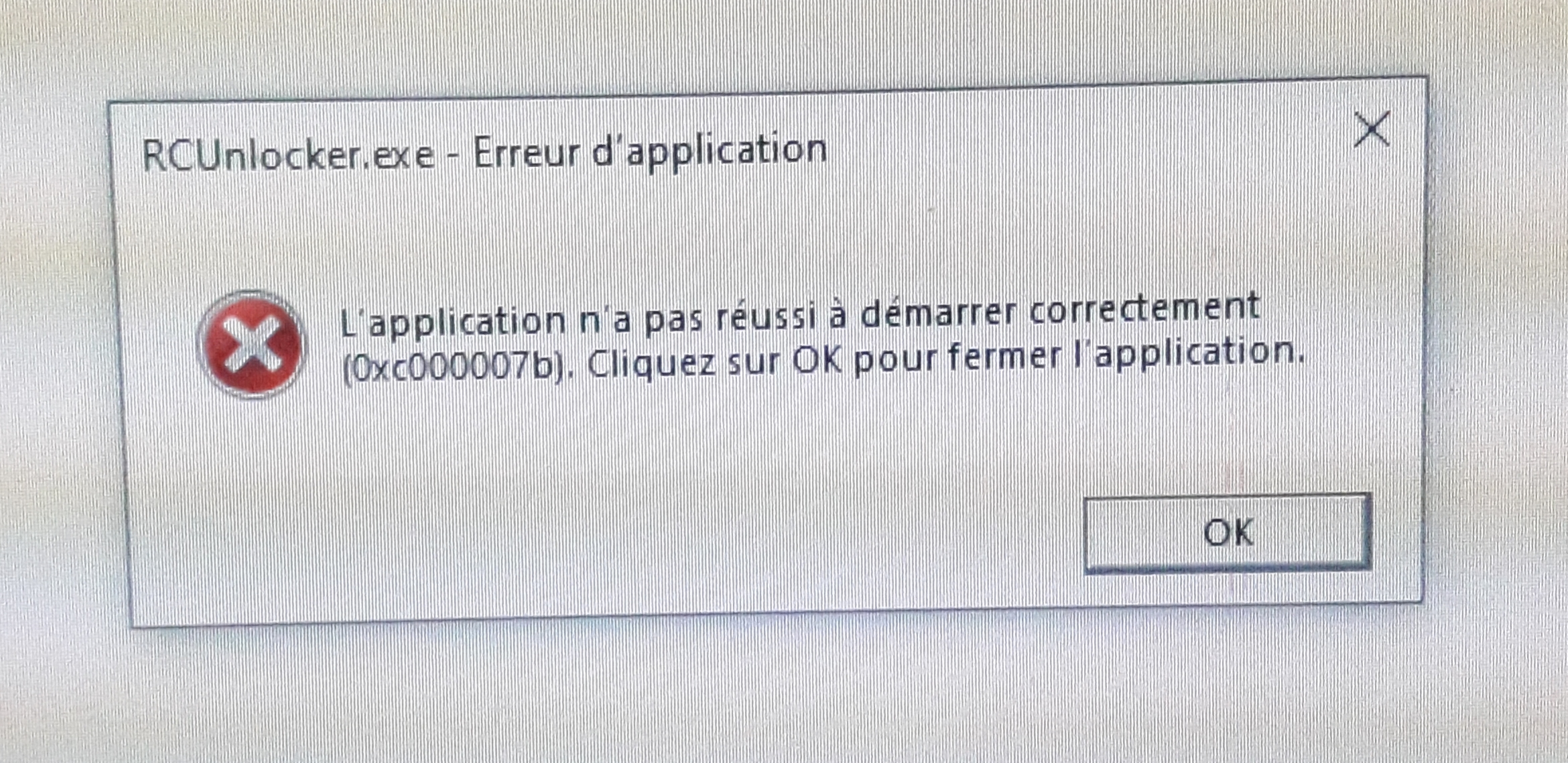

                                  Hello my friends...my Rcunlocker don t work ...any idea what s wrong..thank you
