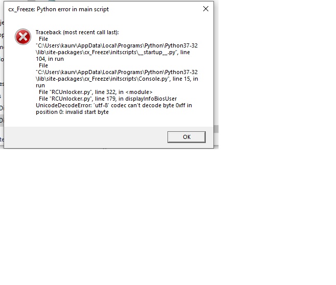

                Re: RCUnlocker
                Is this tool paid?
                I downloaded it to test on an HP ZBook 15 G3 Mobile Workstation APW5U LA-C401P with PASSWORD, but it doesn't show anything but 3 messages.
                Please consider donating through Paypal by clicking here
                Unlocker developed by RethoricalCheese
                Missing file destination argument!
                  • 21389
                  #868
                  Re: RCUnlocker
                  Originally posted by sandroironman
                  Is this tool paid?
                  Its free. Usage: Drag and drop .bin file to .exe file.
