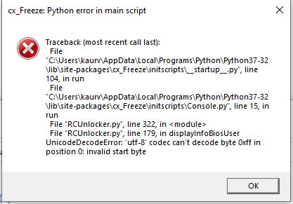

    Thanks for the quick reply. So just so I'm clear your saying to write this file to bios and it should be good?
    I thought I read that I should read multiple times and make sure that the are all same size ect.
    Is it normal to read the chip and verify bin then when I go to read it again its empty? Sorry if these questions are obvious, I'm just trying to fully understand. Thanks again
    Also im getting this error when opening the bin i pulled with rcunlocker.
      it should not be empty when you read it...use the HxD program..
      with this model it is ok... don't take the window into account..

                  #768
                  Re: RCUnlocker
                  I apologize. I'm just stuck and don't know what my options are. Can you verify that the dump I uploaded is or is not complete? thanks
                  There is no need to do it, since Peste has worked on the file I am absolutely sure that everything is fine. He is one of the people here who have certainly proven his professionalism many times. To say the least.
