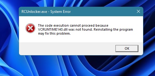

                                        #379
                                        Re: RCUnlocker
                                        plz what can be the problem
                                        • hoaca388
                                          Badcaps
                                          • Jan 2022
                                          • 11686
                                          #380
                                          Re: RCUnlocker
                                          VCRUNTIME140.dll file lost. reinstall it.
