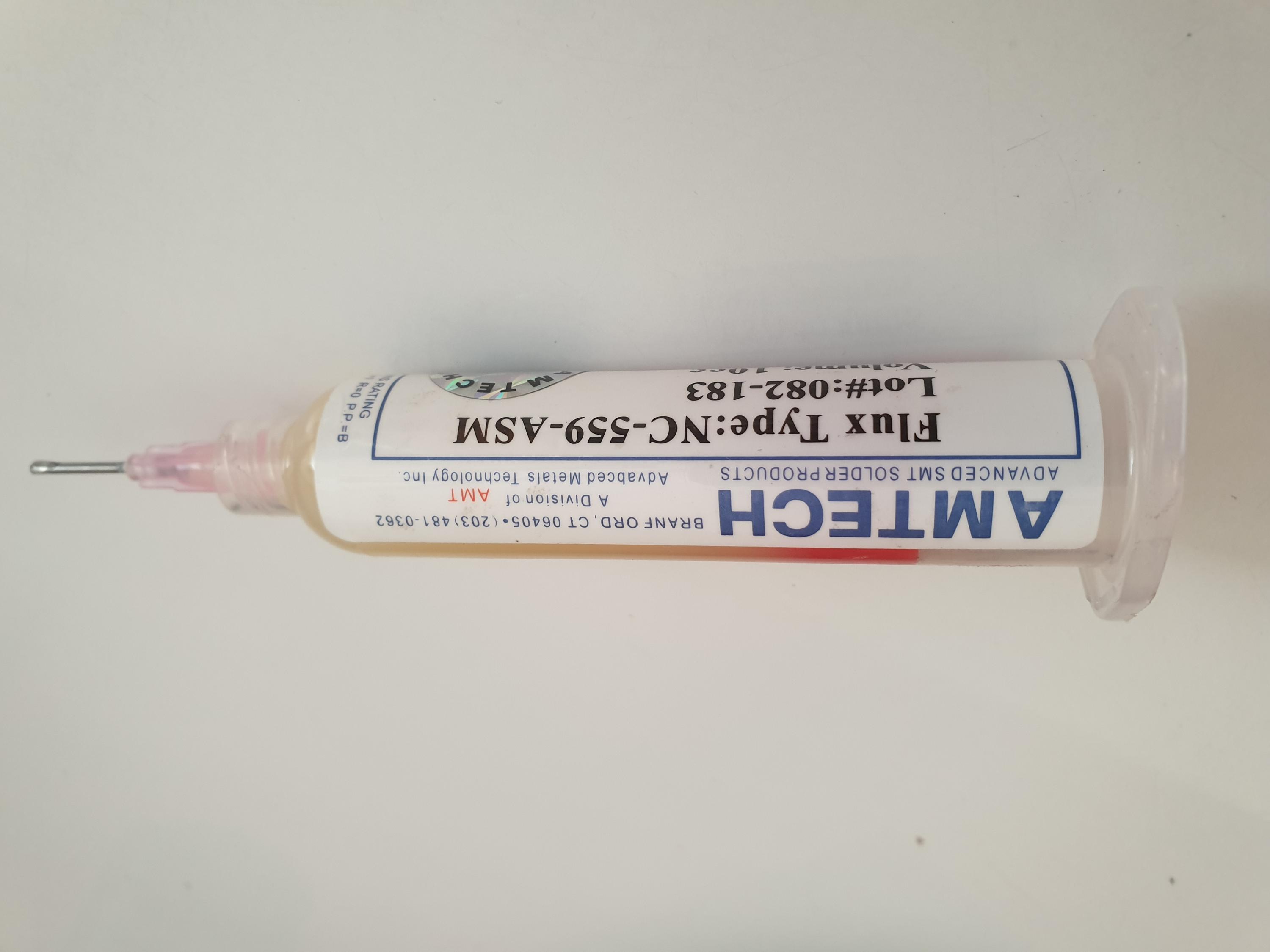

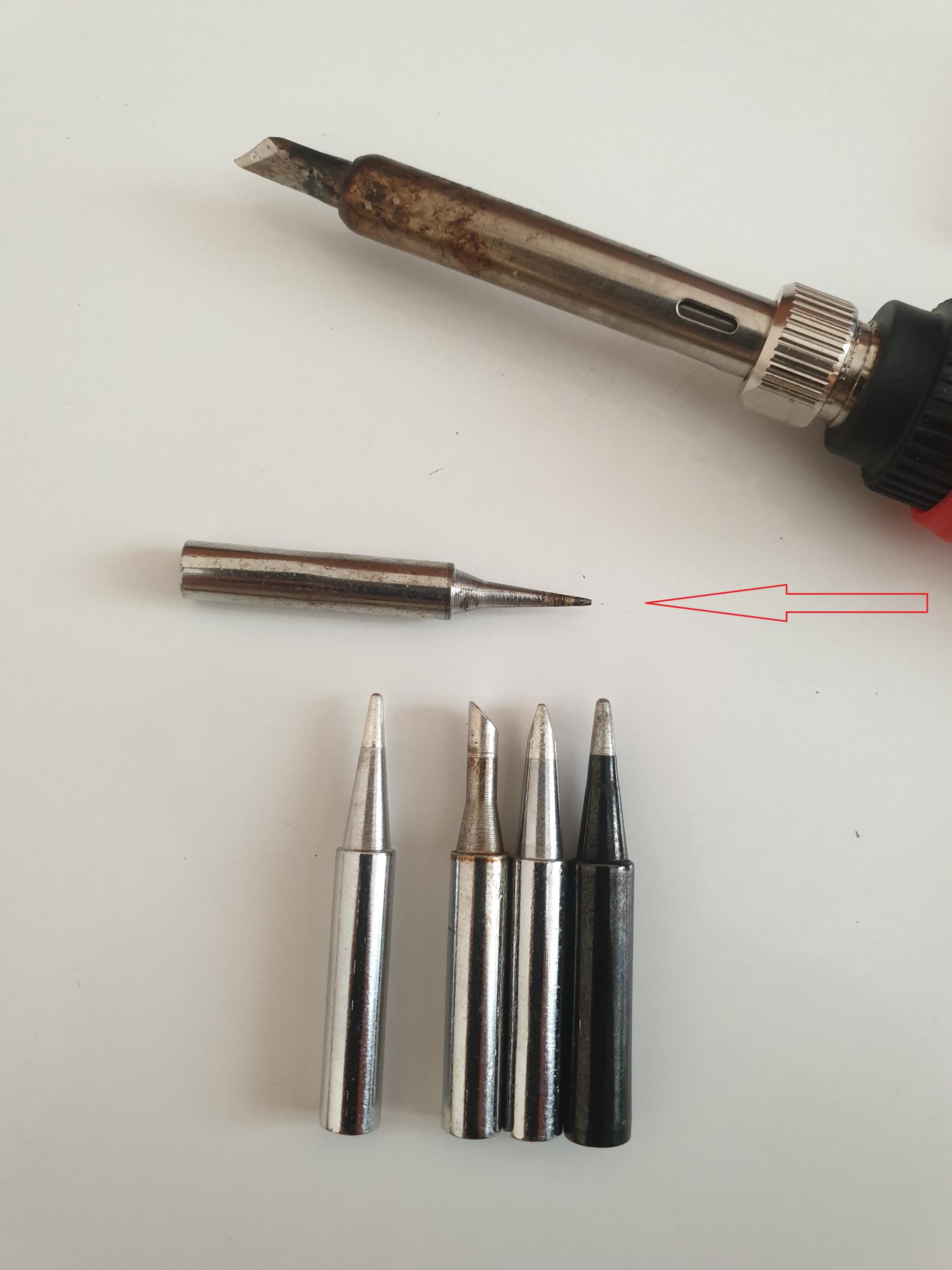

                        • hoaca388
                          Badcaps
                          • Jan 2022
                          • 11373
                          • Viet Nam
                          #272
                          Re: RCUnlocker
                          Originally posted by slightly_delayed
                          Hi, didn't work out....
                          Shaky hands, clumsy soldering iron, narrow space...
                          Don't get fooled by the pic/image in post #259 - no "big copper"-spots, about 2cm2 with tiny space between prone to soldering shortcuts (easy- and frequently)...
                          I'm again looking for other solutions/approaches....
                          Sigh....
                          You need a smaller tip soldering iron and a flux type.
                          • slightly_delayed
                            • Nov 2021
                            • 11
                            • NL
                            #273
                            Re: RCUnlocker
                            Originally posted by RethoricalCheese
                            Those are huge. You just need experience and better tools it seems.
                            and
                            Thx RethoricalCheese and hoaca388
                            You're both right. Your advice is most welcome....
                            I'll try to use the copper-pads directly without soldering, have to cut the black top plastics from a SOIC8-clip, hopefully the pins' distances will be ok..
                            Will report back...
