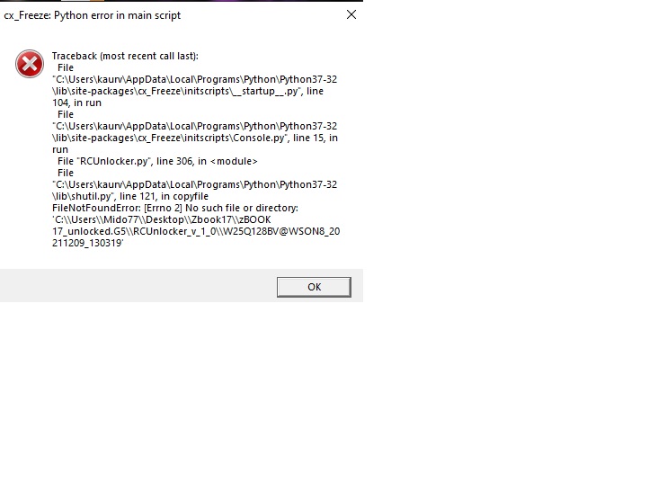

                #187
                issue with RCUnlocker
                hi sir
                i got this image from a friend in a discord server askinng me to help and as you're the developer of RCUnlocker i thought of sharing this with you maybe you got an answer, thank you
                sorry to disturb with this, just ignore this message if you have no time for it

                  #188
                  Re: RCUnlocker
                  maybe he should try renaming his files and folders in a proper way.
                  filename.bin not filename.somethingelse.bin. or foldername not foldername.somethingelse
