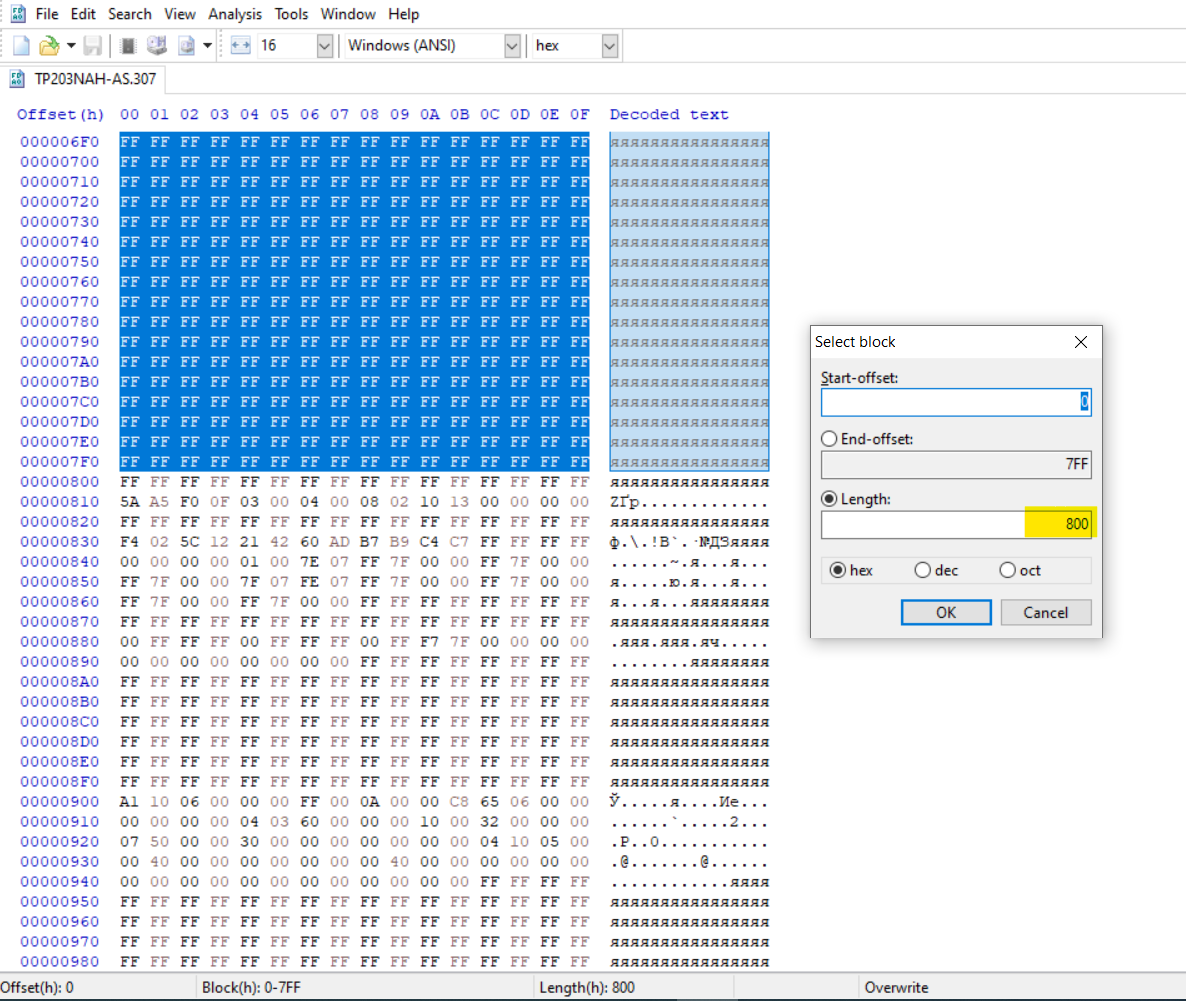

pls help me I need dump Asus TP203NAH-BP046T bios
asus TP203NAH-BP046T

Re: asus TP203NAH-BP046T
https://www.asus.com/supportonly/TP2...HelpDesk_BIOS/
Newest BIOS is Version 307, download ---> extract ---> cut (delete) block 0 - 7FF or select start-offset: 0 and length: 800 ---> save the rest of the file as *.bin and you'll have a bios file.Attached Filesif you find these attachements useful please consider making a small donation to the site
