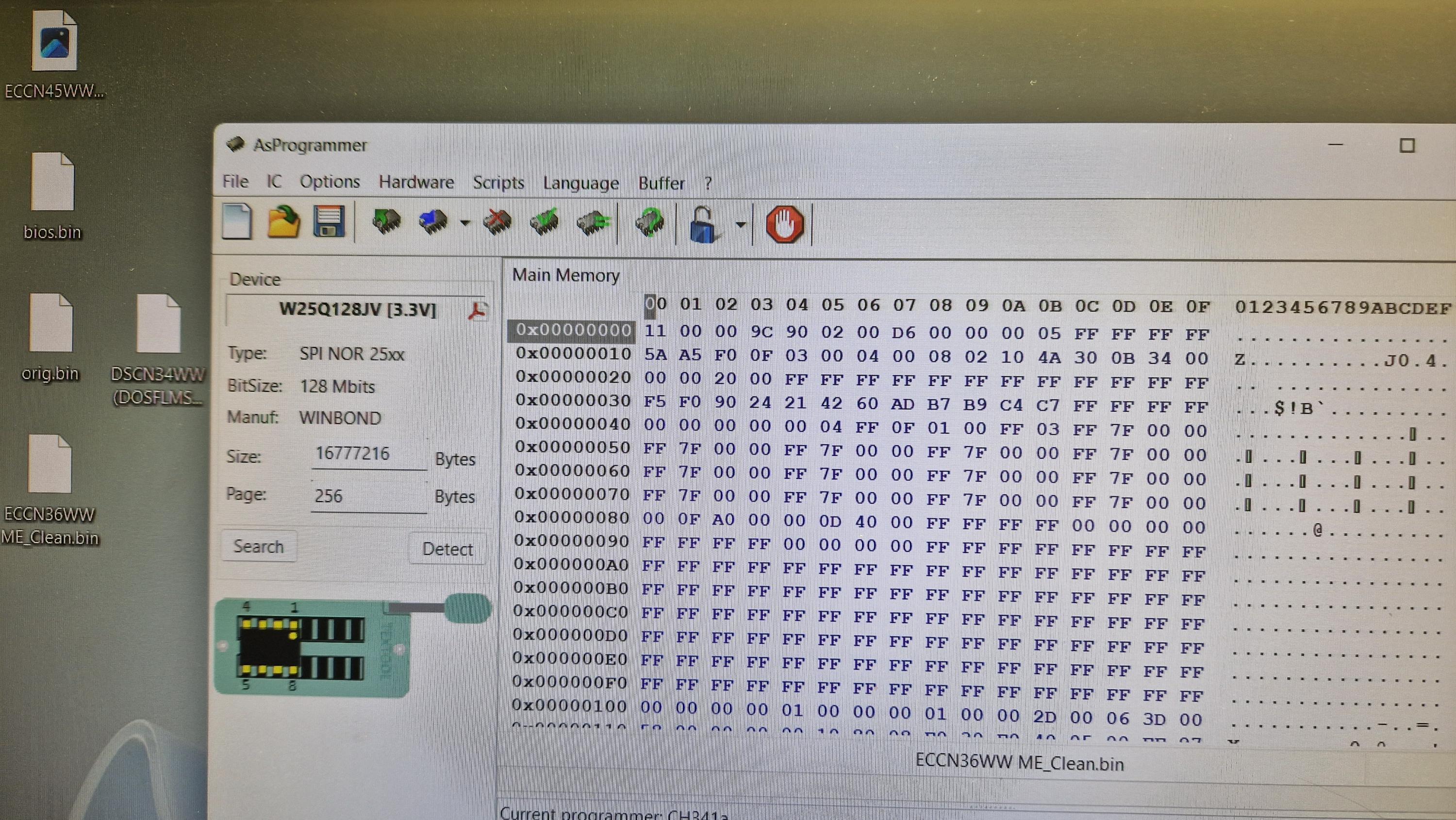

          I read the file with CH341a and the issue is identical as the first post.Blinking led with short fan spin and no boot.It's a Lenovo 15-14IIL05 (R90ZTFQ0) 81X1.I have attached the original dump if anyone can help....

            Re: Lenovo ideapad 5-14IIL05 BIOS bin
            You need the bios attached at post #10, use the information about the DMI and Windows key offsets at the attached txt file to transfer them from your dump to the new one.

              #106
              Thank you i will give it a shot and see if i don't mess something up as usual

                #107
                There's nothing to mess up - you have all the information you need, it's quite an easy task. If you doubt something, you can ask here.

                  #108
                  Yes indeed you are correct and very very helpful.I apreciate you for taking the time with noobs like me and i can confirm it was a succesful operation (without me messing something simple as usual )
