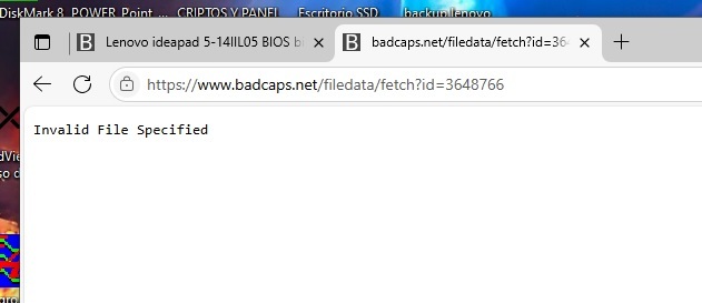

                        #191
                        Originally posted by peste
                        you have everything you need at post #13..
                        https://www.badcaps.net/forum/troubl...5c#post3648765
                        Sir, thank you for responding. But there is a problem with post #13. The link is broken. Could you help me?
                        • m1ch43lzm
                          • Mar 2019
                          • 636
                          • Peru
                          #192
                          Try post 7
                          https://www.badcaps.net/forum/troubl...23#post1568823
                          Use the file named DSCN34WW (DOSFLMS0)
                          Copy those ranges with hex editor from your BIOS to the "new" BIOS
                          DMI 520000-5220FF
                          Win key 596000-59803F
