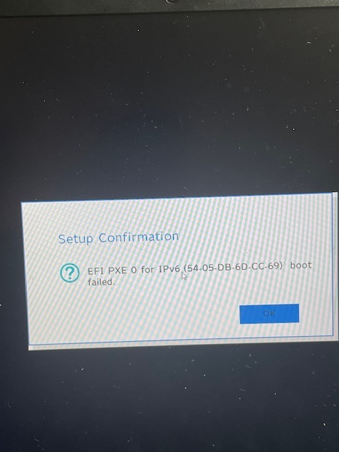

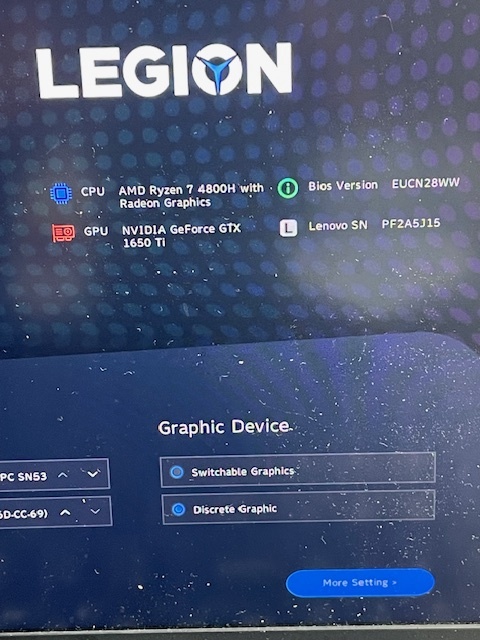

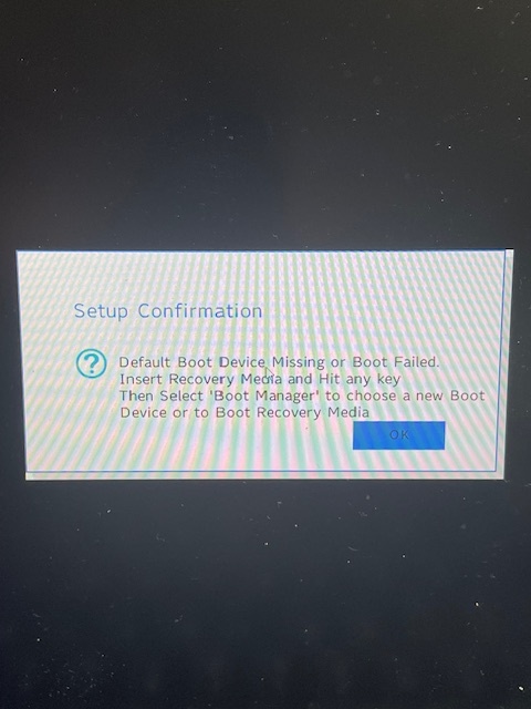

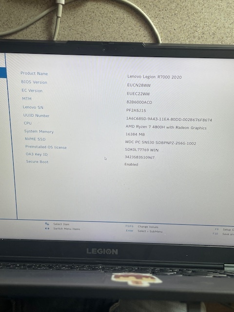

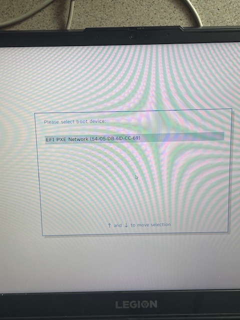

          Re: Legion 5 15ARH05 bios
          Ah thanks for that! I've managed to get the Serial number to show up in the BIOS.
          Now the next problem, I don't seem to be able to access any Boot devices. I'm new to all this and I've been trying to find similar threads but no luck.
          The laptop seems to take about 10 seconds from turning on to finally show the Legion logo and allow me to press F1 to enter the BIOS. Once in I can't get it to see the onboard hard drive or a USB drive with Hiren
