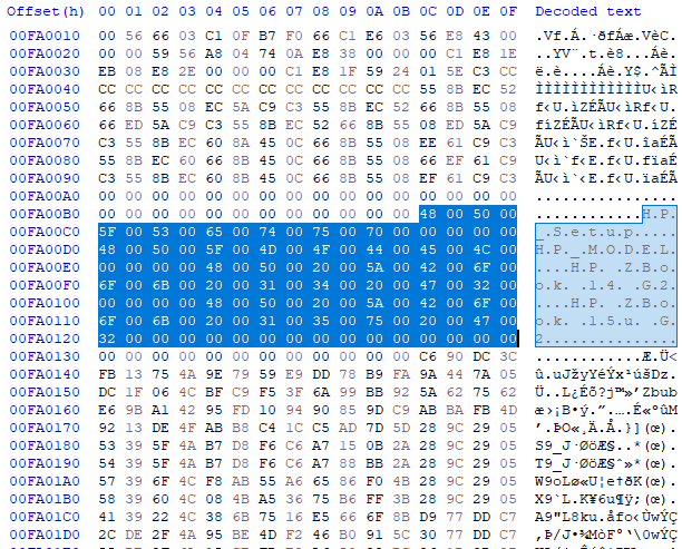

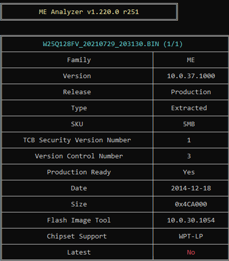

      It would be interesting to hear details such as the version of the Fit used.
      By default, Fit 11 should not work with your dump.
      Not to mention that this dump is for ZBook 14 G2, and you said you were testing on 840 G2.
      It will be interesting to see this Frankenstein dump, upload the resulting file here.

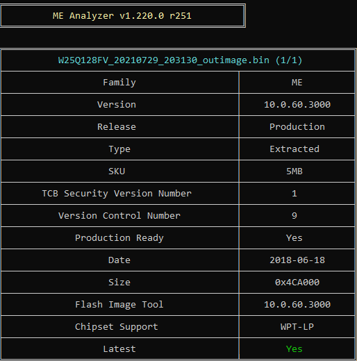

      Here is your cleaned file (Intel ME Firmware v10.0.60.3000 5MB) for testing.

        hi Vesko356, i have uploded what i used which was 11.10 but i am glad you have given me a clean me as i noticed that my one when it was downloading updates laptop would shut down completely, so i had to come back to this thread and use your one which is working perfectly
