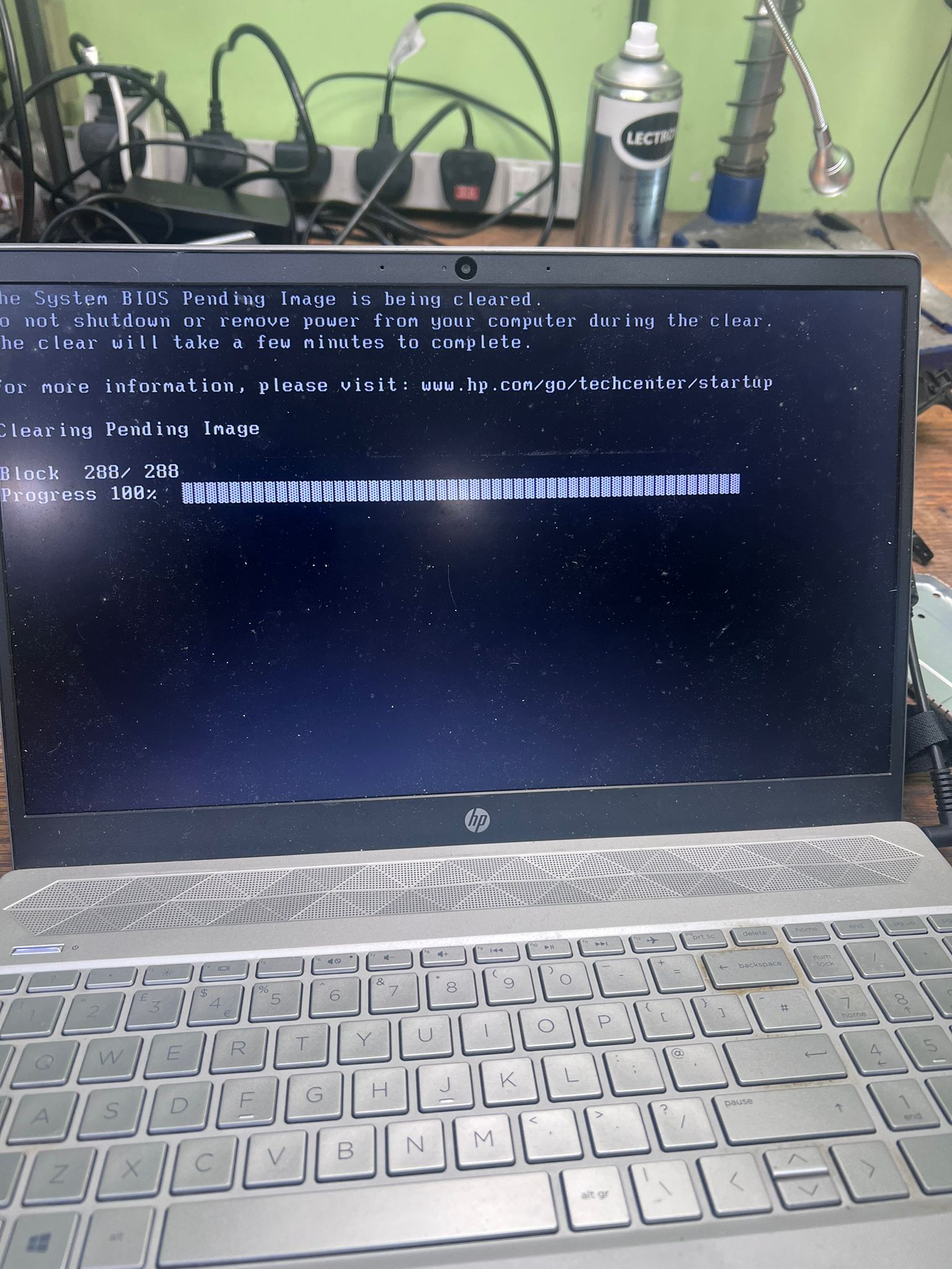

              After programming various bin files the computer behaves like that for just one time

                Re: Bios Bin Hp Pavilion 15-cw0988nl Needed
                Hi
                i have the same issue
                anyone can help please
                dag7bfmb8d0 rev d
                hp pavilion 15-cw0509sa
                original bios bin attached
                thanks

                      READ THIS..
                      bios extracted from the HP support page, this model has three bios variants .. yours is 084E7..
                      DMI 0 - 10FF
                      KEYWIN 8000 - 803F

                            i tried 084e7
                            same result
                            starting to write a block and then the same after restart

                                Don't look for bios solutions anymore, the Peste files posted are the original files. Should switch to finding hardware.

                                  Make a USB recovery key https://www.badcaps.net/forum/showpo...36&postcount=2 ,if that doesn`t work flash the old bios back and try the recovery key again.If that doesn`t work make a recovery key from previous older bios versions.
