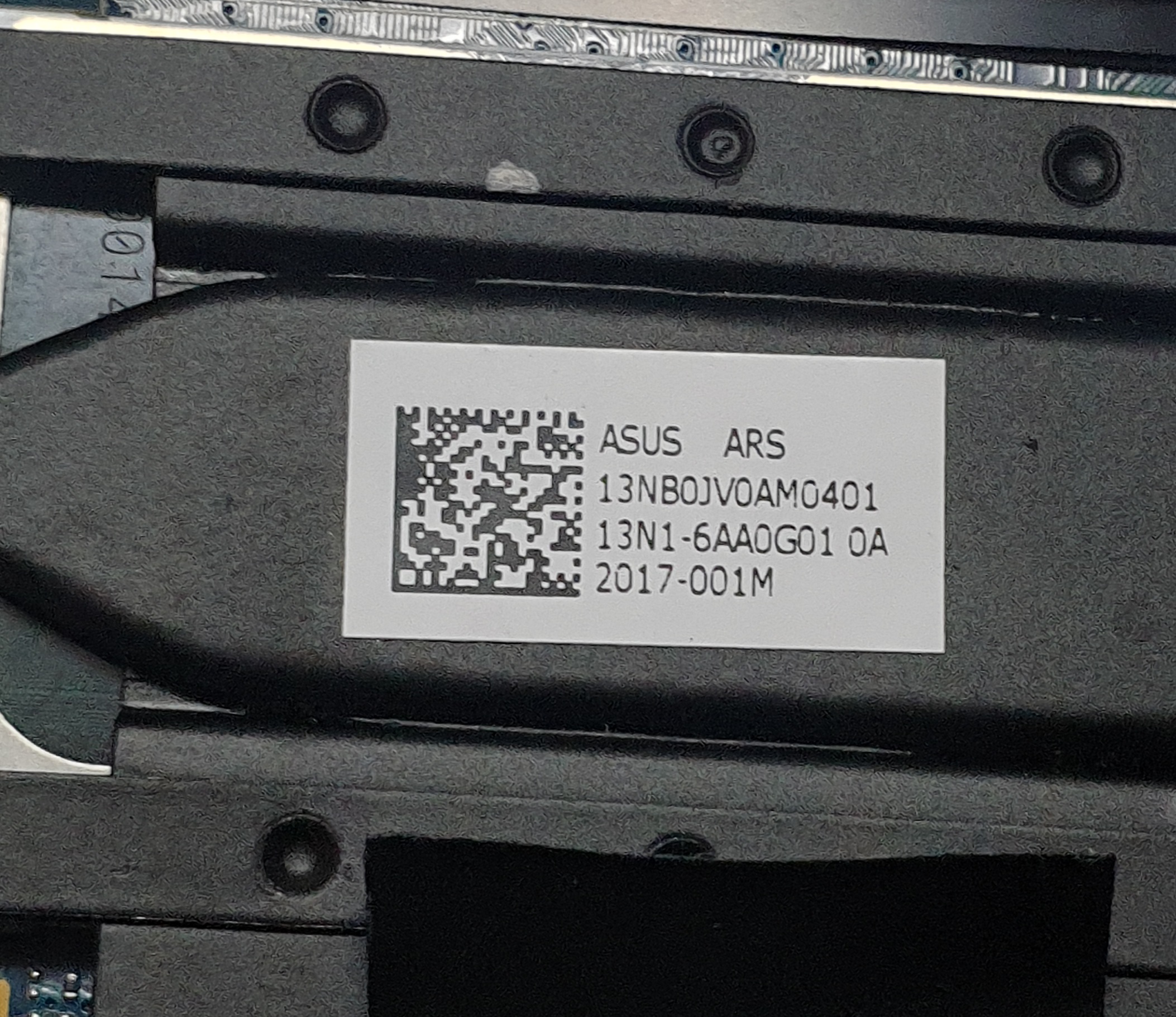

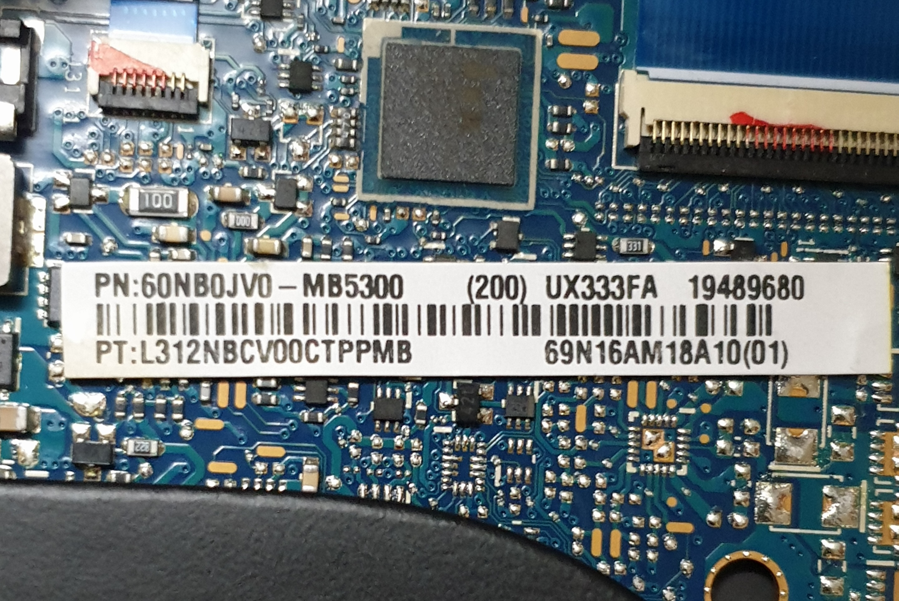

    Post a picture of the white/green sticker on the motherboard, it will have a barcode/QR code on it.Its usually near the ram/ram slot .Post the model number too, such as UX333FA

      Thank you for prompt reply, please find attached requested picture.
      Model number (as read on bottom cover): UX333F

                            Your bios was merged with the UX333FA bios update and ME cleaned.The 2nd bios was from another site with ME cleaned and your dmi added .No idea why it isn`t going into bios menu,there`s still a problem somewhere .
