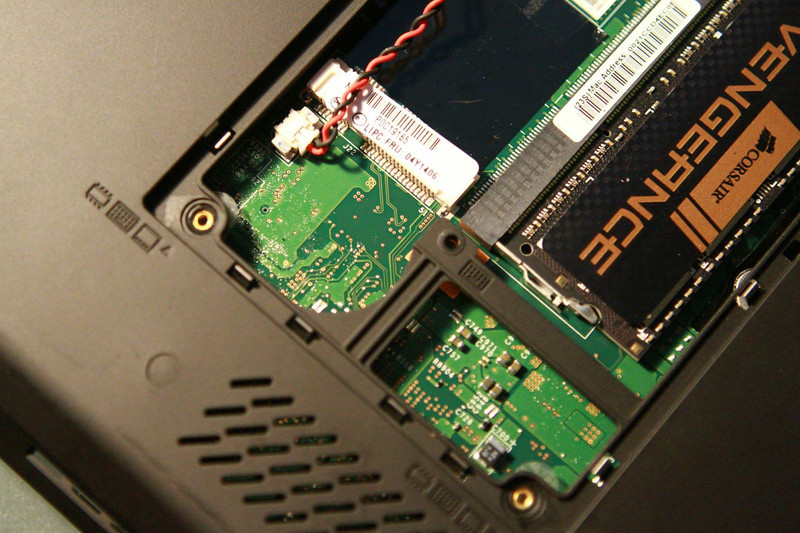

      Re: Schematic for Lenovo T430U
      Can anyone can give me location of the eeprom from t430u?
      • imranromi
        • Jan 2015
        • 1292
        • Pakistan
        Here is T430 maybe same T430u.

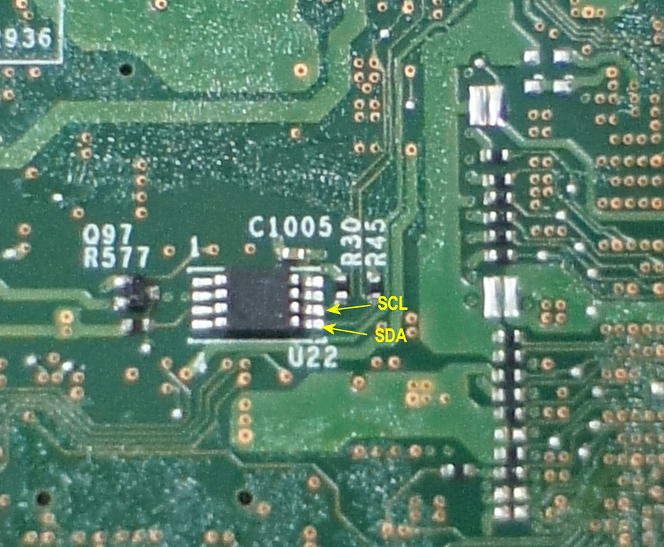

          Its different from t430u
            • 22286
            Eeproms for the T430U are U20 and U23
              Thank you very much.. which one holds the bios password? Im trying to remove or reset the password. Wish you could help me.
              Read eeprom and post here.
              • xelasoulbad
                • Jun 2018
                • 7
                • philippines
                It has 2 spi ic.. which one do i need to read?
                  • 22286
                  The main bios is 8MB U23
                    Ic is Lo8 find and read.
                    • xelasoulbad
                      • Jun 2018
                      • 7
                      • philippines
                      Ok.. thanx.. anyway can i just short its pins so that i can change the password, the same way as to t430s?

                          • 22286
                          Try it, but backup your bios first .The risk is damaging the chip
                              Whats Lo8
                              Eprom chip password store inside this ic LO8.
