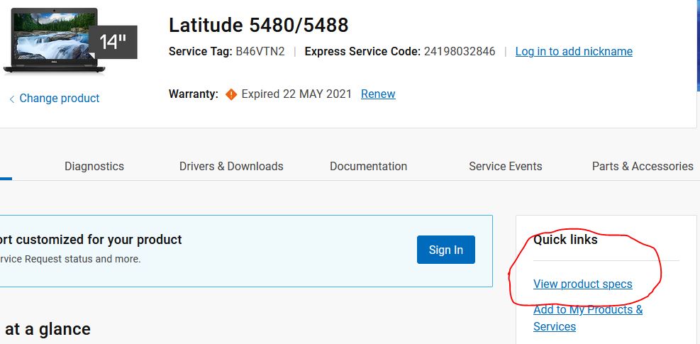

    Hello.
    I need bios for CDM70 LA-E081P Rev 2.0 (not Rev 1.0) plus the EC dump.
    The service tag is B46VTN2 and Express Service Code 24198032846
    Thank you!!!

                            I download many and i'm not 100% sure it's from this exact motherboard.

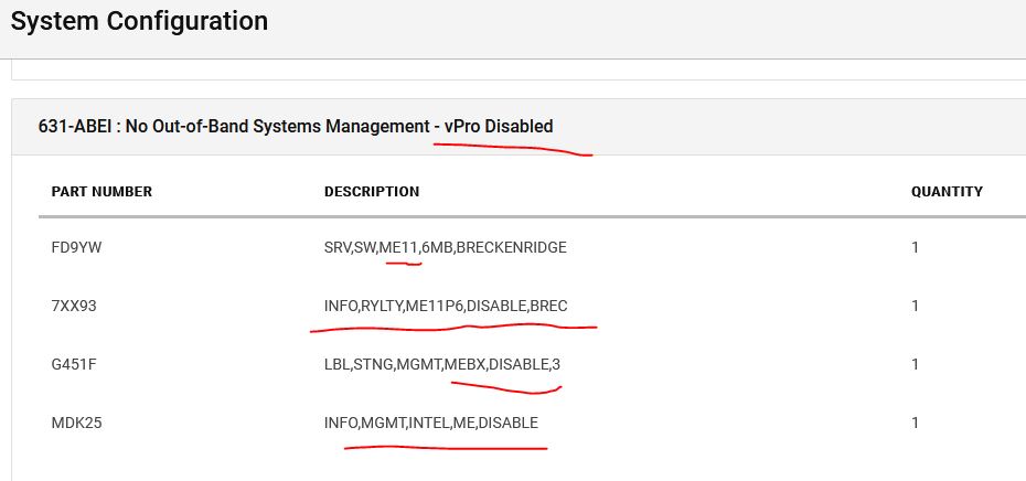

                              • 20983
                              Re: Dell 5580 CDM70 LA-E081P Rev 2.0 + EC request
                              Originally posted by Andreasbest
                              Can you confirm the bios i sent you is really the correct?
                              Try this one,based on your service tag config it should be ok,vPro is disabled .
                              https://www.badcaps.net/forum/showpo...1&postcount=16

                                  • 20983
                                  Main bios flashed ok.
                                  On EC i get warning that data size is smaller than chip size.
                                  Plus this EC is completely different than my backup and all other EC i download.
                                  Should i proceed?
                                  The 1MB "EC" you posted isn`t the EC ,its likely to be USB 3 or thunderbolt firmware. The EC is the SMSC MEC chip, youve no need to flash that,unless you have a vertyanov,SVOD3,SAS programmer .(The EC is extracted from the bios update, its not the full size,it would need merging using a hex editor)
                                  Just flash the bios and see how it goes.
                                  The other 2 bios posted in this thread have boot guard set to 0 ,it should be 5 ,and the oem key missing.No good
