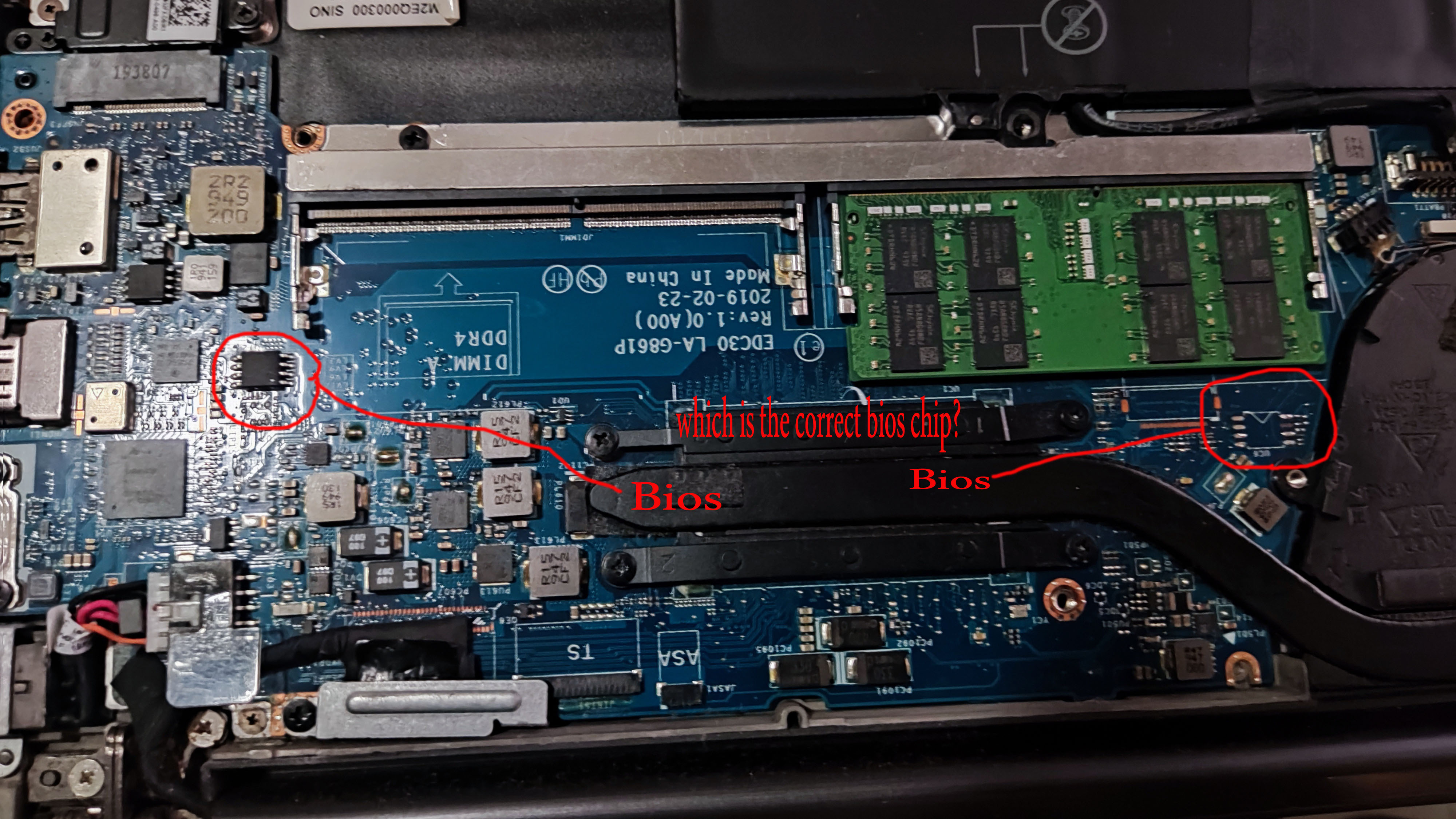

                      • 22199
                      #110
                      Originally posted by sassan
                      hi,
                      same problem ,but i noticed that UC6 is missing,maybe someone has done some work here before me,
                      can you please tell me what is the missing ship?
                      Thank you.
                      UC6 isn`t missing. Your laptop has vPro ,Corporate LP firmware ,the bios is a single 32MB chip. For non vPro configurations the bios is split across both bios chips.

                        #111
                        well,i've searched images of the same board and the chip is there,that's why i think it's missing,not sure,
                        Thank you
