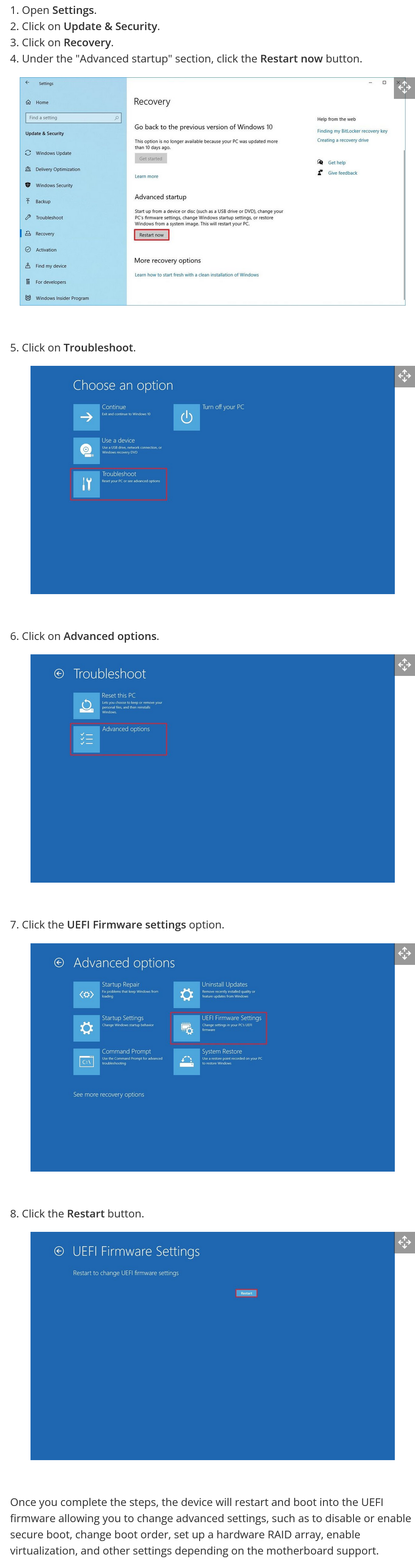

          • Vesko356
            VIP Moderator
            • Aug 2018
            • 4386
            • Bulgaria 🇧🇬
            Originally posted by Calgacus
            Thanks for the fast reply everyone, very much appreciated...
            apologies for not following the rules. I did read them originally when i joined and donated..must have missed that rule or i didnt see updated rules.
            Lenovo 330s-14AST Model ID:81F8
            SN:YD05Q6MU
            i will update the board revision number tomorrow as i did not bring tools home with me to remove the board...sorry
            Thanks again
            Paul
Name:	How to enter UEFI (BIOS) on Windows 10 PCs.png
              SN:YD05Q6MU
              Thanks again
              Paul
              Try what Vesko posted,if it doesn`t work flash this bios.
              Bios + DMI.

                  Thanks for the replies and bios fix, I tried the Windows UEFI firmware method but got the same result. I am getting verification errors after writing back to the chip. It said the write was successful but failed verification. I think it's the bios chip that's failing/failed...
                  I should have a replacement at work, so I will try writing bios to another chip tomorrow.
                    SMDFlea commented
                    Editing a comment
                    That can happen if you havn`t erased the chip before programming.
                • Calgacus
                  • Aug 2022
                  • 82
                  • Scotland
                  Thanks SMDFlea, i was not aware of that, still learning lol. Flashed a new chip today and resoldered, we are now back in business.
