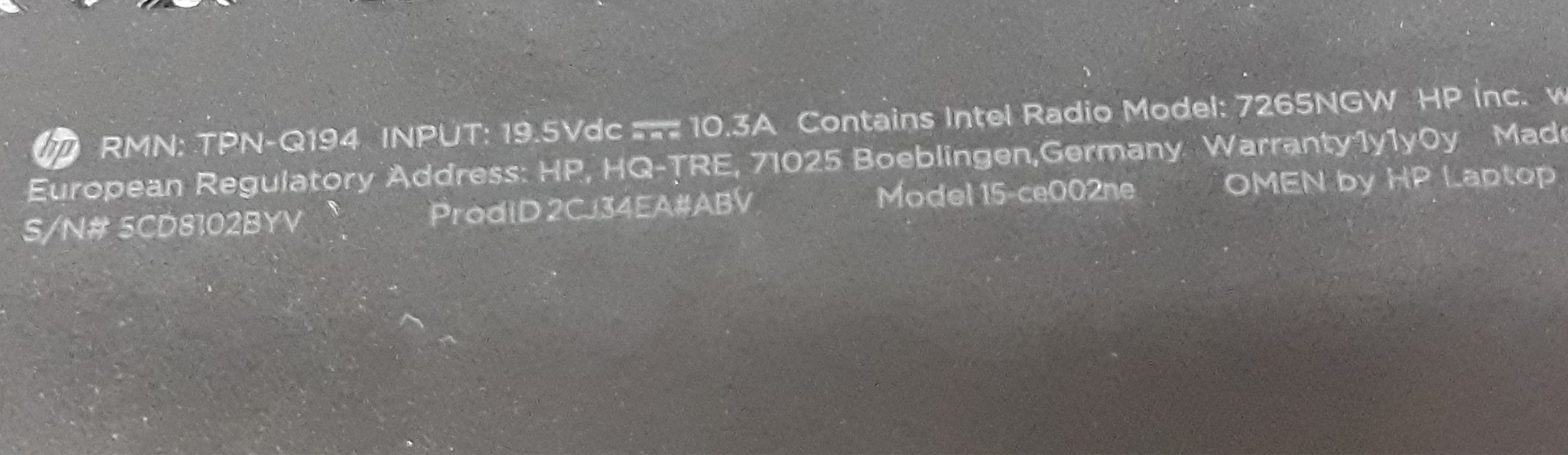

                        Hp omen. model:15-ce002ne Need dump bios
                        I Need Bios Dump File Please
                        dag3abmbcd0 rev: D
                        SN:5CD8102BYV

                          Re: Hp omen. model:15-ce002ne Need dump bios
                          dag3abmbcd0 rev: D
                          Read the rules before posting:
                          Upload your bios backup. Add serial number and issue description.
                          Become a Badcaps supporter
                          Thanks to all supporters.
                            Edited
                              Edited
                              Bios version F.24 with your DMi and Win key:
                                Thank You being tested
                                • mah3r0
                                  • Dec 2020
                                  • 19
                                  Tested and works. Thank you for the golden help..
