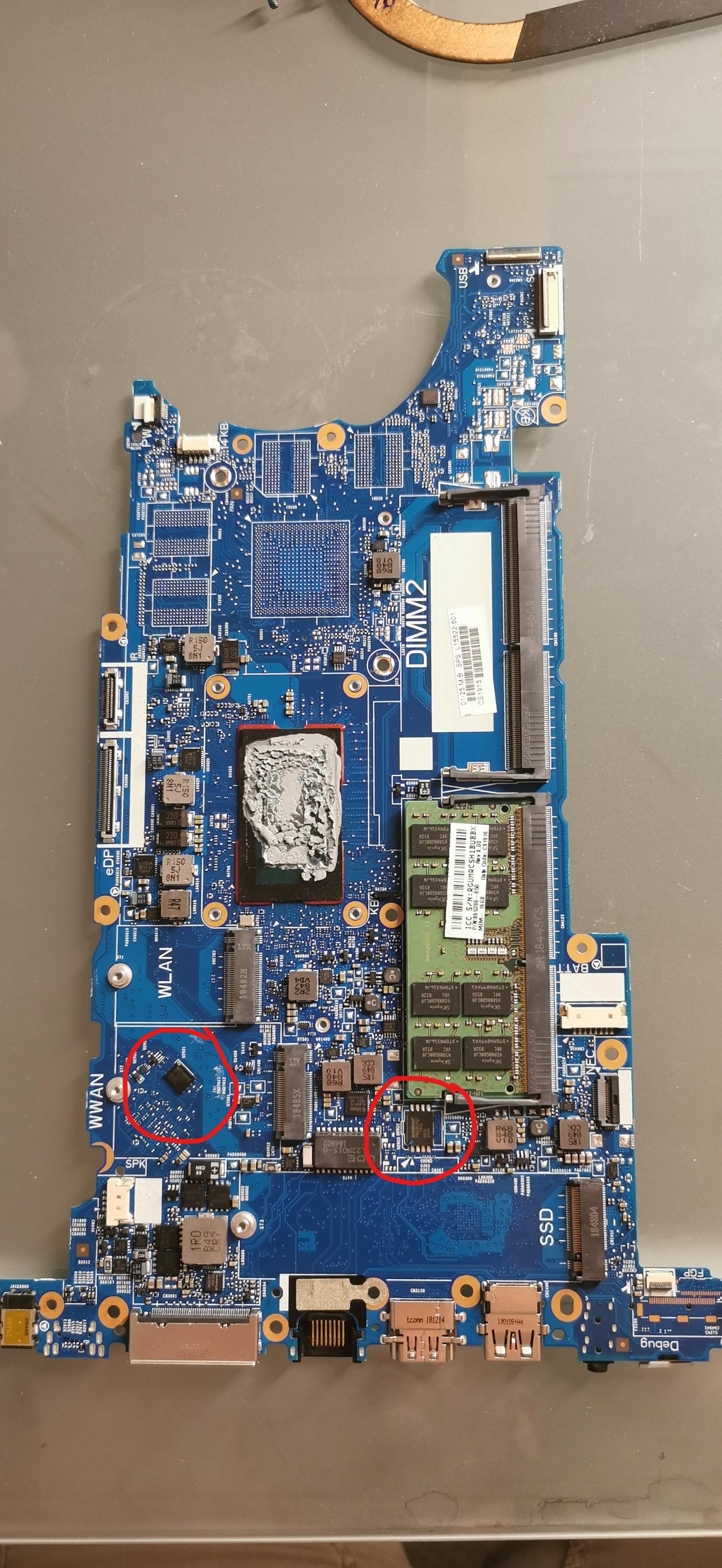

    Hello Guys,
    Here I got a HP Elitebook 850 G5.

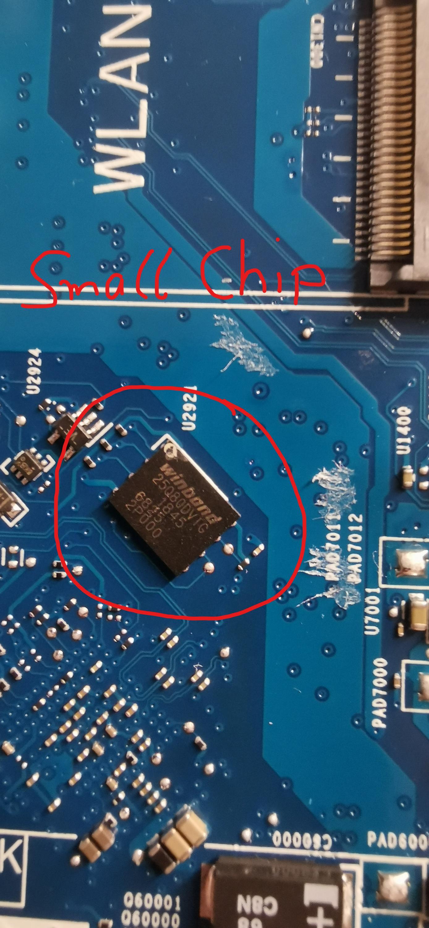

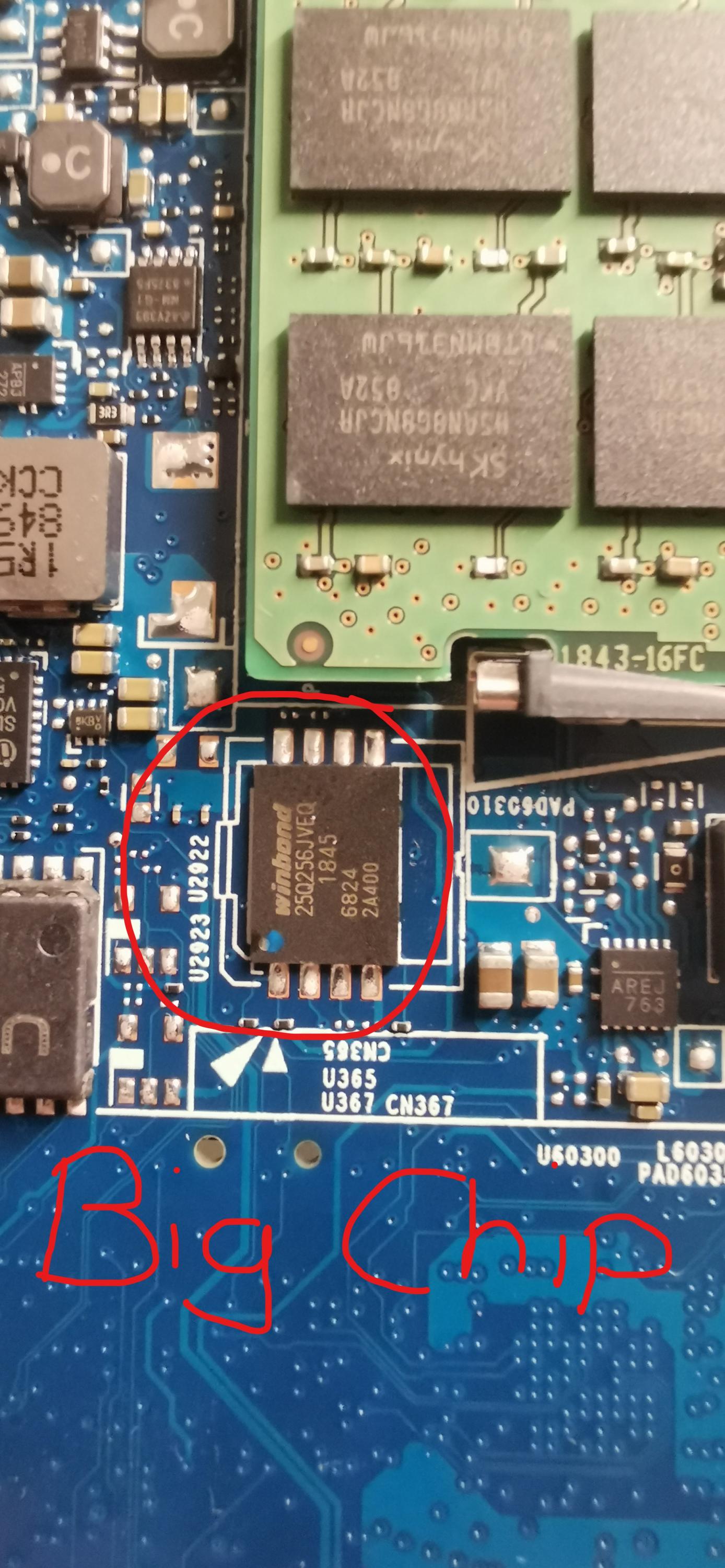

    The Bios is locked. But before unsoldering the Chip i need to know, which Chip is what. I got 2 Chips on the Motherboard. One of them is small and the orther is bigger. Which one i need to unsolder for unlock the Bios ?
    Can Please someone help me ?
    Thank you Guys !

    the big one 25Q256JV

      Thank you very much for the fast answering !
      Do i just need to unsolder them to unlock the Bios Password ?

            if the problem is only the Administrator password dump the 16Mb chip only and use RCUnlocker to edit the file and remove the password.
            https://www.badcaps.net/forum/showthread.php?t=103526
