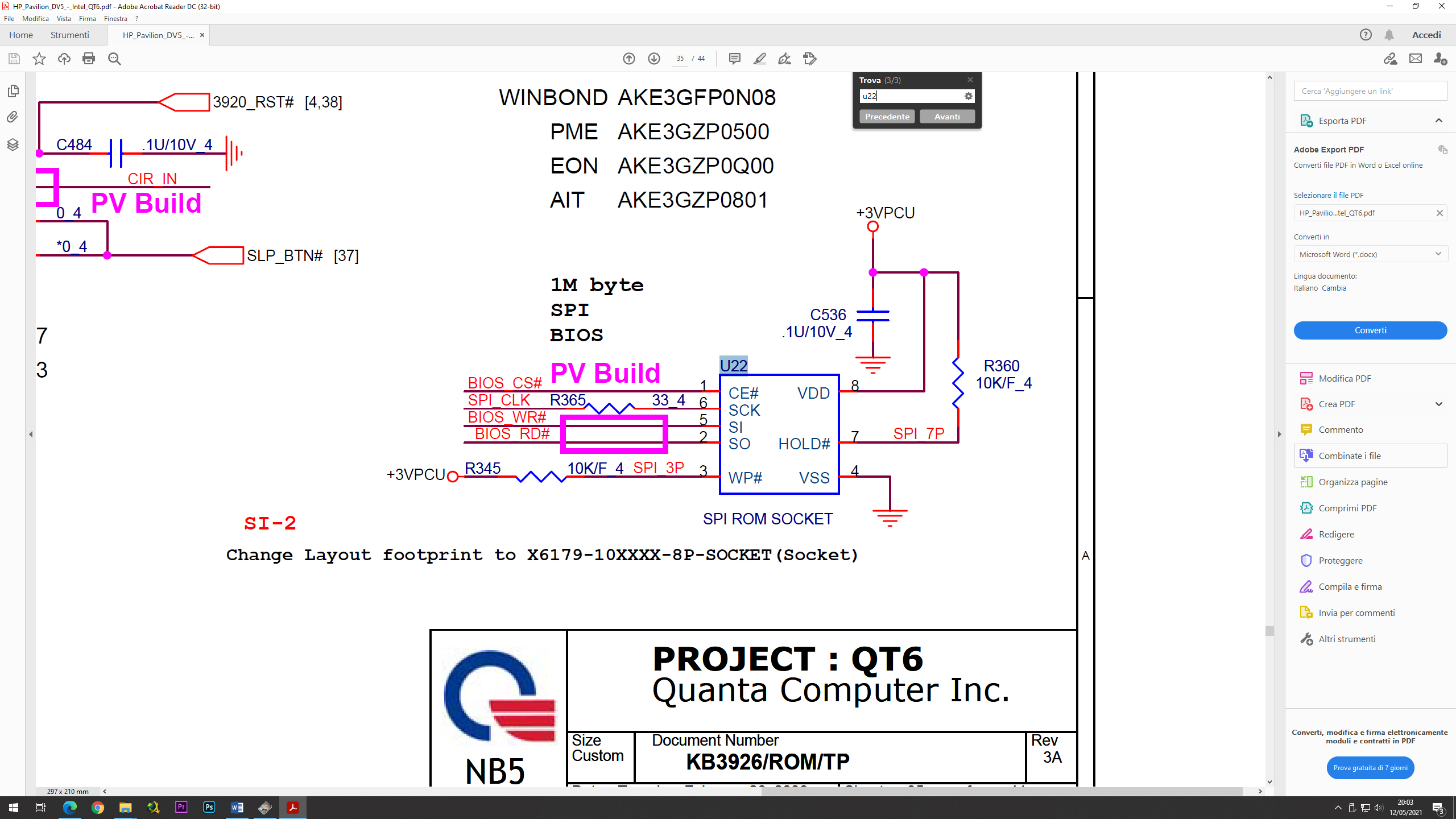

        It's not bios dump , there's another chip
        • Dowhile
          • Sep 2020
          • 35
          • Italia
          Re: Bios HP dv5-1020el
          Are you sure? on schematic u22 is the bios spi flash.
          here the pic.

              ty, right now the laptop charge the battery (before was completely dead) when i press the power btn led stays on 1sec then off. do you think it is a bios issue or something else?
