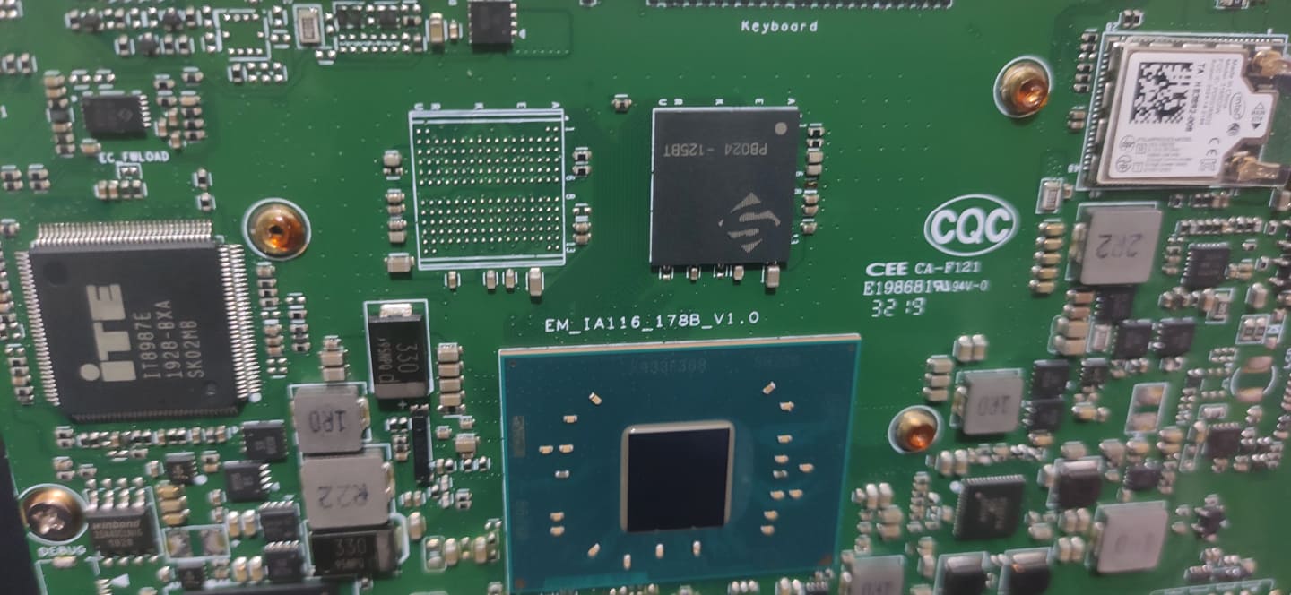

                Please unlock password unowhy Y13
                unlock pass bios unowhy Y13

                    • 22416
                    Re: Please unlock password unowhy Y13
                    Originally posted by msnessay
                    please help
                    Open the locked and unlocked bios from post 1 and 2 with a hex editor,use the "File-Compare" function to see the differences. All you have to do is zero fill the areas in the AMITSE area (leave the 01 at the end)
                    There`s 2 areas in your bios to zero-fill
                    1DC761 - 1DC774
                    1FC761 - 1FC774
                    HxD hex editor - https://mh-nexus.de/en/hxd/

                    • msnessay
                      • Apr 2015
                      • 121
                      • GRANDY
                      1DC761 - 1DC774
                      1FC761 - 1FC774
                      I tried it but not works
                      laptop no power after this modification
                      help please

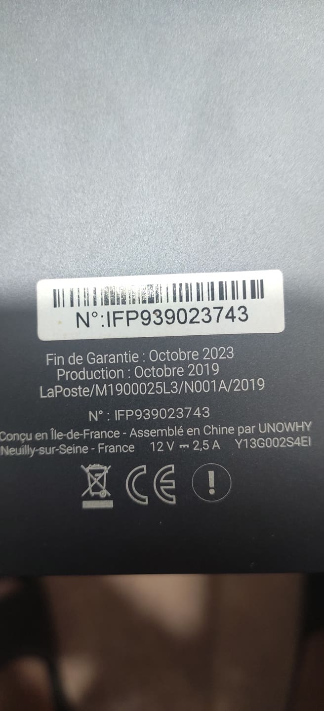

                            • 22416
                            any help
                            I didn`t take much notice of picture you posted, you have a different model to the one in the thread title... Y13G002S4EI . Its going to be harder to remove the password due to where its stored in one of the partitions. Might be easier to find a bios dump and clean the TXE firmware
