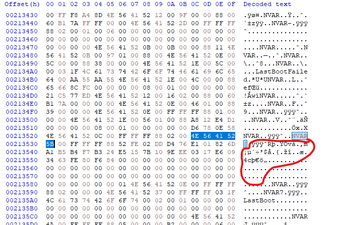

                                  hey so i did remove this kind of bios password few times by now, but this time i messed it up and i somehow i changed something else in the bios file beside "amitsesetup" and the laptop lost power, laptop draw around 0.088 amps and go down no power light and nothing can someone help me fix the bios file and thanks
                                  ps: i messed with the lines "NVAR[" putting the original bios didn't work
                                    Type the laptop serial number ,IFP**************
                                    read the forum rules..https://www.badcaps.net/forum/troubl...before-posting
                                      sn: ifp133058371
                                      board number: EM_IG116_200b_ENE_F_v1.0
                                        • 21859
                                        #359
                                        sn: ifp133058371
                                        try
