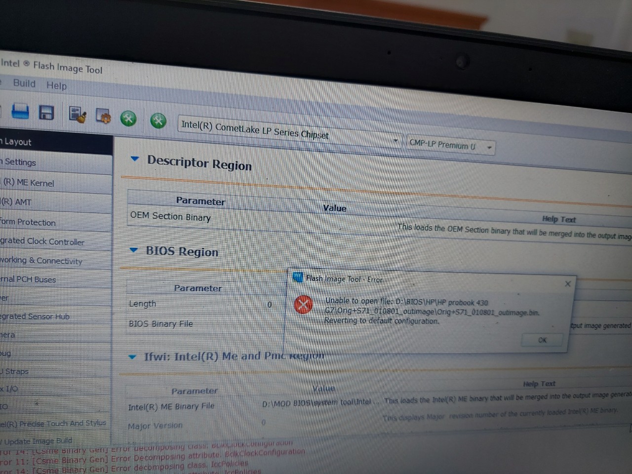

          thanks reply!
          i flash image tool ( V 14.0.20) but have erro
          all donations are welcome,
          >>>>> click on this link to donate via PayPal. <<<<<
            • 21439
            Re: HP probook 430 G7 clean ME ?
            Originally posted by clrscr
            thanks reply!
            It will open ok with FIT from Intel CSME System Tools v14 r1
            • clrscr
              • Dec 2020
              • 186
              • sing
              ok, thanks so much!

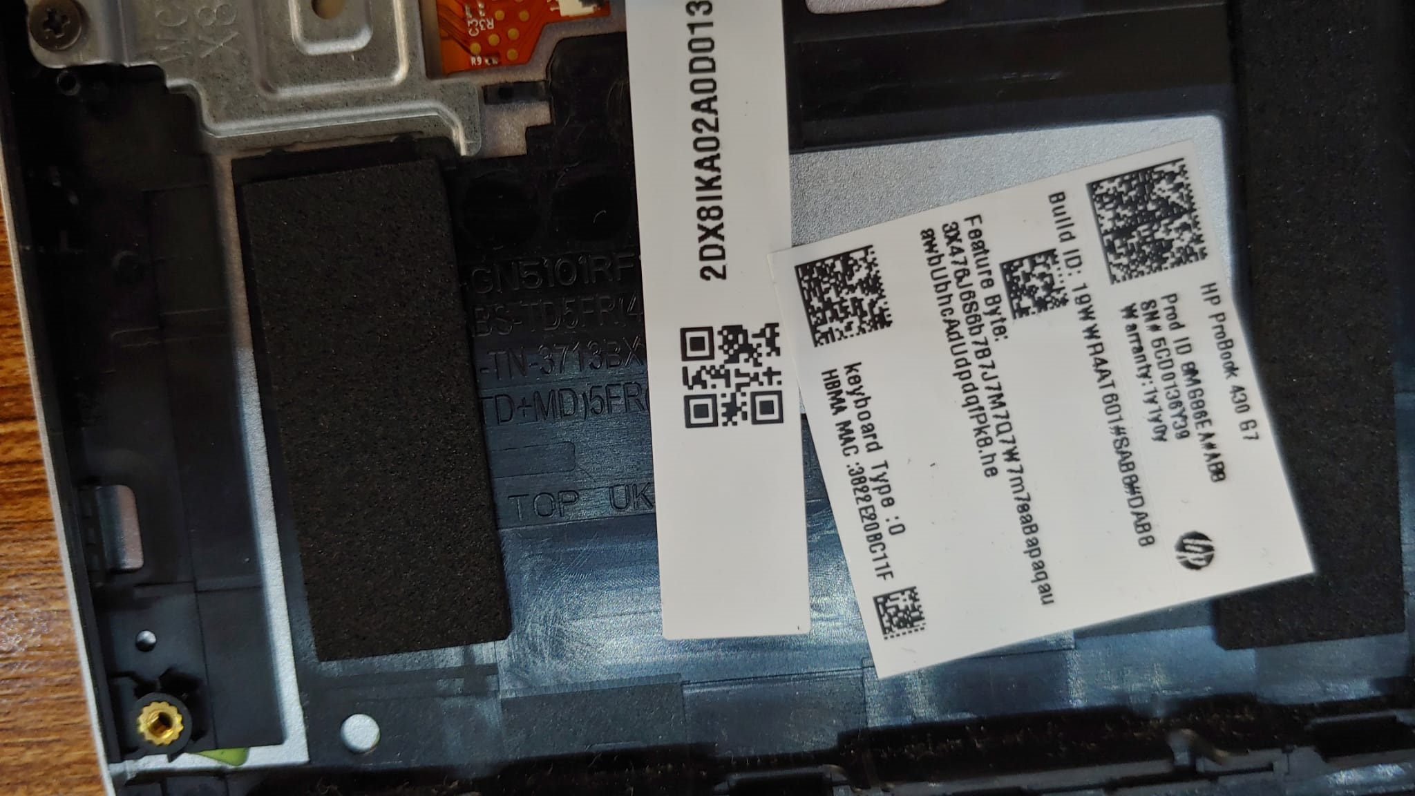

                              hello guys , got this Hp probook 430 G7 which i bought from a joblot, before i reset any Hp UP to 8th gen but in this 10th gen i have defficulty, i used HP and RCU unlocker, i even tried to remove password using HexEditor but i failed and pasword is still there! i read this forum and someone mentioned that it is done i need help to reset this attached with explaining how it is done, any help is appreciated.
                              • peste
                                • Dec 2016
                                • 13176
                                • ROMANIA
                                try..

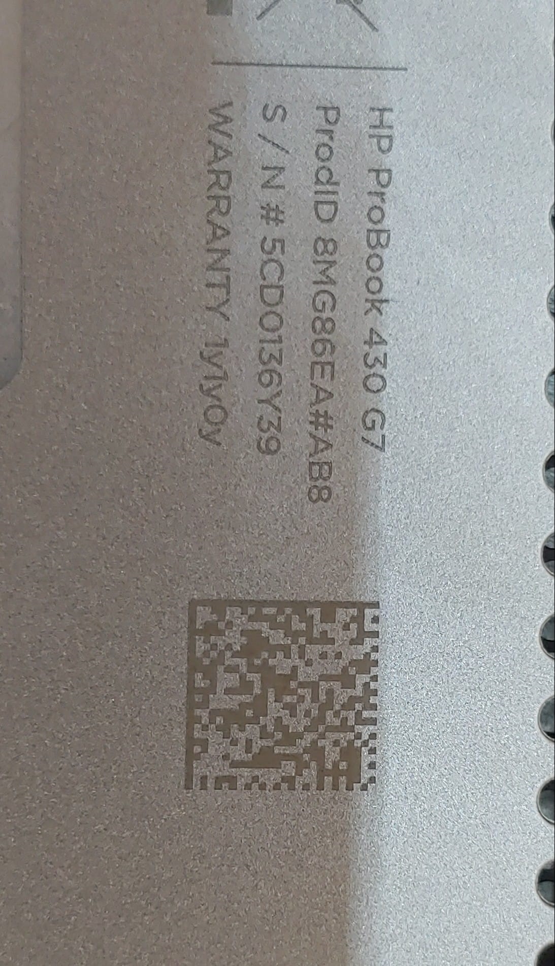

                                      Originally posted by rager007
                                      hello, it starts and draws 1 amp. no screen
                                      Orjinal bios backup
                                      Thank you very much for your interest
                                      board model : Da0x8lmb8d0 rev
                                      Here's your New BIOS file, try it and give me the results.
                                      Serial Number: 5CD0136Y39.
                                      • rager007
                                        • Feb 2016
                                        • 106
                                        • Usa
                                        hello, I just tested it, there is no image, it draws 0.60 amps
                                        can other ec bios be problem ? thanks a lot
