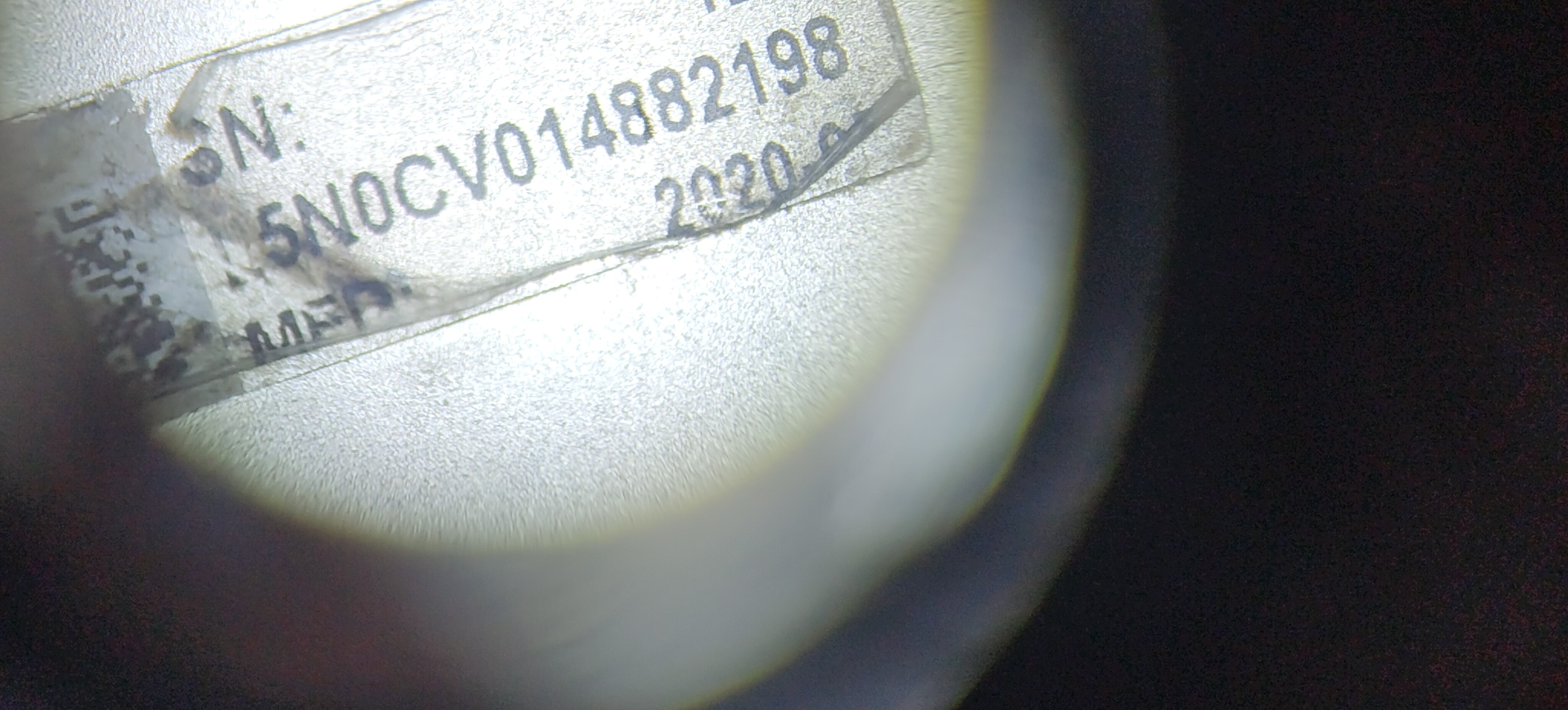

                    • PetrN2O
                      • Aug 2024
                      • 10
                      • Israel
                      #50
                      Originally posted by PetrN2O
                      Hello. After flashing the BIOS, the laptop stopped turning on, when you press the button, the red and white LED lights up, the cooler does not spin.
                      here is a copy of the old BIOS and a photo of the model. please check bios
                      asus ux534f
                      motherboard UX534FT rev.2.1
                      Serial number: L5N0C014882198

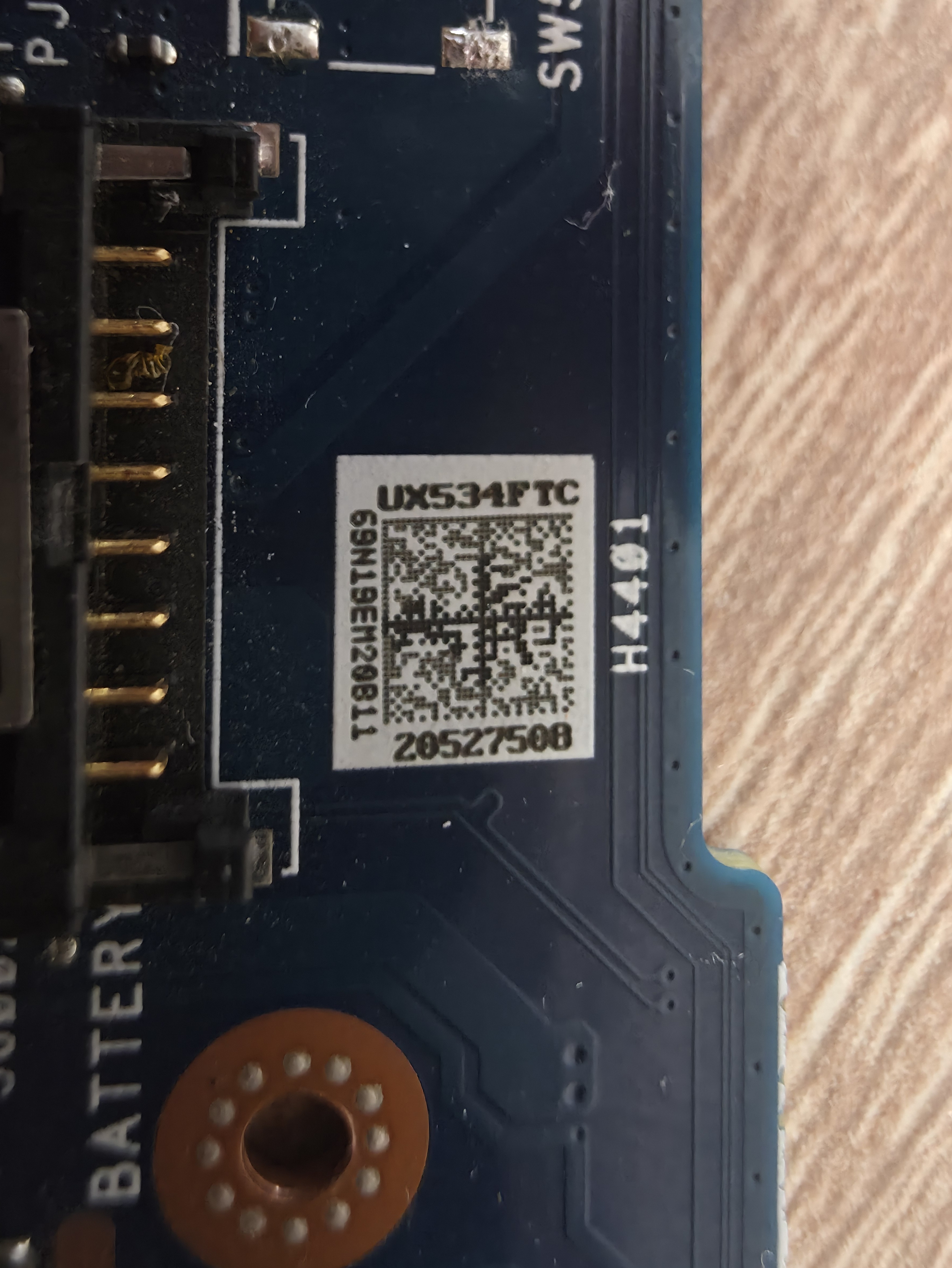

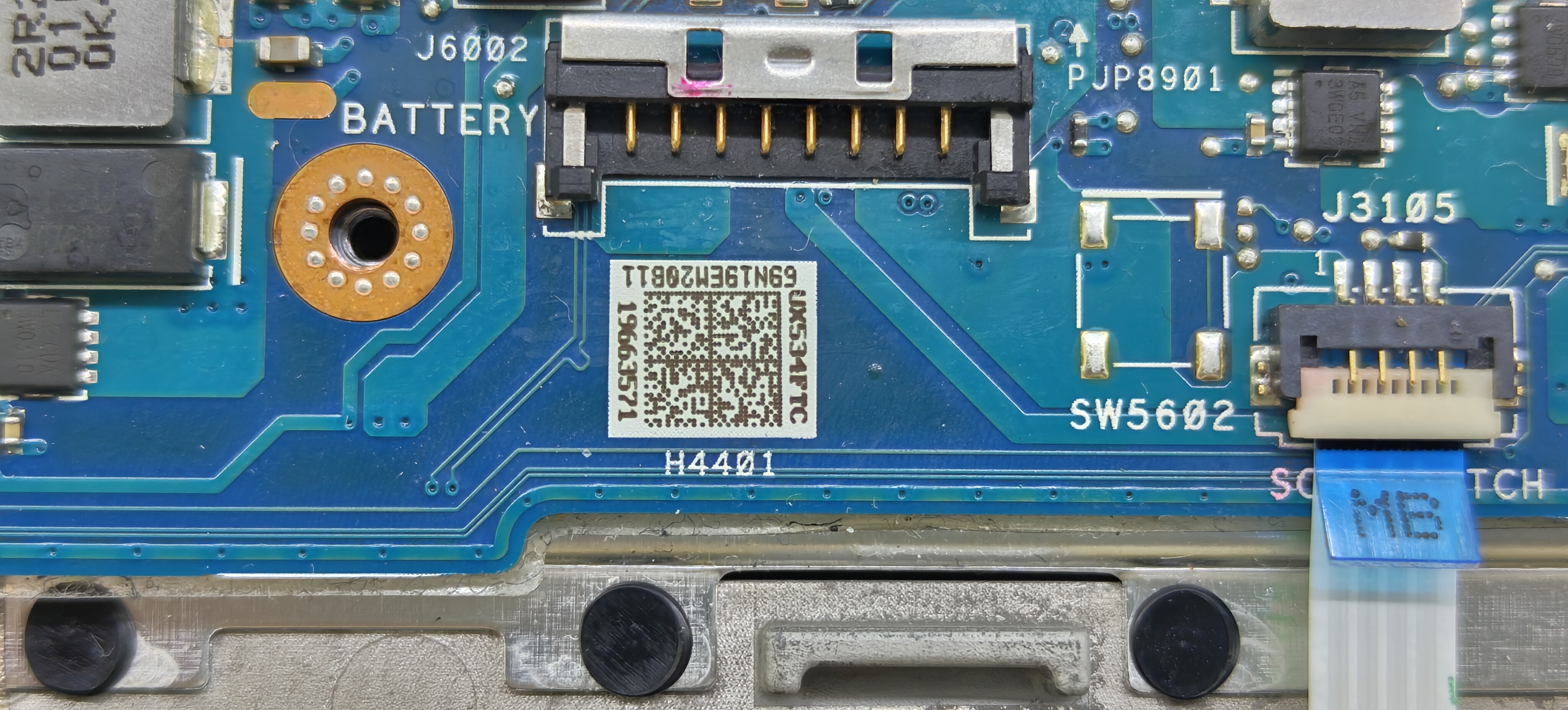

                                #55
                                Originally posted by kalilinux25
                                INVALID serial number please double check
                                photo of the back cover and motherboard, I couldn't find any other SN.
                                • danito
                                  • Jun 2016
                                  • 1259
                                  • Romania
                                  #56
                                  sn L5N0CV014882198
                                  try
                                  • PetrN2O
                                    • Aug 2024
                                    • 10
                                    • Israel
                                    #57
                                    Originally posted by danito
                                    sn L5N0CV014882198
                                    try
                                    Thank you very much, it worked. you are doing a great job.
