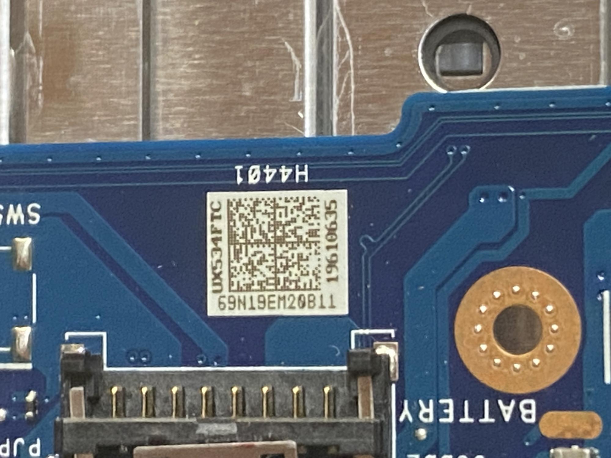

              See post #6:
              Originally posted by SMDFlea
              Post a good clear picture of the white sticker with the barcode/QR code on it .

                  Re: ZenBook 15 UX534FT BIOS UX534F
                  Hi, attached isbthe qr code photo
                  • Vesko356
                    VIP Moderator
                    • Aug 2018
                    • 4386
                    • Bulgaria 🇧🇬
                    #29
                    Use the bios at post #9.

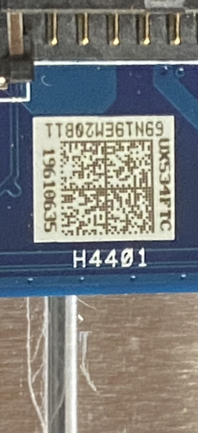

                                #35
                                Originally posted by Wellcome
                                This is what I extracted
                                Zenbook 15 UX534FTC

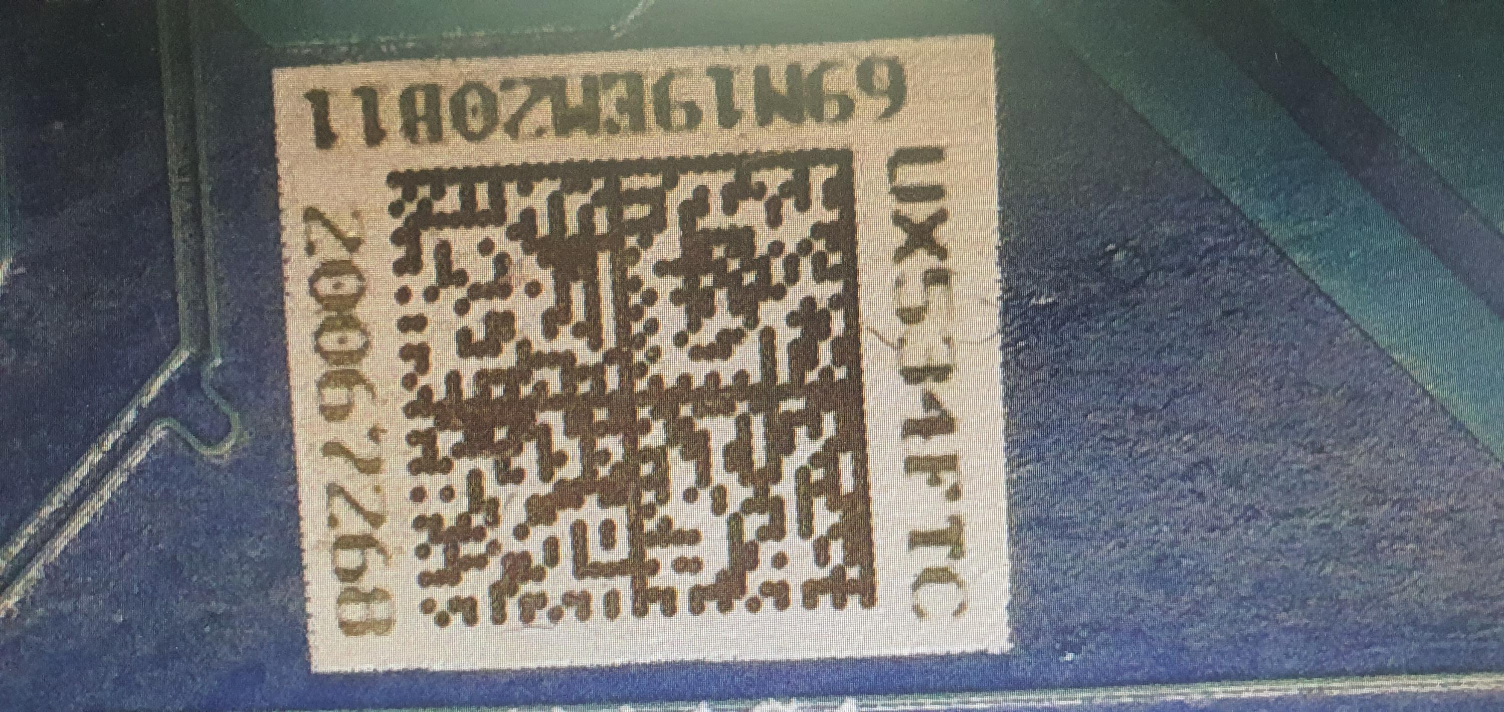

                                        #39
                                        Ok I uploaded picture
                                        • Vesko356
                                          VIP Moderator
                                          • Aug 2018
                                          • 4386
                                          • Bulgaria 🇧🇬
                                          #40
