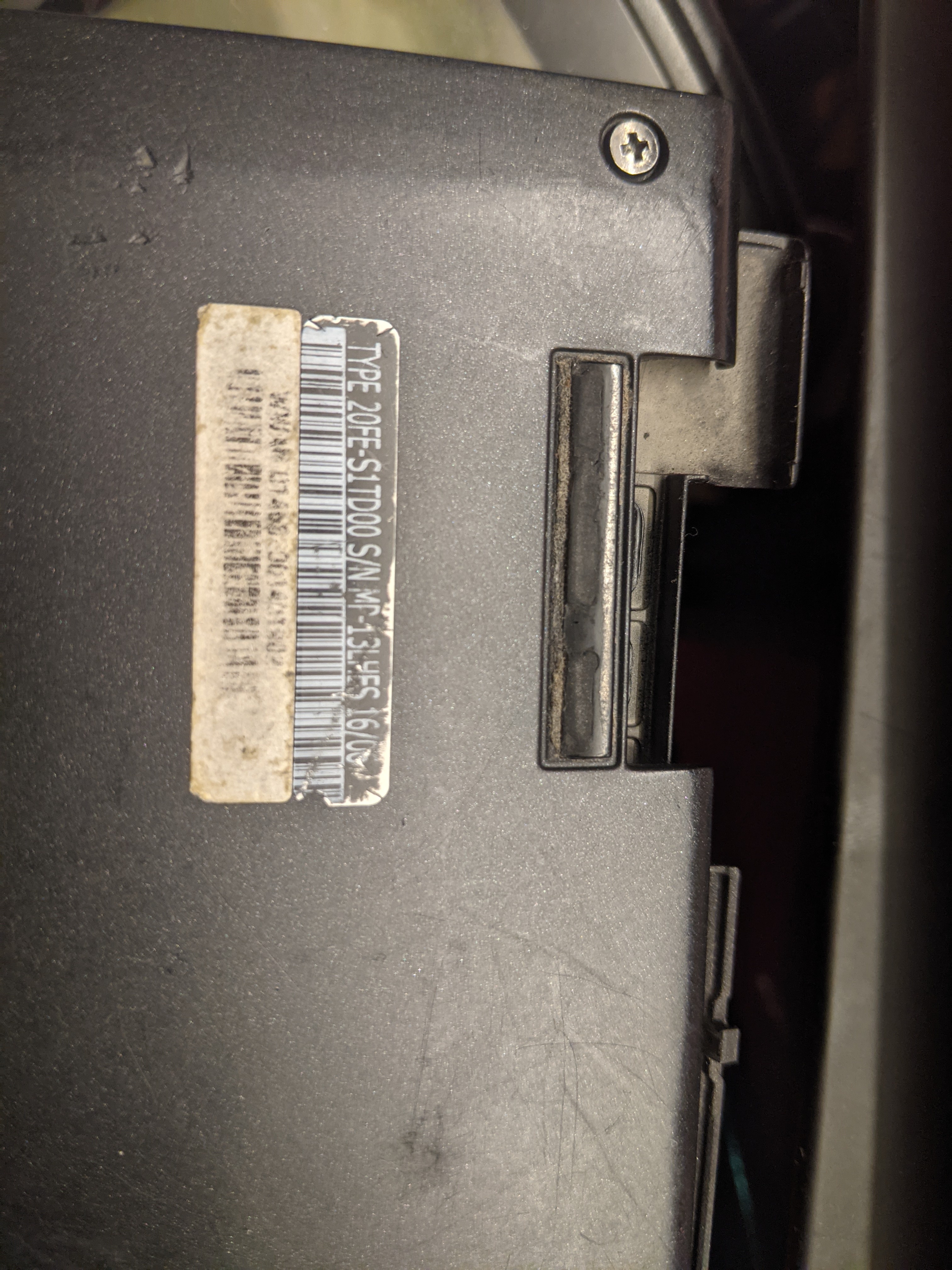

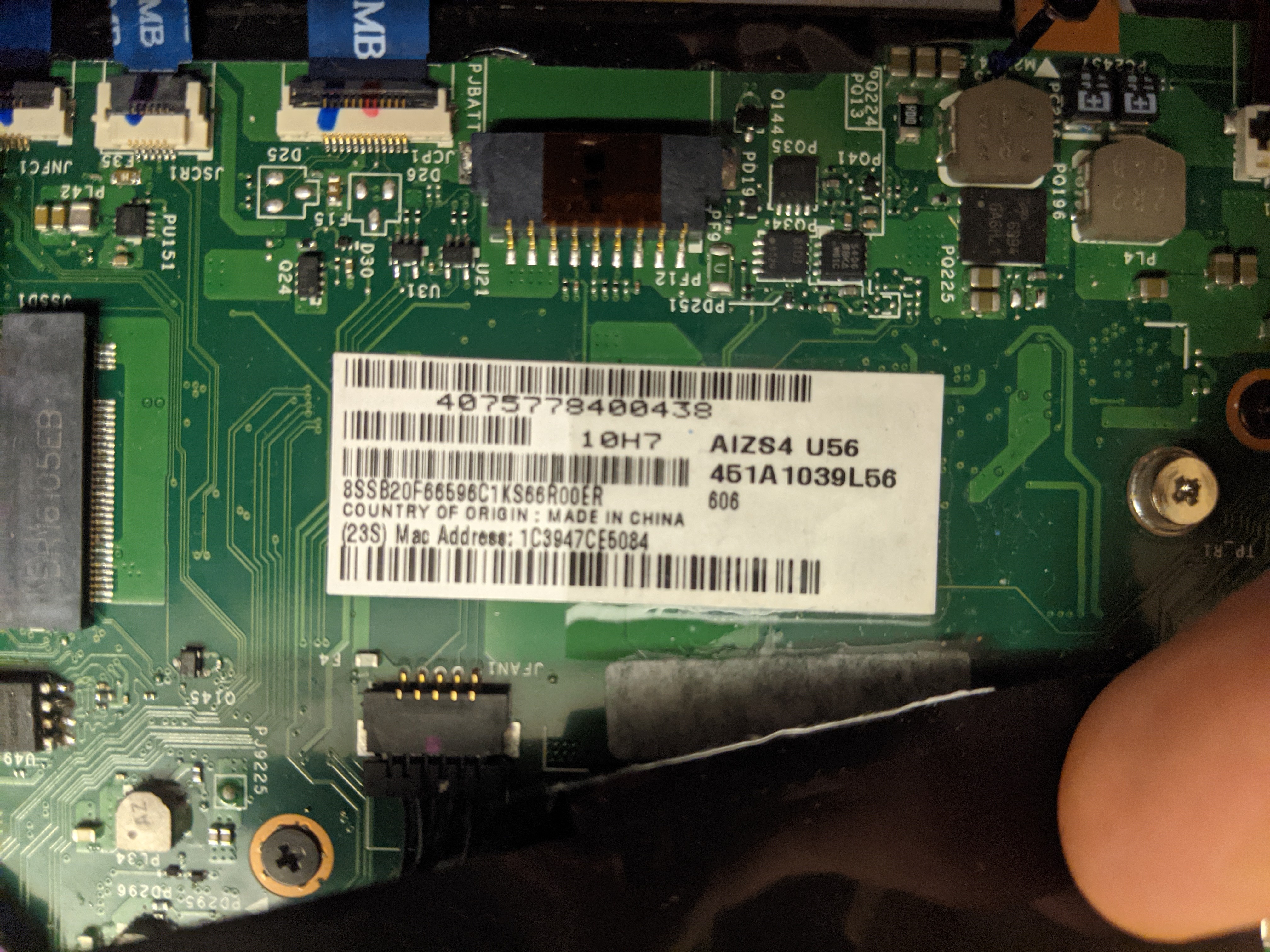

                            • mawa1105
                              • Nov 2021
                              • 16
                              Heeey again.
                              My first post was deleted, because I didnt follow the Board rulez (Sooooorryy!!)
                              background story:
                              I have two Lenovo Yoga 260. With a AIZS3 LA-CP582 Boards
                              One broke down, the fan started blowing after pressing the power button but it didnt POST. And the fan stayed on, on full power forever.
                              I took a Bios-Dump with a CH341A-Programmer from both Laptops.
                              I tried to flash the BIOS dump of the running one to the broken one but that didnt help.
                              Then, I tried to flash the dump from the broken one to the running and now both are dead, no matter, what dump I flash to the machines. 😆😖
                              My suggestion is:
                              The dumps are corrupted due to reading them with a "unmodded" / 5V programmer.
                              Sadly I can not find the correct way to "repair" the bios Dumps.
                              I Upload a Zip with the broken Bioses 1 from the initial dead one, 2 from the initial working one, and extract from the r02uj77w.exe from the Lenovo Homepage
                              I already rewired my programmer to 3.3v and can write, read, and verify the W25Q128FV chip.
                              It would be great if someone could give me helpful hints for repairing the notebooks.
                              Thanks in advance
                              Mawa
                                • 21163
                                Originally posted by mawa1105
                                Heeey again.
                                Post the laptop serial number please .
                                RULES UPDATE for BIOS requests/offers AVOID BANNING, READ BEFORE POSTING
                                https://www.badcaps.net/forum/troubl...before-posting
                                You MUST:
                                • mawa1105
                                  • Nov 2021
                                  • 16

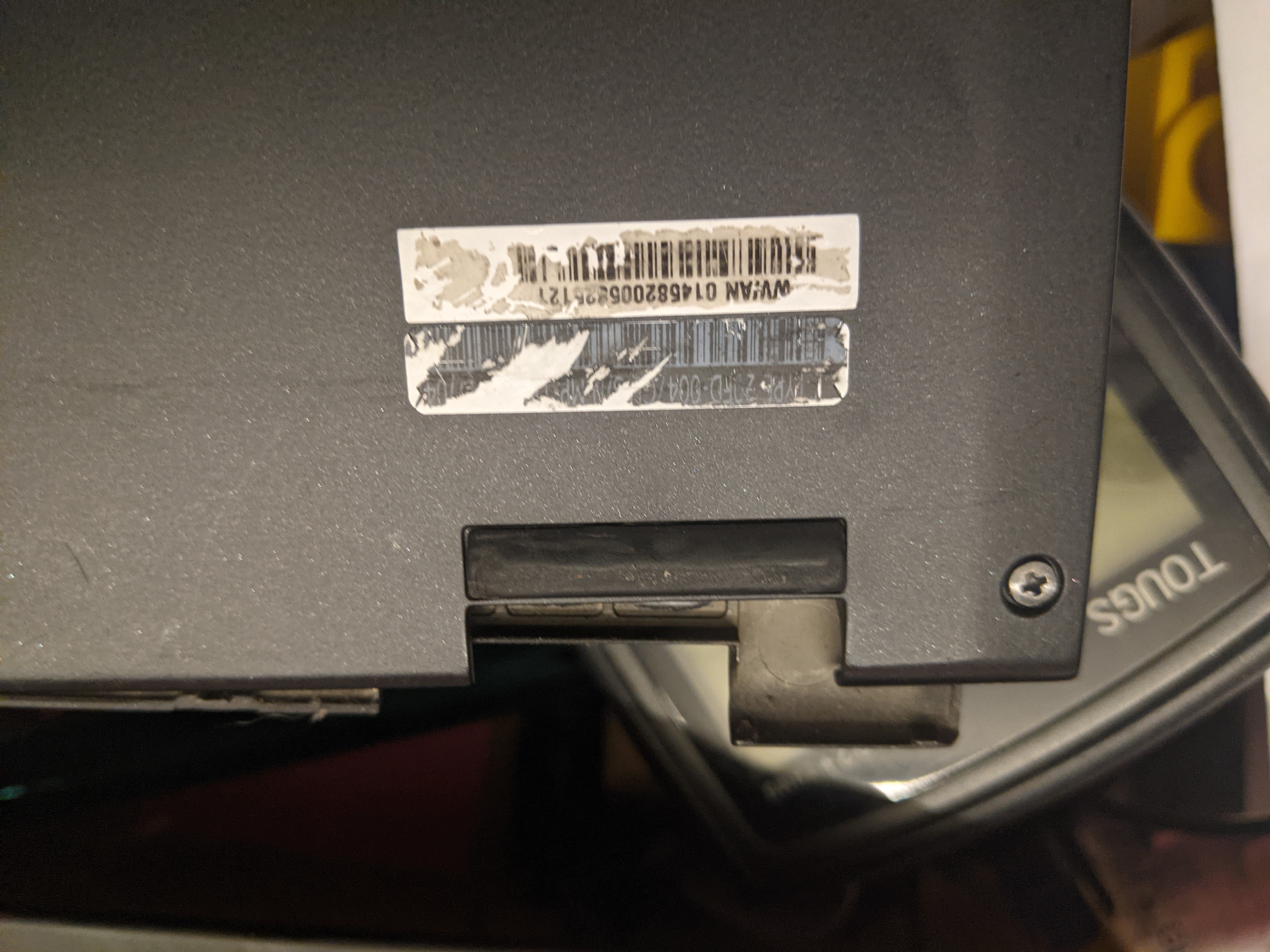

                                  The Type should be 20FE-S1TD00
                                  Sadly I can not read the SN. I guess one is MP-13LHES16/06 The other MP-********/04
                                  And they could be wrong because the backcover of the mashines are interchanged from other broken ones.
                                  Do you have suggestions where else to find the SN?
                                  Regards Mawa

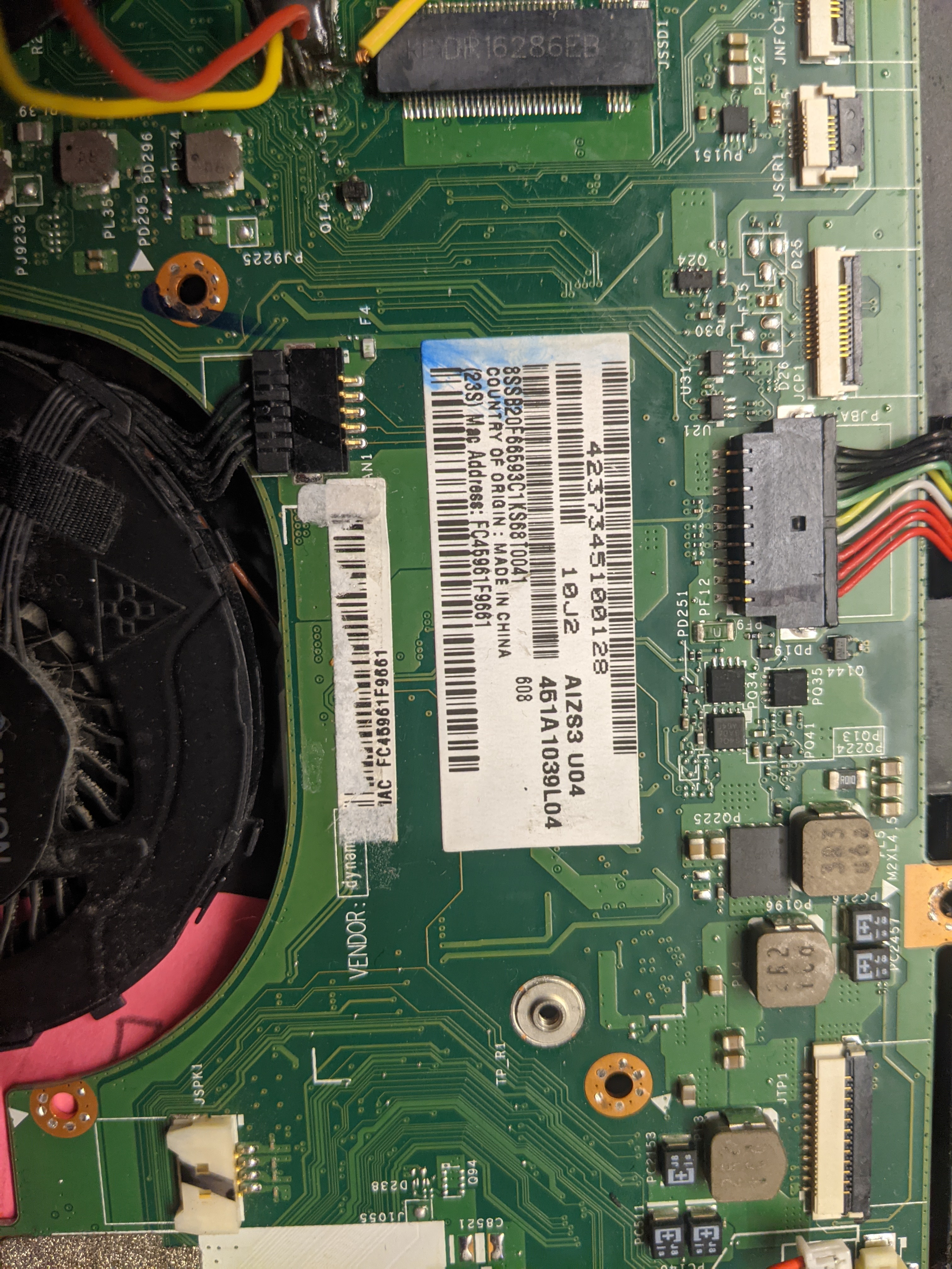

                                    • mawa1105
                                      • Nov 2021
                                      • 16
                                      Hey Hoaca,
                                      thank you, but on the broken one, same symptoms:
                                      -fan full power if I press the power-button
                                      -no POST
                                      -Turns off on long press pwr-button
                                      On the previous working one:
                                      -fan+ keyboard backlight turns on for 1 sek
                                      -turns off
                                      -turns only on for 1 second again after disconnecting battery
                                      Any furher ideas?
                                      Mawa
