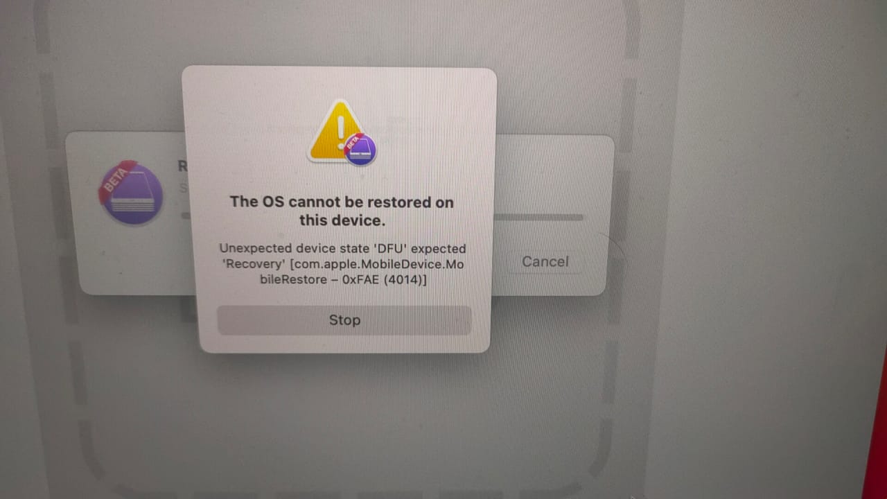

    A1990 820-01814-A Bios
    anybody have ==> bios files
    Apple MacBook Pro Retina 15 Early 2019 Touch Bar A1990
    820-01814-A
    Thanx in Advance

    Re: A1990 820-01814-A Bios
    There's no BIOS to dump on T2 machines.
    If you mean T2 ROM, try DFU recovery first.
      i have tried dfu mode but getting some error
      not able to restore and update (i have used thunderbolt 3 to thunderbolt 3)
      see below
          Put it in DFU again and restore.
