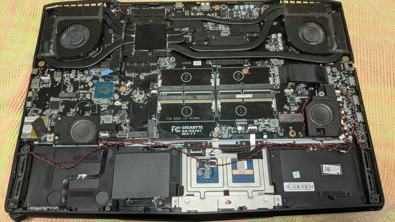

            Here we are again.
            Have same laptop, same mobo, same request.
            I have attached them 2 bios saves: one had 1Mb and it is a Winbond chip; the other one is an 8Mb MXIC chip.
            Searched Gigabyte site, but only found the bios as an EXE.
            Thank you in advance

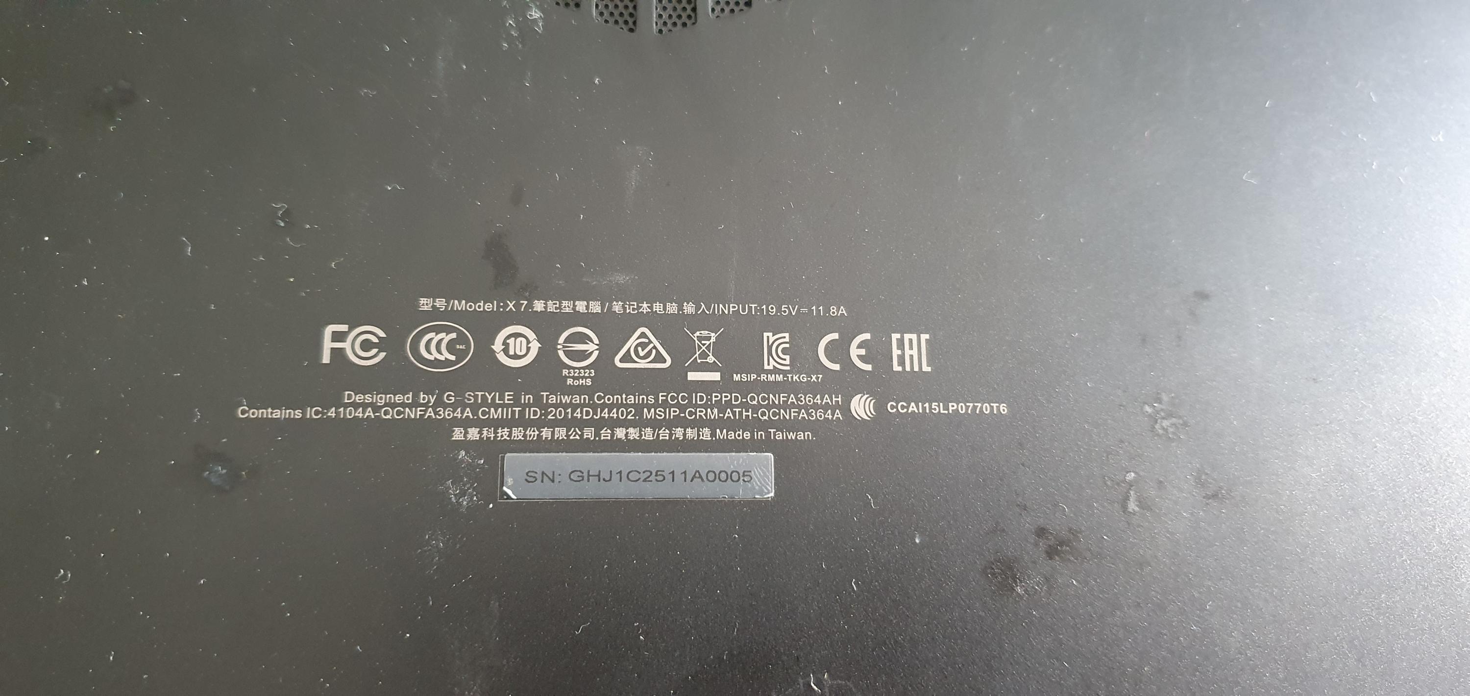

                post the serial number
                • Rhadu23
                  • Mar 2021
                  • 74
                  • United Kingdom
                  Re: Gigabyte Aorus X7 v7-cf1 BIOS dump request
                  and the serial number is: GHJ1C2511A0005
                    • 21679
                    Can you post a good picture of the sticker on the base with the PN and SN on it
                      see if this is of any help
                        motherboard is: GA-RX7X7 REV:1.1
                              do you want a picture with the motherboard?

                                  The serial you gave doesn`t match the one in the bios so it might have been flashed with a different one. Both serials aren`t recognised at gigabyte support,its typical of them though. This is the right support page i think - https://www.gigabyte.com/Laptop/X7-v...upport-dl-bios

                                    Thank you for your reply.
                                    There is nothing more on the motherboard or the case relevant to post to you.
                                    If you wish to post all of them 4, it would be great.
                                    Thank you in advance.
                                      • 21679
                                      All four + win key.No DMI (serial) it might be in the EC.The 1MB file you posted is for the thunderbolt FW. If you do get it booted you can flash the EC from windows,there are 2 different versions.You can extract the bios exe using 7-zip or winrar .
