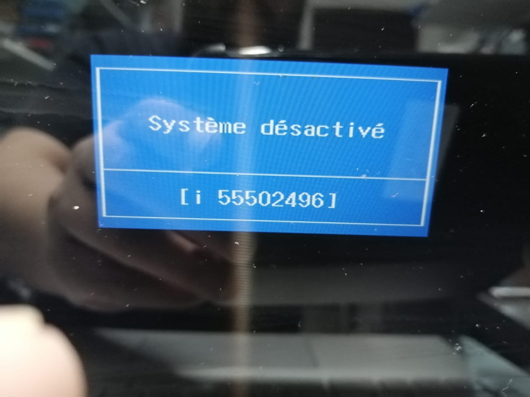

Hp 14-bf008nf bios pwd
  • tooko
    • Nov 2014
    • 38
    • france
    Hp 14-bf008nf bios pwd
    I need help to unlock a HP 14-bf008nf locked. it asks an admin password on boot. 3 tries gives me an error with this code i55502496
    is it possible to get master password ? or do I need to dump and reprogram bios chip ?
    Best regards
  • tooko
    • Nov 2014
    • 38
    • france
    Re: Hp 14-bf008nf bios pwd
    here is a dump of the BIOS chip Gigadevice 25B64CSIG
    • peste
      • Dec 2016
      • 12742
      • ROMANIA
      Re: Hp 14-bf008nf bios pwd
      Originally posted by tooko
      here is a dump of the BIOS chip Gigadevice 25B64CSIG
      try..
      62393839
      • tooko
        • Nov 2014
        • 38
        • france
        Re: Hp 14-bf008nf bios pwd
        Originally posted by peste
        try..
        62393839
        it works thank you very much _ It would be interesting to know how to ! maybe Hp unlock tool ? Anyway thank you very much.
        Best regards
        • macabook
          by macabook
          🧩 Initial Issue
          07-24-2025, 02:17 PM
        • Vesko356
          by Vesko356
          08-11-2023, 03:27 AM
        • jbonavita
          by jbonavita
          Some issues
          Things I tried
          04-29-2025, 09:38 PM
        • zenius
          by zenius
          12-08-2024, 06:13 AM
        • Wahaz
          by Wahaz
          10-30-2023, 08:42 PM
