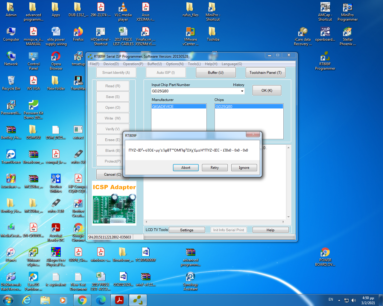

    Dear all
    i have the motherbaord da0r62mb6e1.
    The light at jack is on, i have 3.3v on bios ic but no clock or data.
    So i use rt809f isp programmer with 1.8v adapter to read bios 25q80bs1g but i get error characters.is this ic 1.8v!
    Can someone help
    thanks
    • 20637
    Re: Bios read error help
    If you have 3.3V on bios ic then why would you try programming the chip at 1.8V, that doesn`t make any sense. Read the datasheet
    https://datasheetspdf.com/datasheet/25Q80BSIG.html
    Single Power Supply Voltage -Full voltage range:2.7~3.6V
