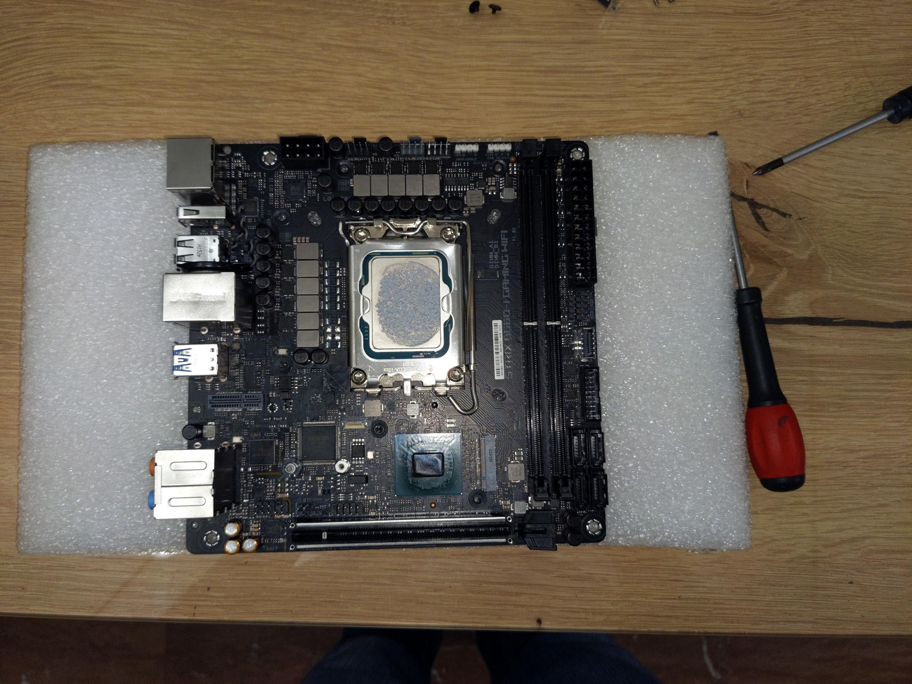

    I updated my pc, from Evga z270 itx to Asus b660-i itx motherboard. In my old z270 motherboard everything whas easy because everything in bios was unlocked (fd, me etc), and could do everything I want.
    Now in my Asus b660 everything is locked (except main bios region). I dont mind so much but I want to unlock bios so I can flash a new splash screen (I have done it with my old motherboard).

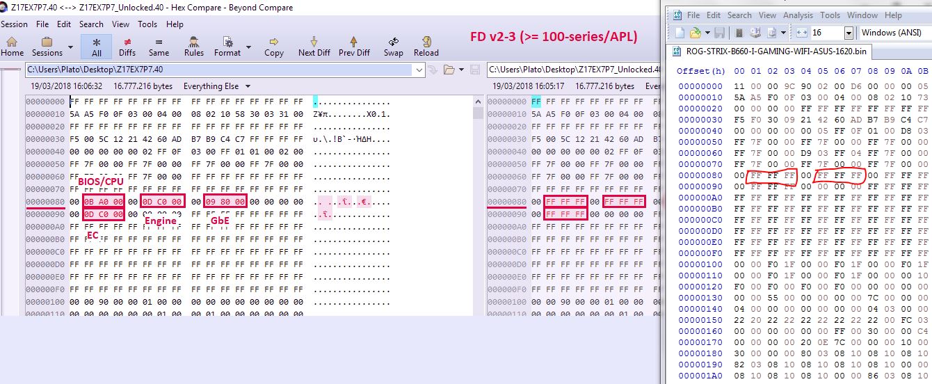

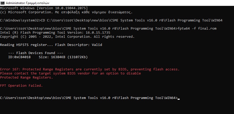

    I made a bios dump with FPT (fptw64 -d mod.rom -bios), I modded it and I tried to flash back
    (fptw64 -f mod.rom -bios). I got Error 167: Protected Range Registers are currently set by BIOS.
    After reading this guide, I found bios lock in setup 0x1D and i disabled it.
    Also found FPRR but was already disabled. Tried again, still same error.
    I suspect that BIOS Guard is the problem but I can’t find it.
    I also read this similar guide 2 but that was easier finding BIOS Guard.
    I run out of ideas. I include my bios dump.
    I would greatly appreciate your help or either point me into the right direction.
    Look forward to your feedback or reply’s.
    Thank you for your time.

        Ok I tested it, same error.
        Its the stock bios without aptio capsule, extracted with uefitool

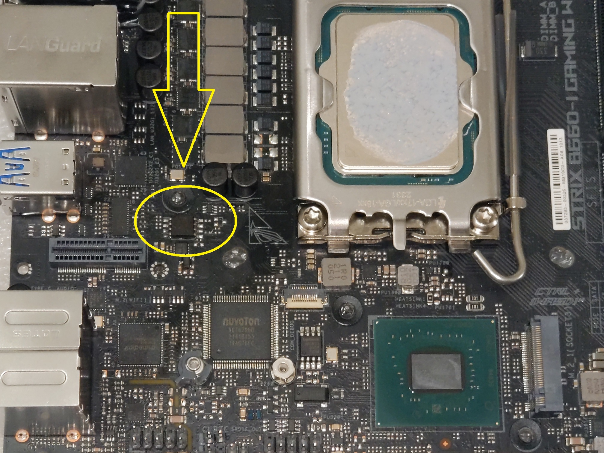

            If that doesn`t work try the pinmod method to unlock the flash descriptor,if you can find a datasheet or pinout for the audio IC. https://winraid.level1techs.com/t/gu...ervicing/32449
            If none of that works you should buy a bios programmer, you can use a clip if the chip is SOP8 or if its WSON you can get a WSON pogo pin adapter.Have a look for programming header pins as well,they might not be shown in the user manual but could be on the board.

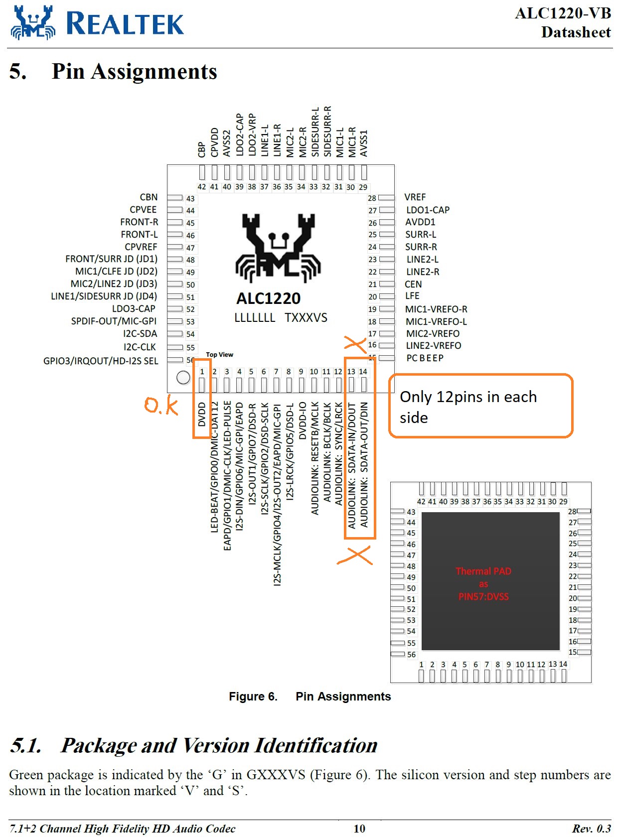

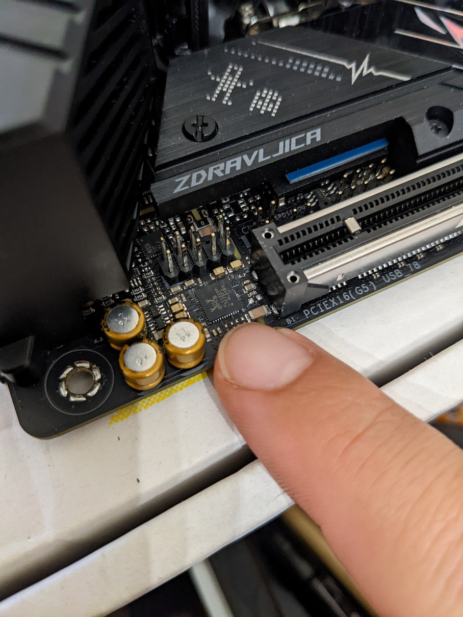

              This guide (and others in that forum) is my bible. I tried it but the pins are so small that is almost impossible shorting the pins.
              Also my audio chip is a Realtek alc1220p (not 1220 or 1220VB) and I cant find datasheet. In datasheet of alc1220VB though, SDATA_OUT is in 14pin, but my chip has only 12pin in each side! (i tested with 1-5 position)
              I will do that.

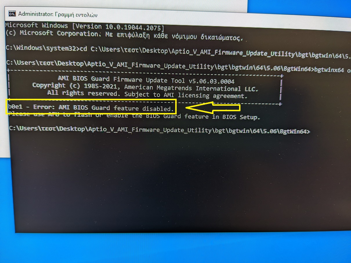

              One observation:
              When I was playing and testing with AMI bios guard firmware update tool, I got this error:
              So my assumption was wrong. Bios Guard is not the reason I get the Error 167 in FPT (i think )

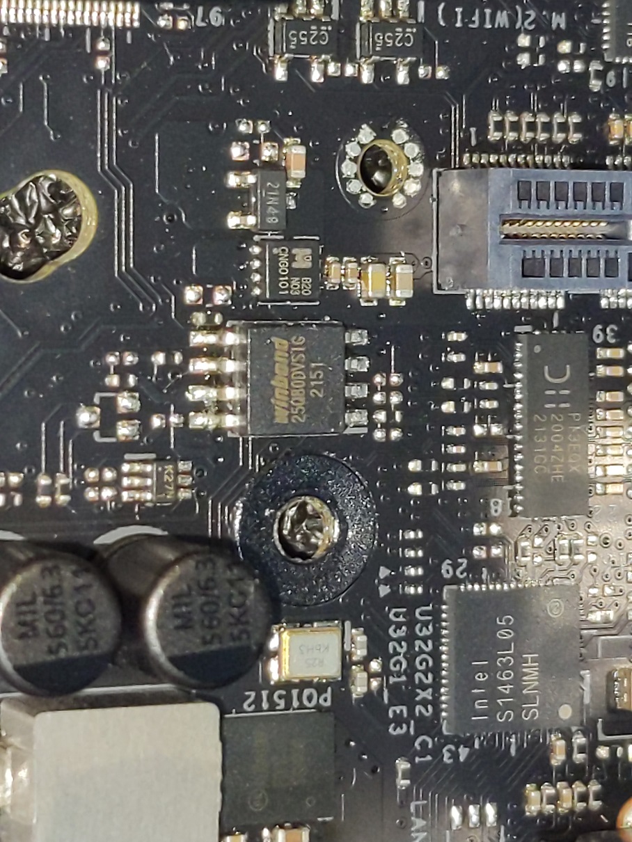

                Originally posted by greg.chalk
                The chip is a w25q80dvsig (SOIC-8 208mil).
                That isn`t the bios chip,its only 1MB (8Mbit)

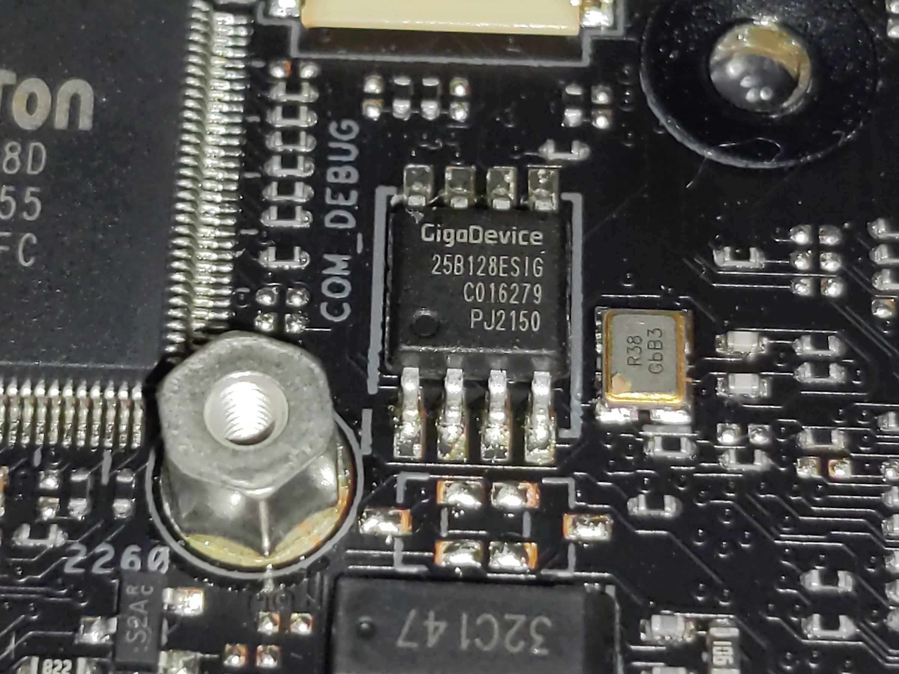

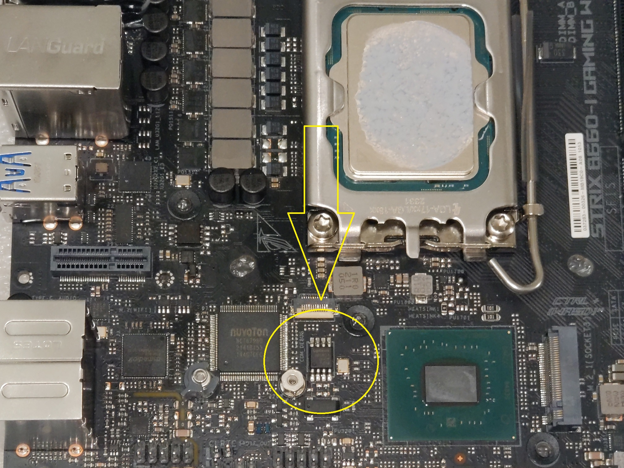

                • greg.chalk
                  • Oct 2022
                  • 10
                  • Greece

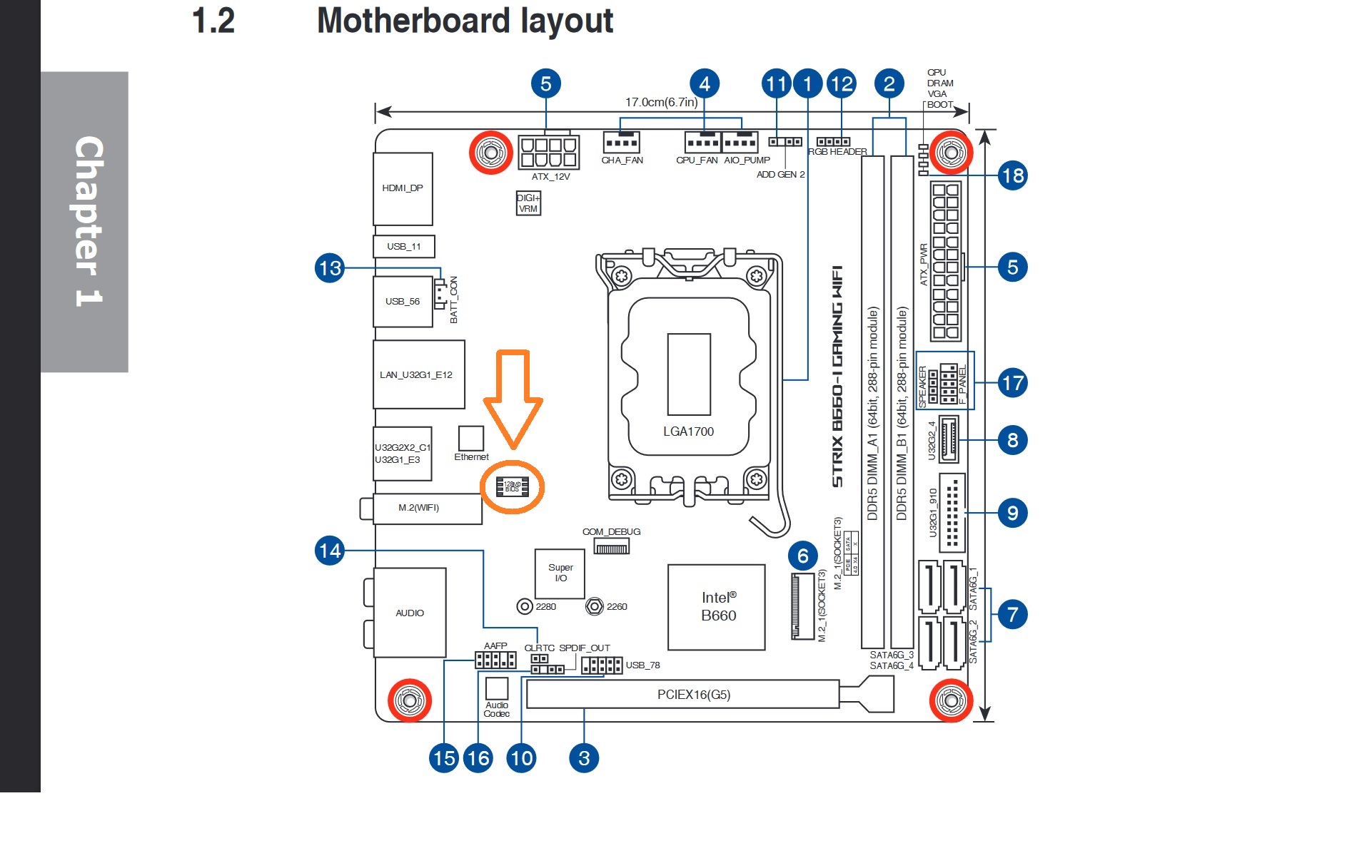

                  Re: Asus strix b660-i itx, bios unlock, FPT Error 167: Protected Range Registers
                  ok, the motherboard layout in manual shows next to wifi slot!

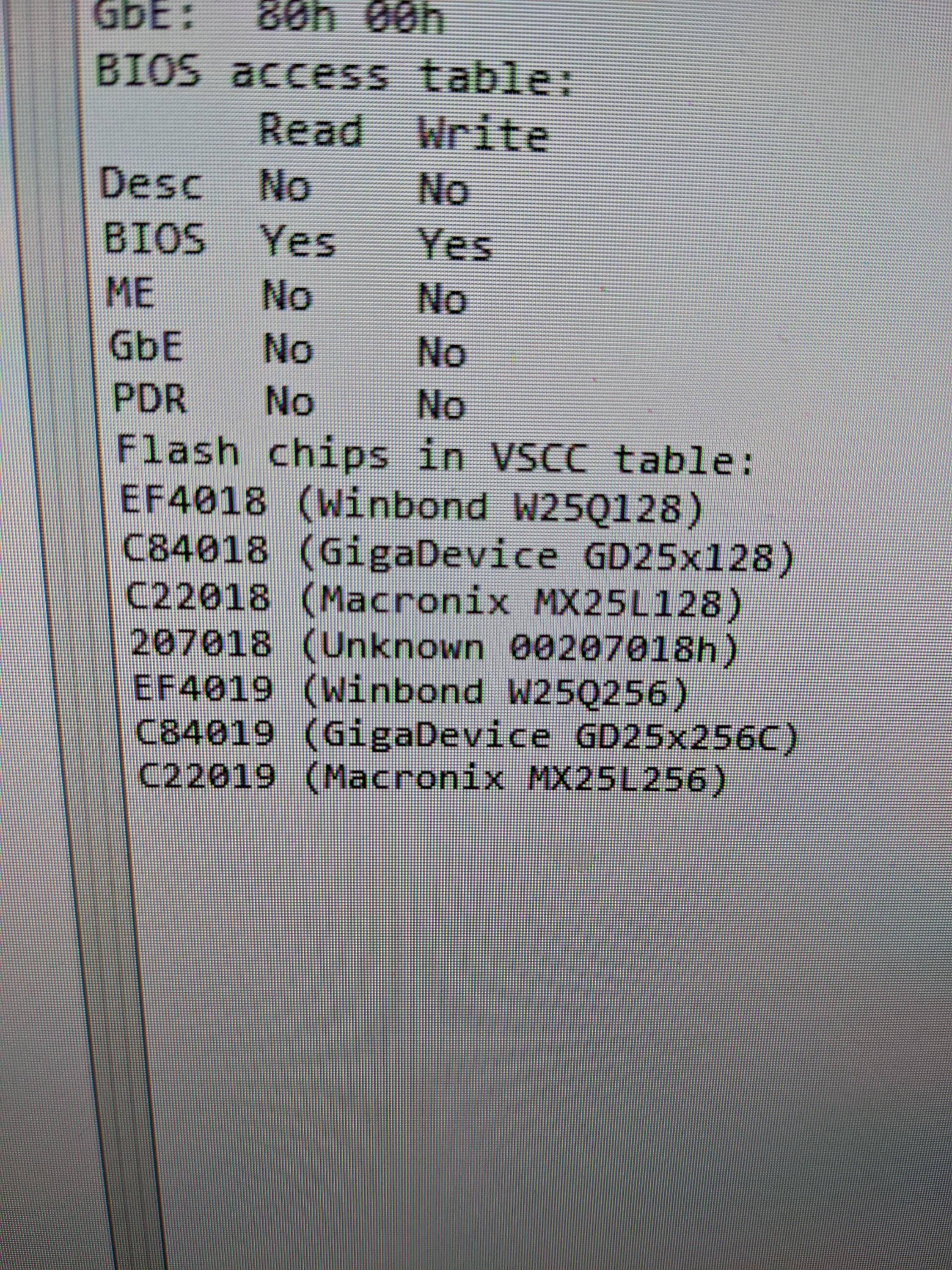

                  After further inspection, this is it? (GigaDevice 25B128ESIG)
                  Is this com debug any usefull?
                  Also this is VSCC table:
                  and the whole motherboard:
                  • greg.chalk
                    • Oct 2022
                    • 10
                    • Greece
                    partial success! (I am almost there!)
                    After much appreciated SMDFleas observation, the correct bios chip is GigaDevice 25B128ESIG (motherboard layout in manual is wrorg!)
                    So I used the ch341a programmer, I made a whole bios dump, I modded it, and I flashed back to motherboard. Succes! All regions in bios are unlocked!
                    but...
                    I still get same error in FPT.
                    Because its not practical every time I want to update bios, to disassembly pc and motherboard, use programmer, and then assembly again,
                    my final goal is to download every new bios, modd it, and then flash it using FPT.
                    I appreciate every help
                    Also, because now I know that I can recover bios with programmer, I can be more aggressive when I experiment with bios.

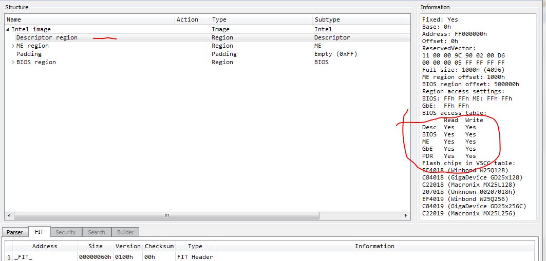

                      Modify the flash descriptor using a hex editor for full read write access then you flash away to your hearts content using FPT . You can check the flash descriptor setting using UEFITool,before and after modding .
                      • greg.chalk
                        • Oct 2022
                        • 10
                        • Greece
                        Thank you for your help!

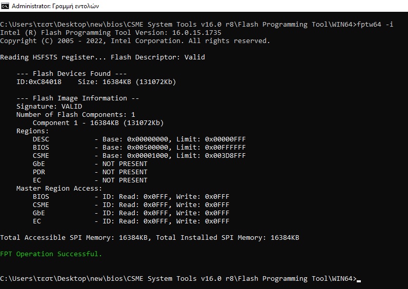

                        I have done that! Descriptor is already unlocked!
                        I get this error with descriptor (and all other regions) unlocked!
                        I am not home right now. I can provide more photos if needed.
                        When I go home, I will make a full dump (not just bios region) with FPT, and I will open it with uefitool so you can see that all regions are unlocked.

                            I will upload fresh full bios(all regions) dump from FPT:
