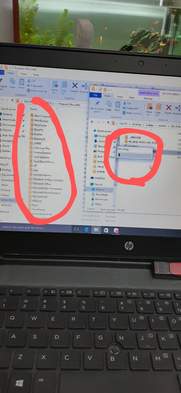

              Re: pls Help me extracting Toshiba BIOS !!!!
              Originally posted by qayyum786
              My Respected Master SMDFlea Has Teach Me That
              and you can learn too from Given Link Below And Thanks To Him
              https://www.badcaps.net/forum/showpo...82&postcount=5
              thanks reply! thanks so much..
              i have try many time , but no successes.
              >> start extracting no see foder C:\ProgramData\Toshiba\BIOS_Package
              i do extract on win10, maybe window 10 not support ?
                • 21981
                Go to Folder Options, tick "Show Hidden Files and Folders"
                  thanks so much!!!!
