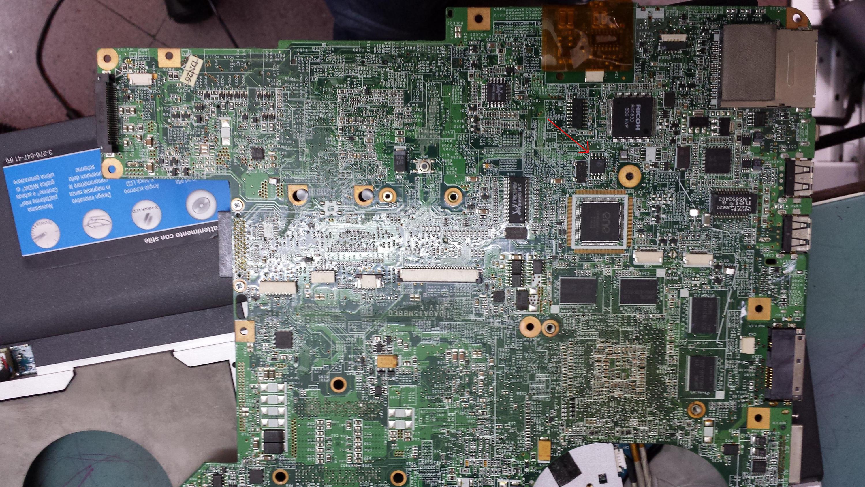

    I am looking for bios location on DV6700 (AMD) or schematic of this motherboard!
    Thanks in advance.
    Thanks in advance.
    here what you are looking for 100% working

      Re: Hp Pavilion DV6700
      Thank you very much, but i do need to locate bios chip on the motherboard!
        here
          Thanks Pragmatico!
          I successfully change it !
            Why replaced? Just need reprogram.
              Yes,i did try with EZP 2010 progg. but it did not recognize chip .
              Well i am not expert for programing also !
              Then i take it from faulty dv9000 motherboard (same bios) and
              put it on!
              Anyway about Spi programmer for bios ! Witch is the best one.
