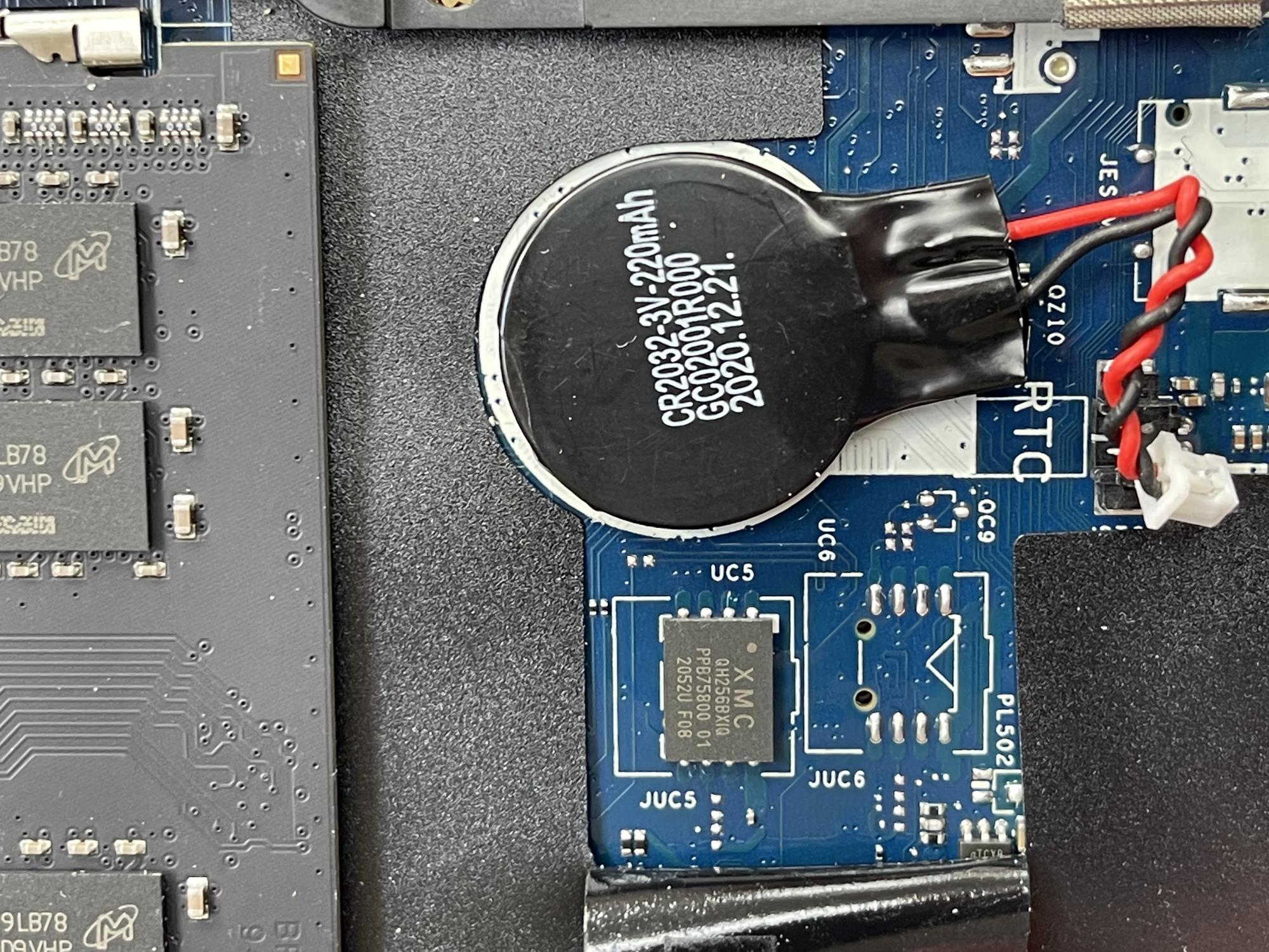

                                        The bios chip by the cmos battery is an xmc qh256bxiq, can I read this with a ch341a programmer? Doesn't seem to recognise it? Tia

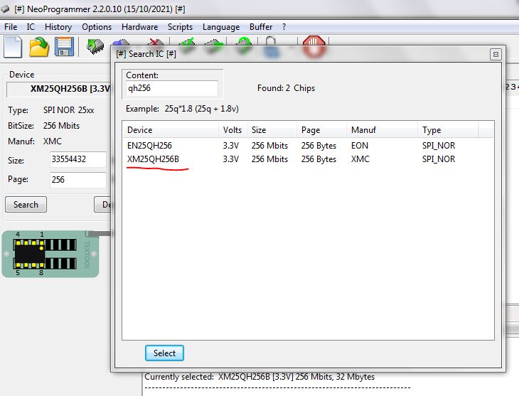

                                          The bios chip by the cmos battery is an xmc qh256bxiq, can I read this with a ch341a programmer? Doesn’t seem to recognise it? Tia
                                          You can read it with NeoProgrammer software,search the forum for it. The chip is WSON8, if you are using a SOP8 clip it will not work,you will have to desolder the chip and use an adapter or try to solder wires to the bit of solder thats sticking out,or you can buy a WSON8 pogo pin test probe https://www.aliexpress.com/item/1005001830846980.html
