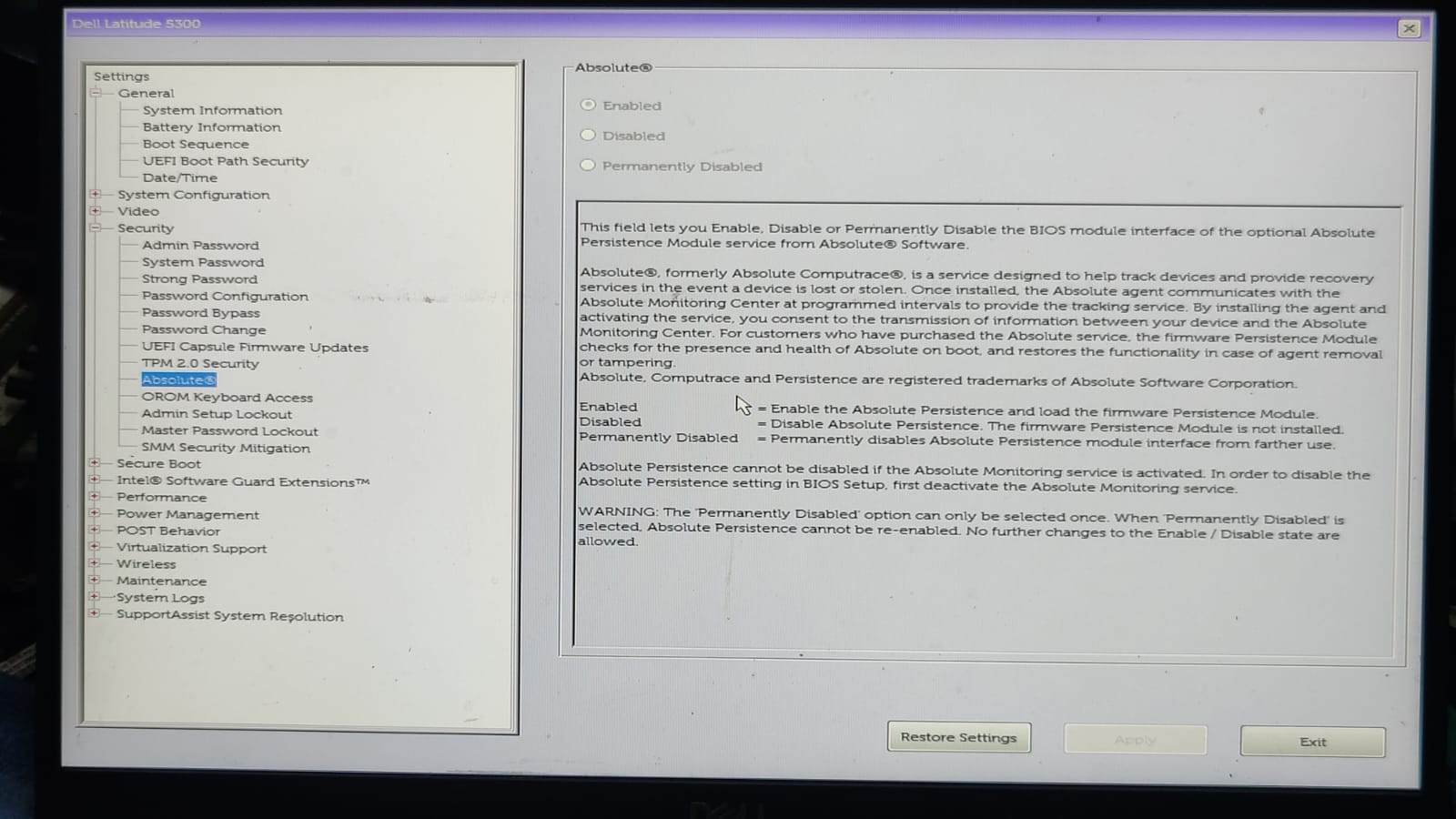

1st boot, press F2, write service tag, disable Absolute, save, restart. 2nd boot press alt+F to exit manufacturing mode.
Working fine
Thank you very much
Hi, how to disable Absolute, its not highlighting please help me to fix it.
Thank you very much
Thank you very much
Try and give feedback

thank you, its working now.
