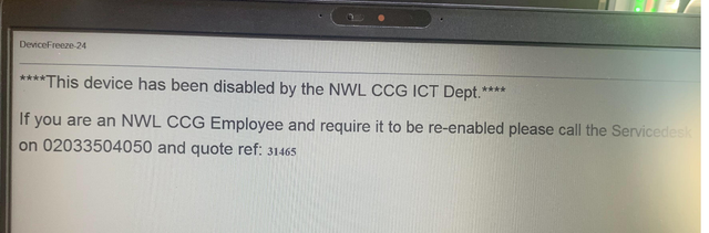

                        #211
                        DELL latitude 5300 BLOCK
                        Good afternoon. There is a DELL latitude 5300 laptop bought in America. After installing Windows 10, the first time you connect to the Internet, the laptop locks up. I was easily able to put the operating system on a new SSD drive, boot up without connecting to the Internet, install all the drivers. But the first time you connect to the Internet, a locking window appears. As I understand it, the blocking is for a certain organization, something like an MDM blocking. Bios without password.
                        How can I get rid of this blockage?

                          #212
                          Re: DELL latitude 5300 BLOCK
                          check in bios if you have Absolute computrace enabled and if you can disable it. If not, post bios dump here, I will help you to disable Computrace.

                            #213
                            n the protection section there is an Absolute item, as I understand it. I can't turn it off. Here is the original dump.

                              #214
                              there should be another bios chipset or your dump is corrupted. Try read it again and compare new read with this one.

                                #215
                                Strange. counted again, no difference found. Here is the second read.
                                And why did you decide that it is not correct or damaged? Is this possible due to the fact that a non-native BIOS was already sewn into the laptop? since the flash drive is already soldered, and when turned on there is a dark screen delay.
                                Flash 25Q128JVSQ

                                  Re: latitude 5300 with password
                                  That laptop was originally owned by the North West London Clinical Commissioning Group, a part of the National Health Service in London, England. What you are seeing is an anti-theft system in operation; Is the laptop stolen property? I would contact Absolute Software who will advise if the device is reported stolen and, as long as it's not, will authorise deactivation of Computrace.
                                  • bykanovm
                                    • Aug 2022
                                    • 98
                                    • Украина
                                    #217
                                    Laptops were bought on Ebay, bought a lot. Here is one of them such protection. I do not think that it was stolen, since several pieces were taken in one place. It is not so easy for us to contact the account from Ukraine.

                                      #218
                                      https://www.absolute.com/customers/support/contact/
                                      https://www.nwlondonicb.nhs.uk/contact-us

                                        #219
                                        Flash 25Q128JVSQ
                                        sturcture of your bios is not ok, it contains only Bios Region. Anyway, try this bios, extracted from bios update.

                                          #220
                                          I would only expect Computrace to be activating like that because it is checking in with Absolute Software and being told that the device *has* been reported as stolen. Otherwise, it would just sit there enabled but inactive.
                                          I think you should be getting back in touch with youe eBay vendor, opening a dispute and asking for a refund.
