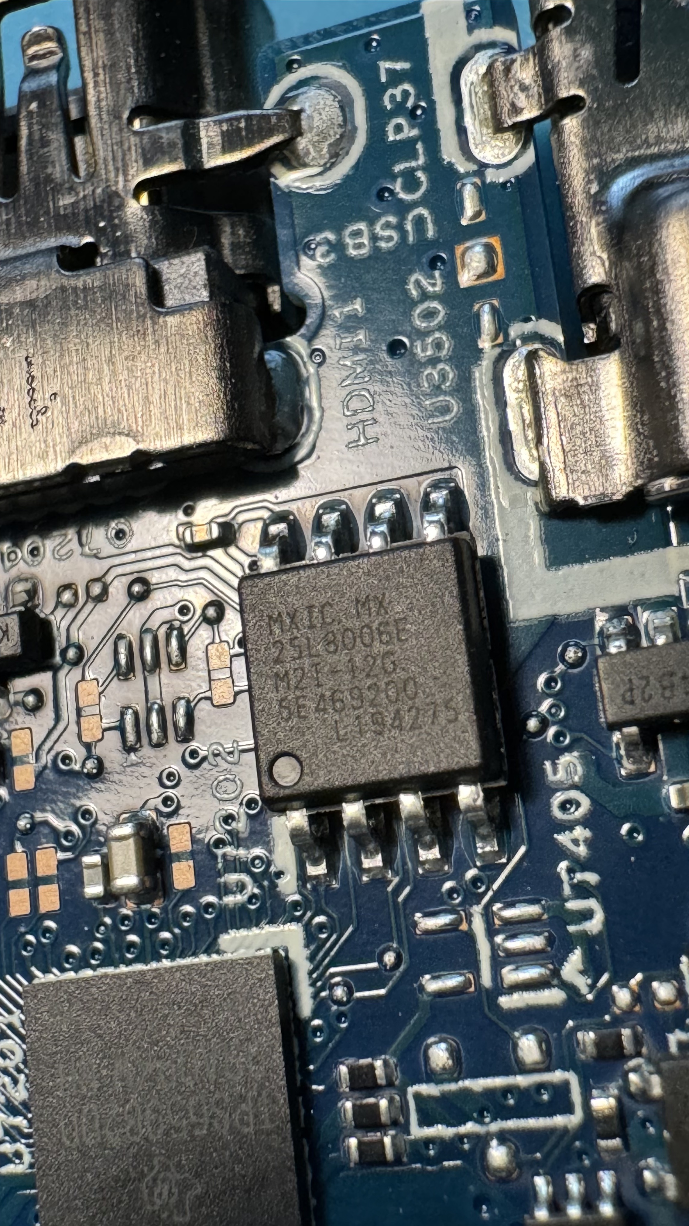

      #303

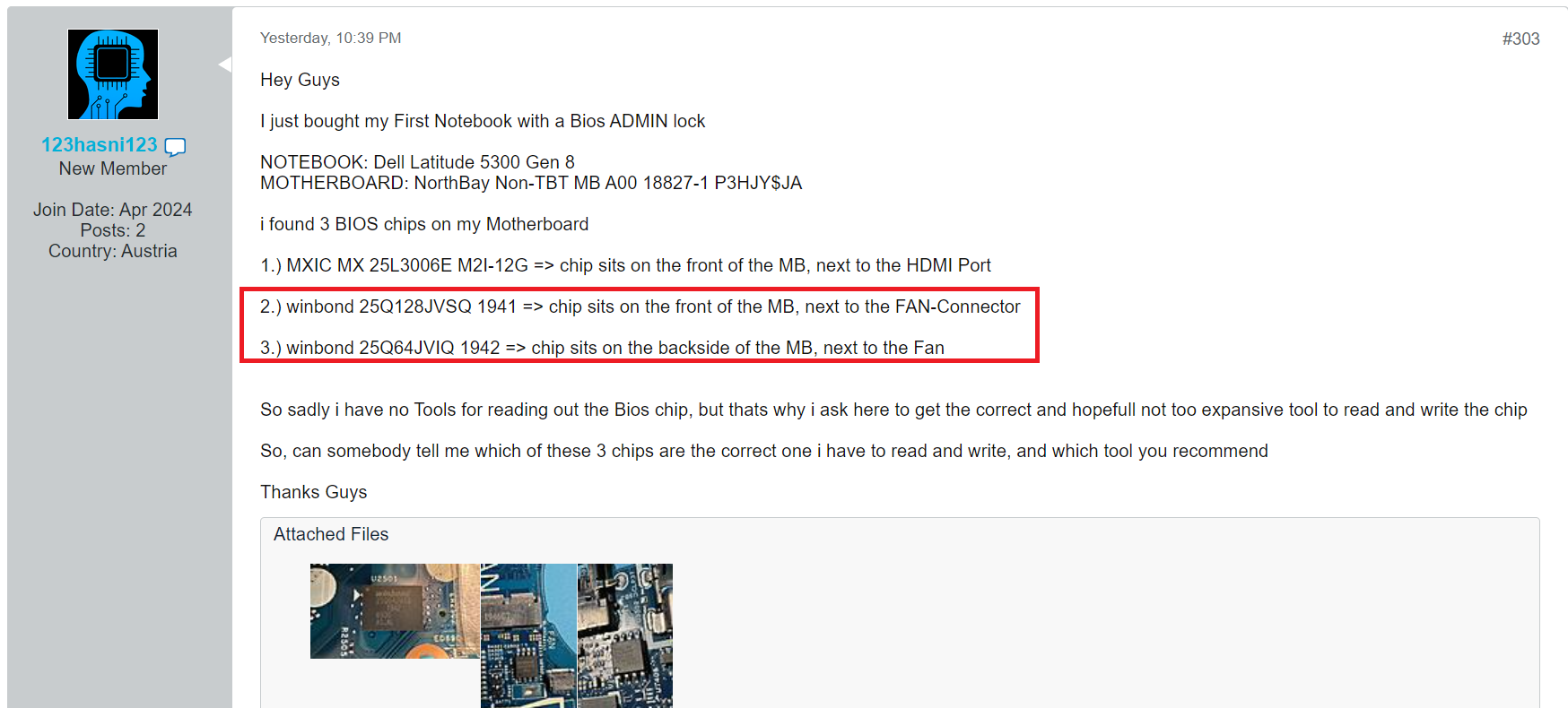

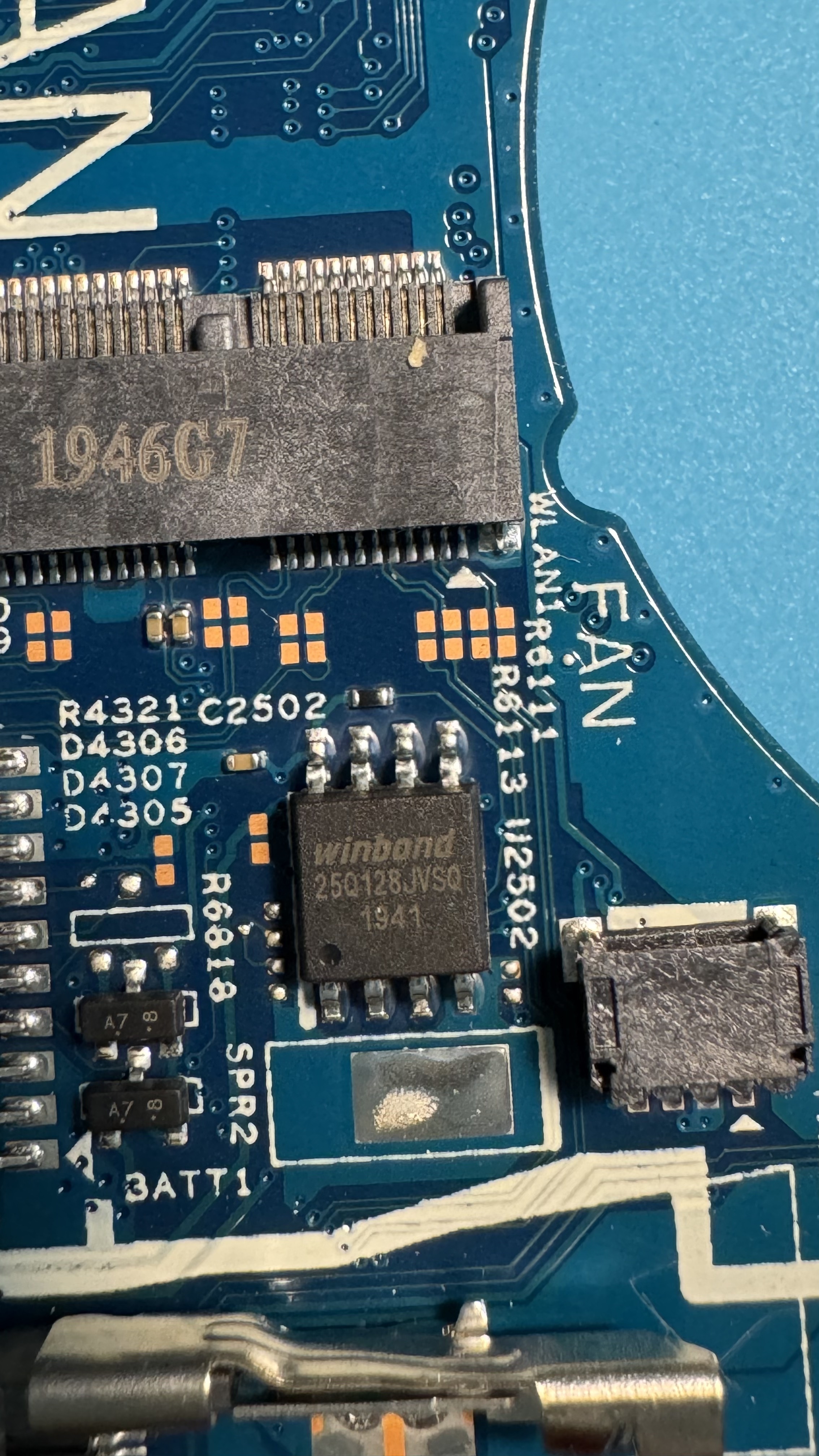

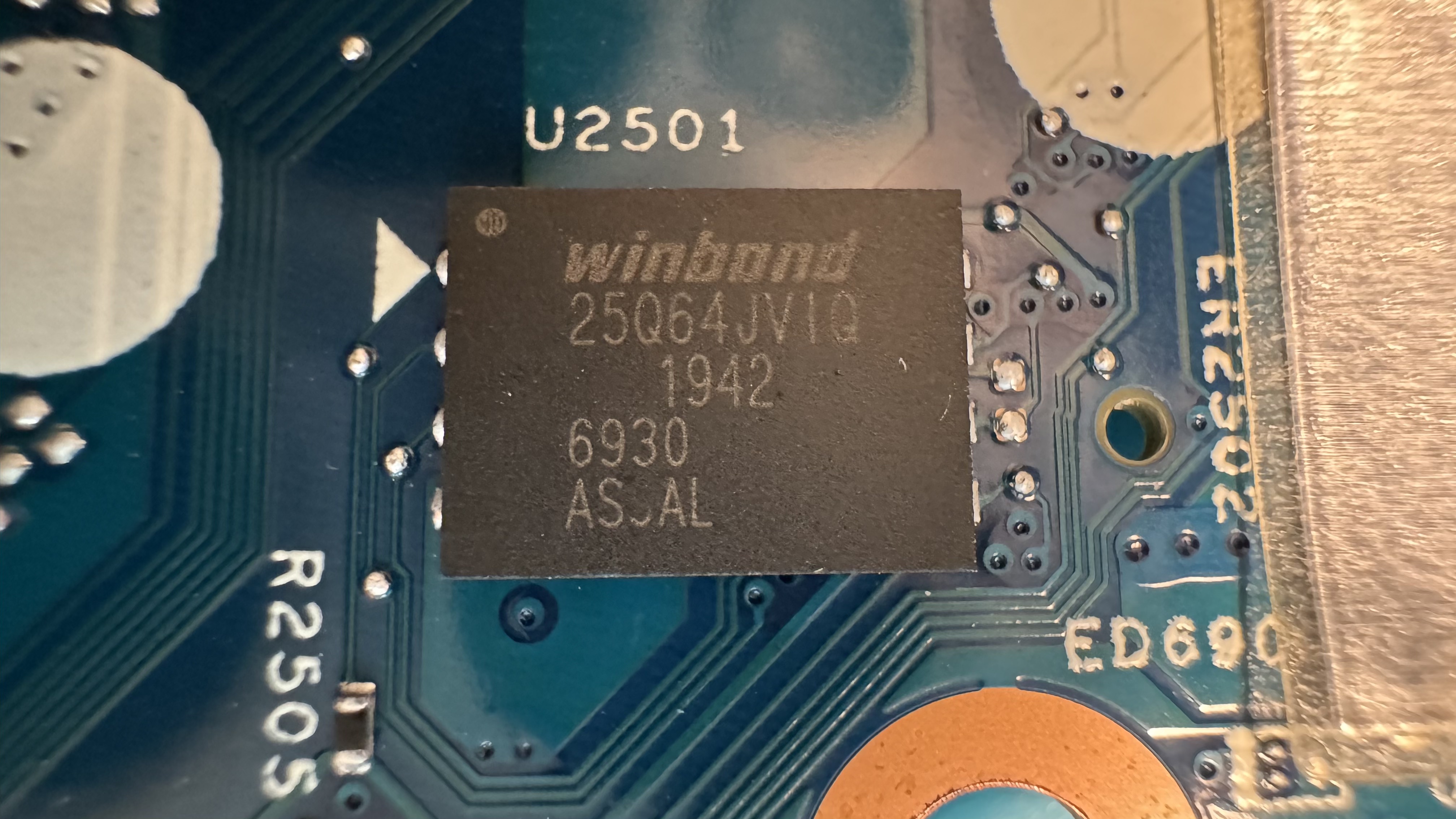

      Hey Guys
      I just bought my First Notebook with a Bios ADMIN lock
      NOTEBOOK: Dell Latitude 5300 Gen 8
      MOTHERBOARD: NorthBay Non-TBT MB A00 18827-1 P3HJY$JA
      i found 3 BIOS chips on my Motherboard
      1.) MXIC MX 25L3006E M2I-12G => chip sits on the front of the MB, next to the HDMI Port
      2.) winbond 25Q128JVSQ 1941 => chip sits on the front of the MB, next to the FAN-Connector
      3.) winbond 25Q64JVIQ 1942 => chip sits on the backside of the MB, next to the Fan
      So sadly i have no Tools for reading out the Bios chip, but thats why i ask here to get the correct and hopefull not too expansive tool to read and write the chip
      So, can somebody tell me which of these 3 chips are the correct one i have to read and write, and which tool you recommend
      Thanks Guys

          #305
          Originally posted by 123hasni123
          Hey Guys
          Thanks Guys

                #308
                hey, thanks for your answer, so you pointed to chip 2 and 3, why 2 chips, are there the same bios on it or what
                would love to do this with chip nr. 2 because this i should be able to read out without desoldering (because of the legs of the chip)
                Your bios file is divided into 2 parts. 8 MB and 16 MB.
                • 123hasni123
                  • Apr 2024
                  • 9
                  • Austria
                  #309
                  ok but why then almost all of the peope only sent in one bios file and not two?
                  and also they get as an respond also only 1 bios file back
                  sorry for my maybe stupid questions,

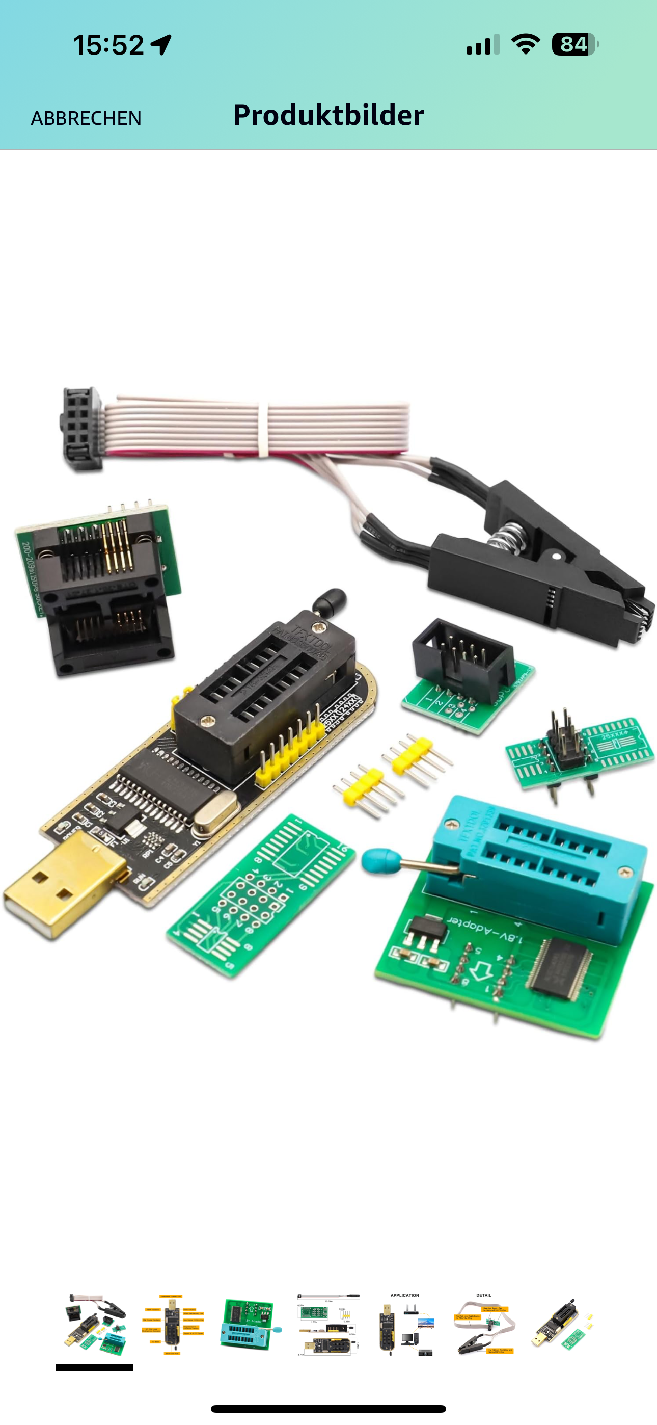

                  i just ordered this bios flashing tools

                      #311
                      If you want to unlock the bios, you can reluctantly use the 8MB file (but it's best to have enough bios_8MB + 16MB files, it helps people unlock faster).

                        #312
                        yeah but the problem is that the WSON8 chip will be much harder to read out and write because of the WSON8 form factor, iam new to this bios soldering things, so i would prefer if anyhow possible to use the
                        chip winbond 25Q128JVSQ 1941 for doing this
                        today i should get my order CH341A with the clamp, but this set wont work easyly on the WSON8 winbond 25Q64JVIQ 1942
                        but would be easy i guess to do on the winbond 25Q128JVSQ 1941 chip because the clamp would work here
                        so thats the reason for asking this
                        thanks

                          do not use clamp or any stupid wires, just remove the chip directly and put in adapter.
                          • 123hasni123
                            • Apr 2024
                            • 9
                            • Austria
                            #314
                            hey guys i did it it worked with my CH341A
                            i desoldered the CHIP on the BACK and also read out the Chip on the Front via Clip (worked perfectly)
                            My Service Tag is
                            F2TBJW2
                            Would be mega nice if someone could sent me the file of the new BIOS which i have to write back to the CHIP.
                            I am so proud of me haha that i managed to desolder this and read out everything like you guys need from me (i hope so ;-).
                            Yeahhh
