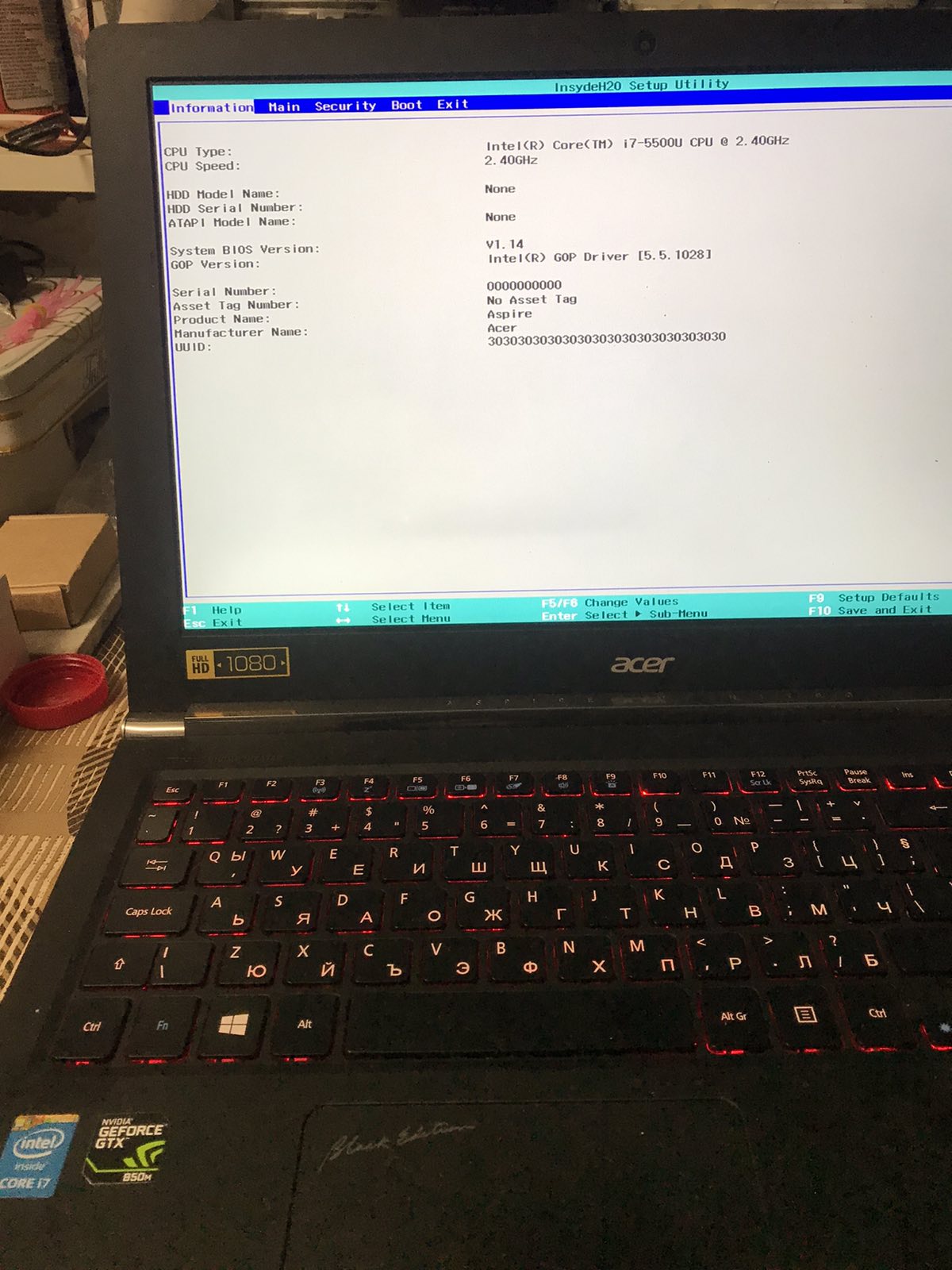

    Hello guys and girls.
    i need dump of bios for Acer Aspire Nitro V5 VN7-571G-76FB
    not working sata controller with corupted bios,
    boot only from usb drive
    serial number is missing in bios, i think someone try to rewrite bios and corupted flash procedure.
    Best wishes

      Re: Bios VN7-571G-76FB (dump needed)
      im not sure because when i receive computer have "not worked" bios, i think it`s not original... will dump it and upload this night
        This is dump from my PC who not detect HDD drives in bios
          bios extracted from the Acer site update..the laptop has two variants of bios..your is HDSB114

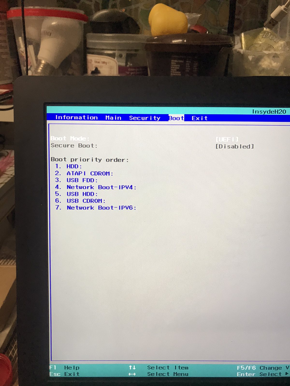

            i try it but not work correct
            computer start with different UUID and product name
            but not found hdd`s i load M.2 nvme and SATA 2.5 and USB drive
              try the HSD114 version if you are not sure that what you posted is original, maybe someone else changed it ... the DMI information must be written, but in the original bios they were deleted, so we have nothing to transfer, DMI region 240000-2400FF, you will have to write the information manually, according to the stickers on the laptop, in the HxD program.
