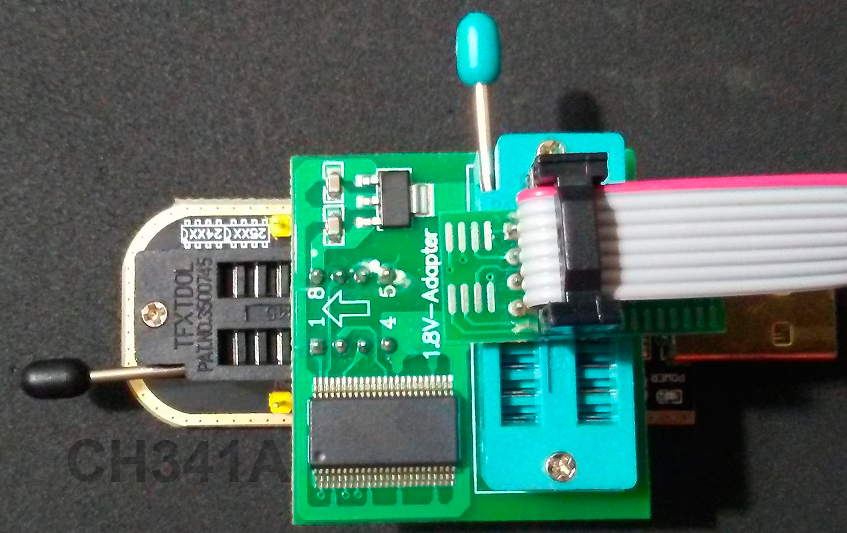

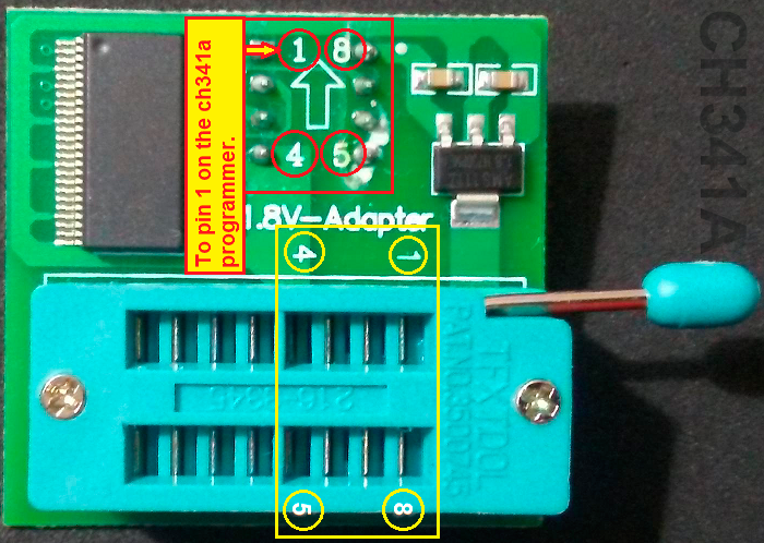

    I may know where your problem is by looking at pictures.
    I've had a few programmers, PIN-1 on programmer ZIF socket is the one closest to LEVER, but in CH341A programmer there are some variants for PIN1 location depending on the chip you want to program (24Cxx eeprom or 25xx spi chip). When you want to program an SPI chip, PIN1 is located 4 rows below (on pin5), and have also seen PIN1 is located on the opposite corner from where the chip release lever is located.
    You already have this part working...
    The problem seems to be located in 1.8V adapter, the PIN1 is the one located closest to chip release lever, so just relocate adapter with ribbon cable four rows of pins above (next to lever).
    Take a look at this picture:
    The CH341A programmer with 1.8V adapter and the ribbon cable attached with SOP8 clip must look like this setup:
    I've taken the pictures from this other forum post (a very nice guide to CH341A programmer):

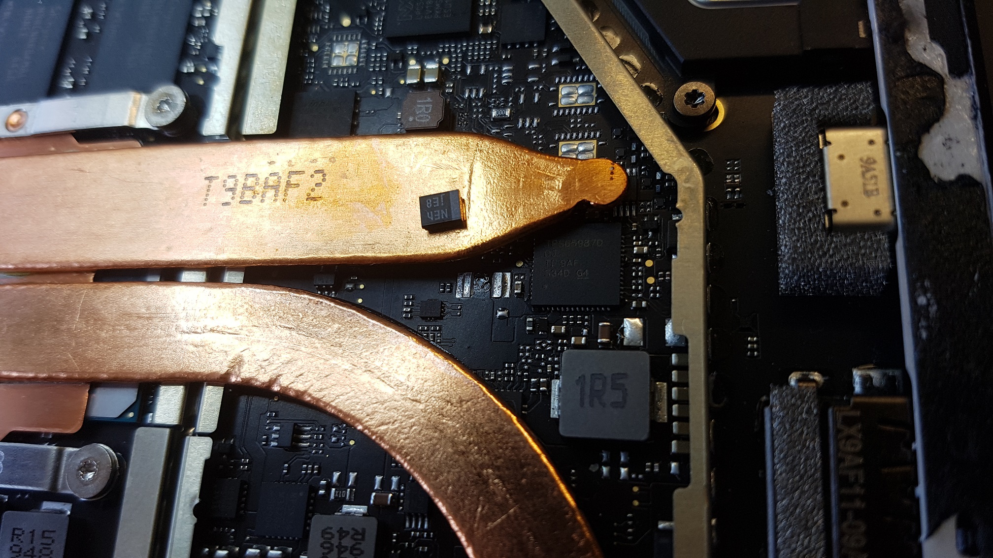

                Microsoft Surface Pro 7 1866 BIOS request
                Hello
                Got a 1866 that turns on, windows logo, and off.
                Would like to reprogram bios.
                Anyone has a clean dump for this device?
                Appreciate it.
                Cheers!

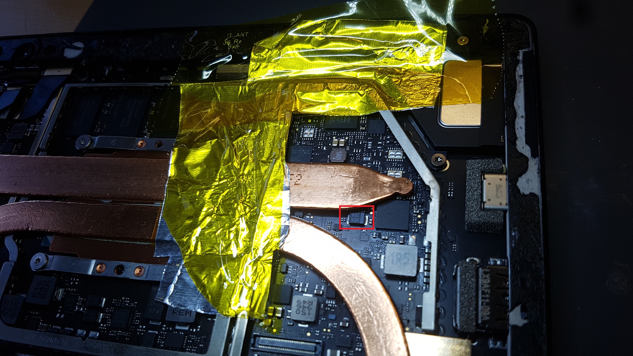

                      Poked around with multimeter, and found a shorted rail.
                      Tried my luck without screen connected and with thermal cam, found a cap heating up. removed it, and it was indeed shorted!
                      And guess what, surface turns on, and I got BIOS screen with Peste dump.
                      Now, I would like to keep the serial number and original dump.
                      Flashed both dumps I posted here, none of them work
                      Can someone help me inserting SN on Peste's working dump?
                      Or fix one of these files I uploaded?
                      SN of the device is 041644201153
                      Also, to replace this cap I must get the exact same one with same print?
                      NEh
                      jE8
                      Thanks for all the help!

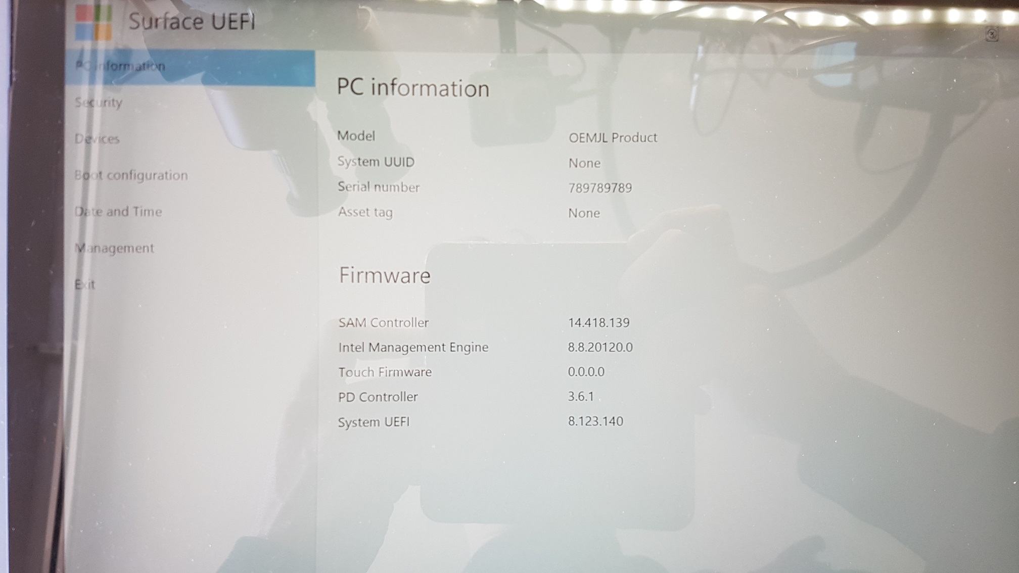

                            Still not working, Device turns on , surface logo for 30 secs, goes off, and same thing again in a loop. nothing else happens
                            Also, with @peste Dump, touch does not work. I have Touch firmware 0.0.0.0 in UEFI screen (check 2nd photo on post #30).
                            What I cant understand is why the backups ive done neither work...very weird never had this problem before.

                                      Well if I flash Peste bios, it works as you can see in the pics
                                      just no touch and serial is wrong
