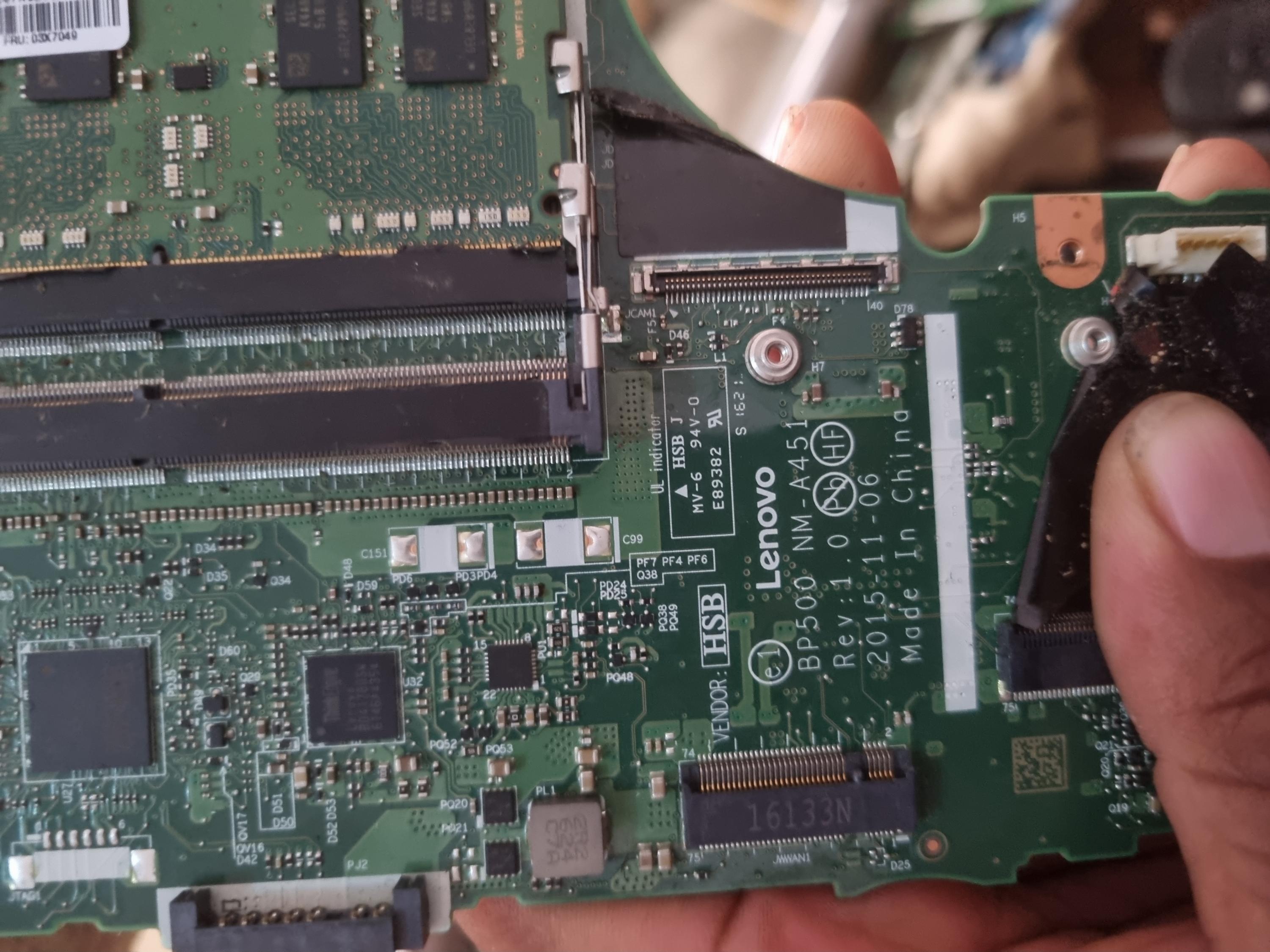

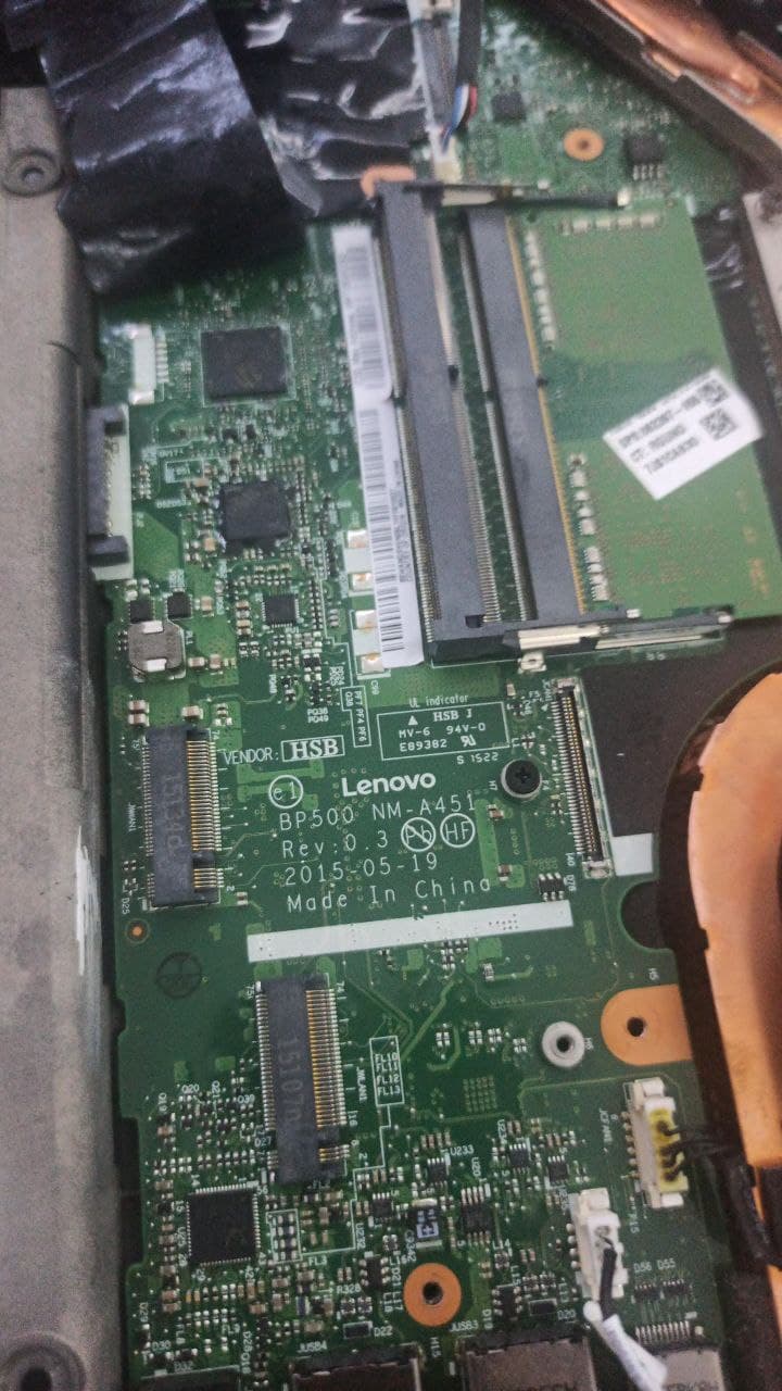

                  Lenovo p50 bp500 nm-a451 ec request
                  Hello guys
                  I'm looking for Lenovo BP500 NM-A451 REV 1.0 Ec bin file please 🙏🏾
                  I'll really appreciate, I have the main bios file attached I'll appreciate if someone would extract the EC file for me
                  Last edited by SMDFlea; 08-04-2022, 03:09 AM. Reason: Bios removed,already posted once.........

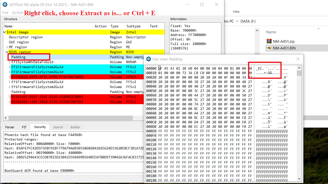

                  • hoaca388
                    Badcaps
                    • Jan 2022
                    • 11878
                    Re: lenovo thinkpad P50
                    Originally posted by mnciks11
                    Can I get the Ec bin file from this bios, I have the machine with cleaned Me region but I need the ec please I corrupted my original one and I don't have the bios please
                    Yes, you can. See the picture.

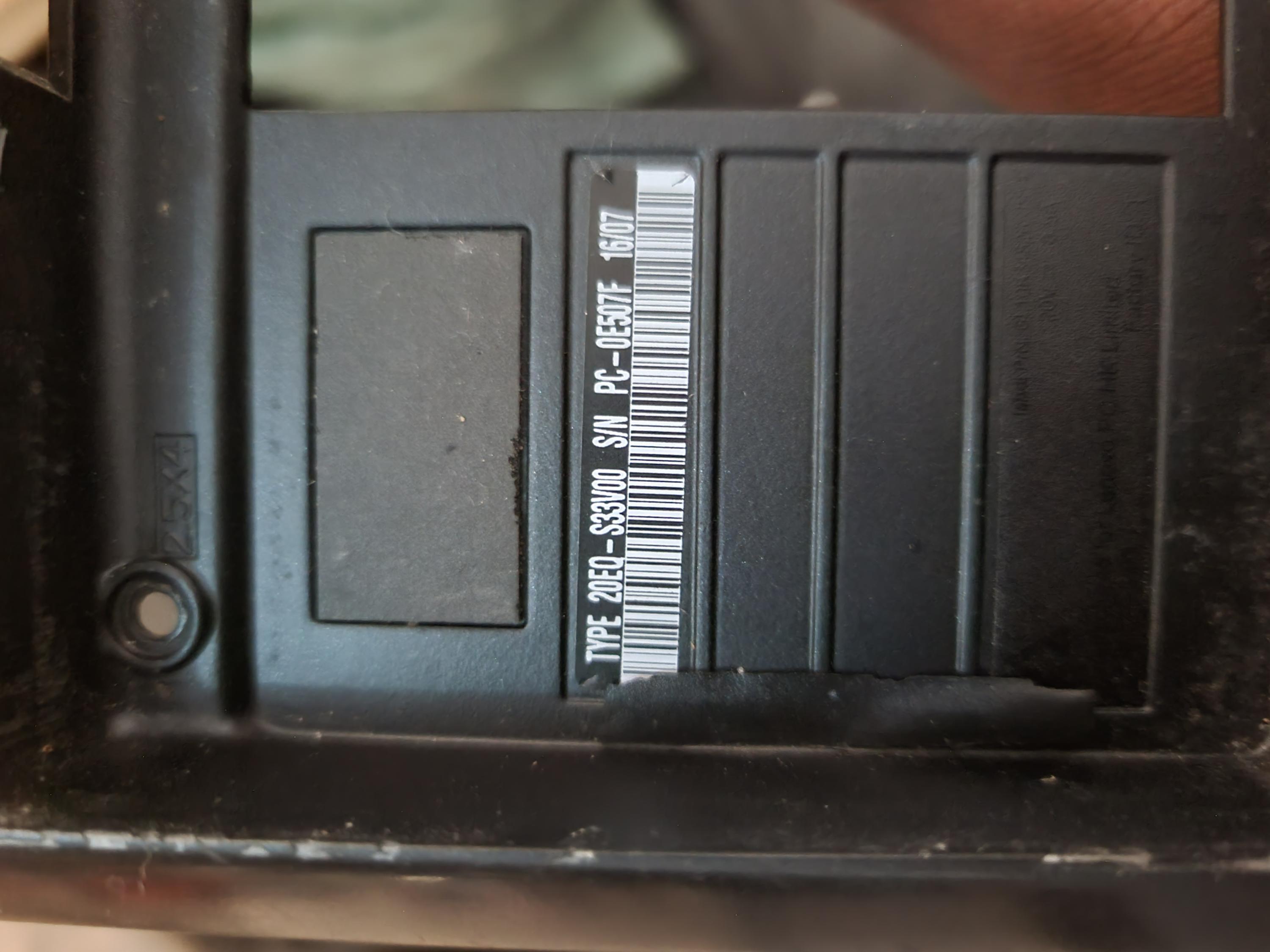

                      Hello Forum, i have this machine:
                      Lenovo P50 TYPE 20EQ-S1PN00 S/N PC-0QWK7X
                      MB BP500 NM-A451 REV 1.0
                      The problem is that the display won't turn on and I think it's a bios problem.
                      Not even an external monitor.
                      The problem appeared after I modified some "graphic adapter settings" in the bios menu. Please, can you give me some help?
                      This is my original dump
