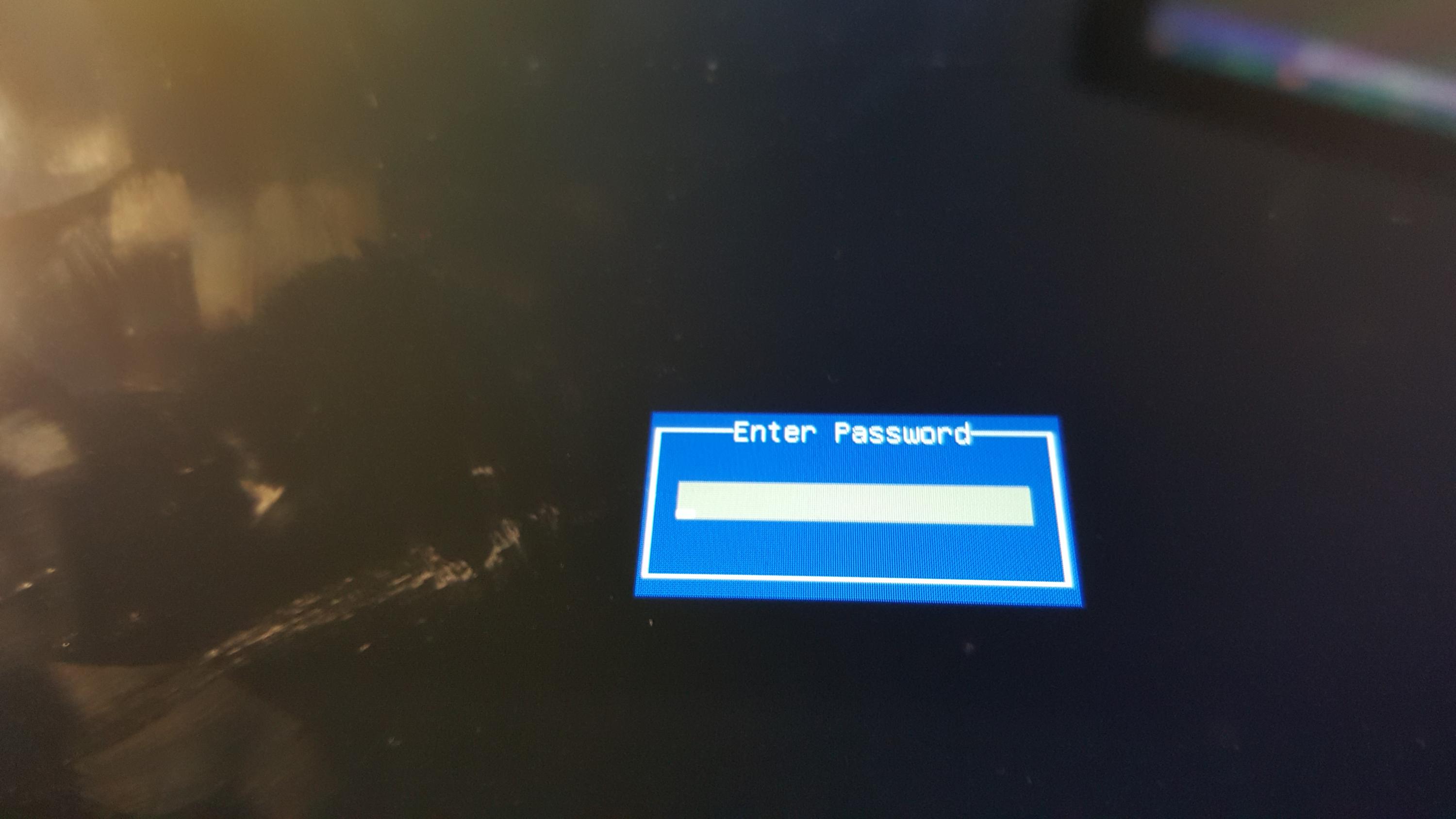

    I have bought a cheap 11.6 tablet(SurfTab twin wifi) made by firma TREKStore gmbh Germany,with windows 10 from ebay.But booting it asking a pswd.So I cannot use the thing.I have a CH341A programmer and I thought I can reflash clean bios but cannot find any update for this model.The spi chip is Winbond W25Q64FW,I de-soldered it and read data with the programmer.Can someone help me to clean the pswd from bios?

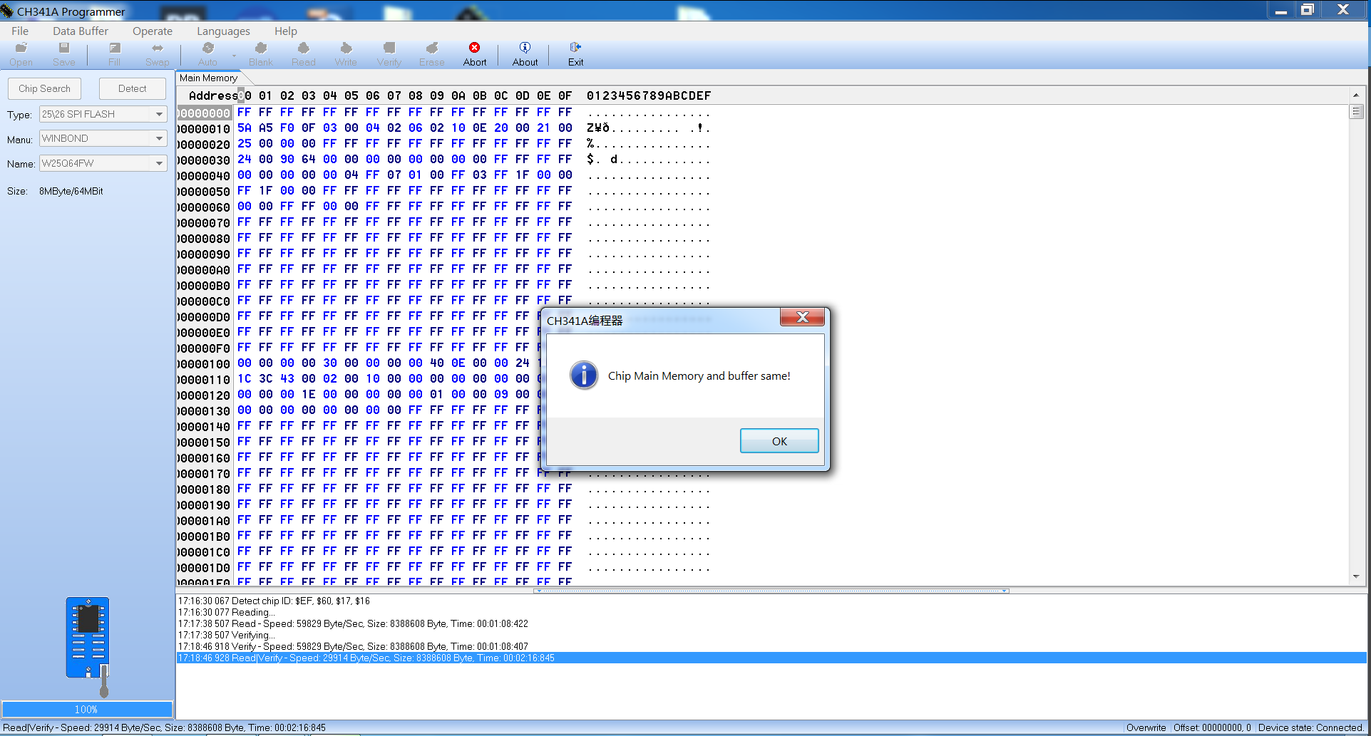

    Your backup is incomplete. Use AsProgrammer software instead,you`ll find it in the forum. The W25Q64FW is 1.8V

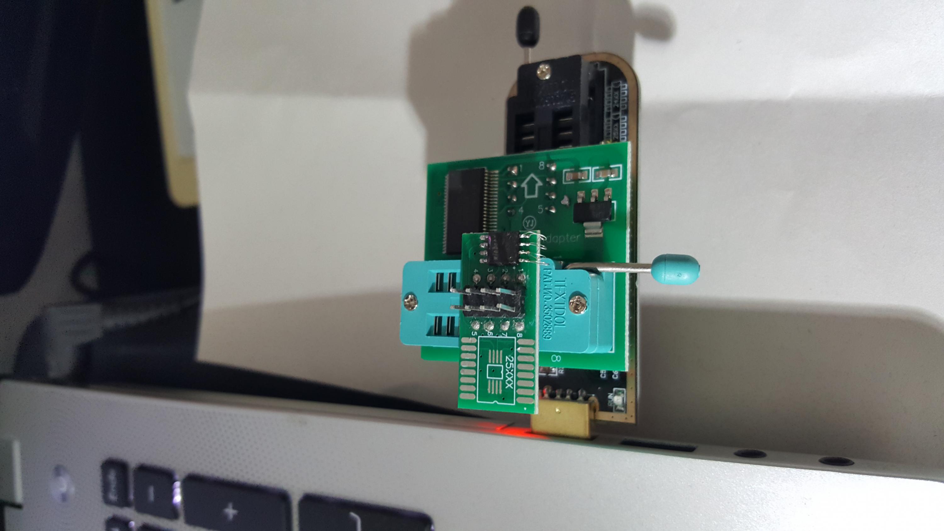

      I will try with as.The software version used is ch341a programmer 1.30 and is saying after reading "Chip Main Memory and buffer same!" as can be seen in picture.Does looks ok or? And yes you´re right,it´s 1.8v chip;before testing I´ve read the datasheet and chip is attached via 1.8v adapter.I will be back soon with the result from asprogrammer.

        You were right.The size of the dump with asprg 1.41 is 8mb!Here is the dump.Please take a look when you have time.

                Strange is that I have not found a way to type the password,while the tab has some sort of keyboard that doesn't work and attaching a keyboard via usb doesn't work either.I have thought if no password required will directly boot into windows.At this point I have no clue how to sort this...Maybe some other people from the forum can come with some ideas?I suspect some settings in BIOS were deactivated...

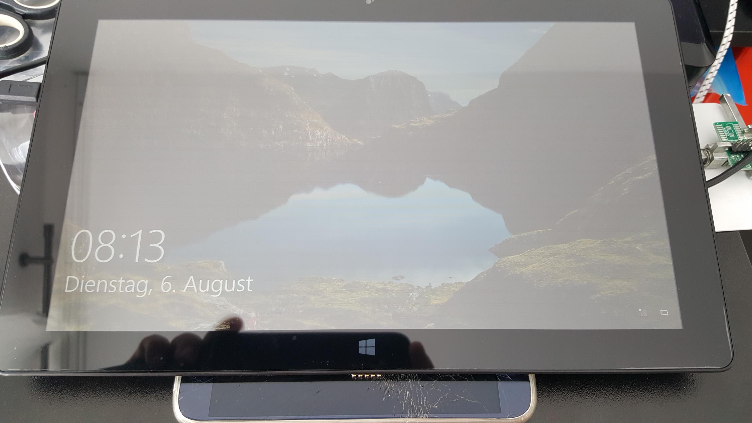

                          Re: SurfTab Twin 11.6
                          The taste of victory is sweeeeeeet!!!
                          With the last mod tablet is starting!!! you rock guys!
                          Thank you!
                          I take my hat off !!!Really appreciate your time and effort for helping me!
