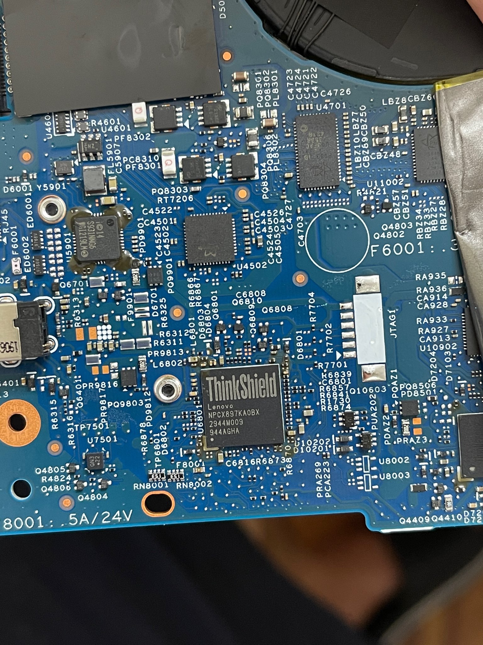

                                        How to read Mec MPCX897KA0BX on Lenovo P1 and P53 Sir?
