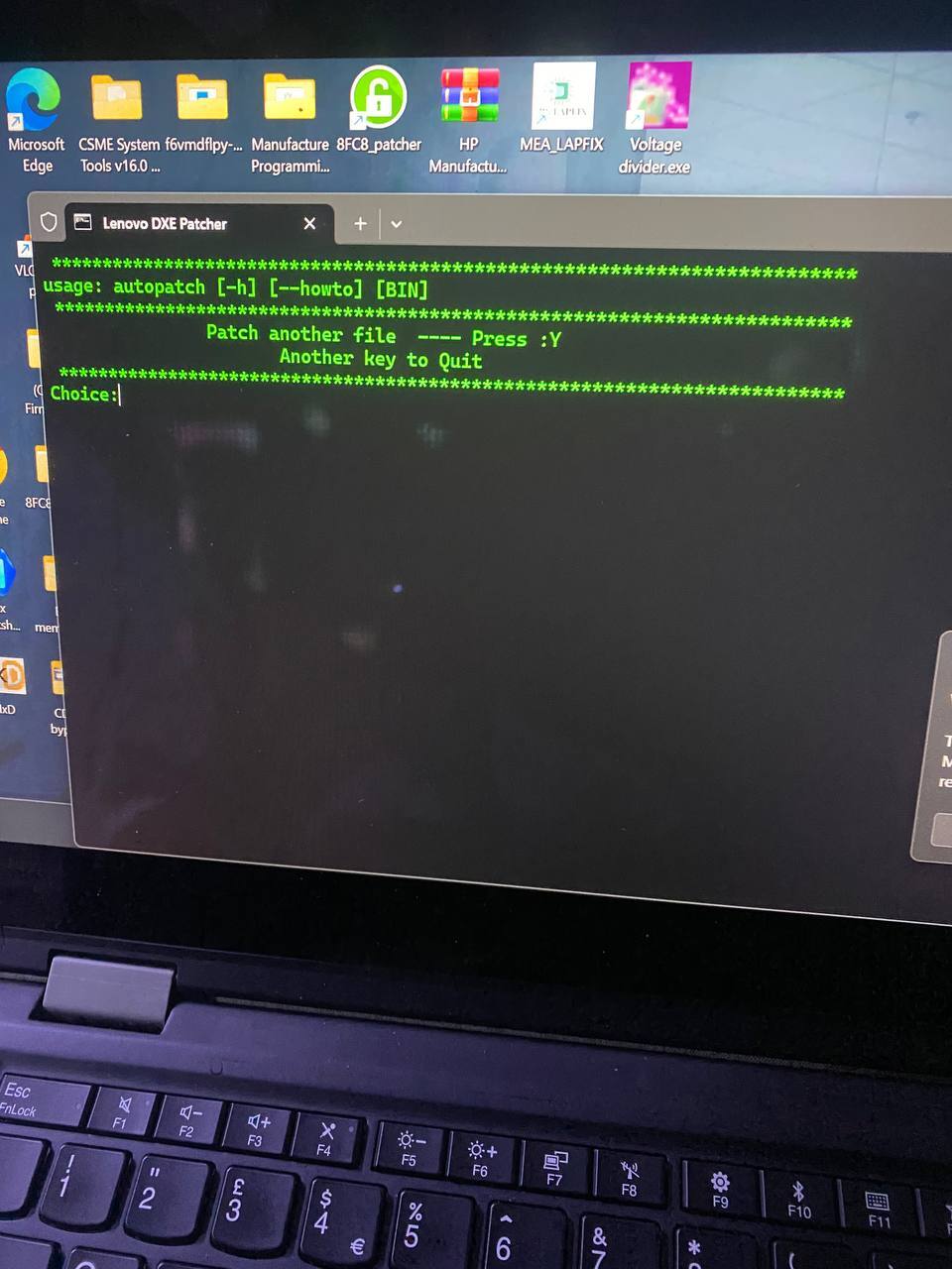

                                I was trying to download the autopatcher but it said invalid, what happened?
                                *Edit: nvm, it's working after I wrote this reply.

                                  My lenovo dxe software not working please need help
                                  • alito666
                                    • Jul 2025
                                    • 32
                                    • mexico
                                    #4137
                                    upload yours dxe files
                                    • Blaze Tech
                                      Learner
                                      • 217
                                      • Ghana
                                      #4138
                                      you mean the file i want to patch
